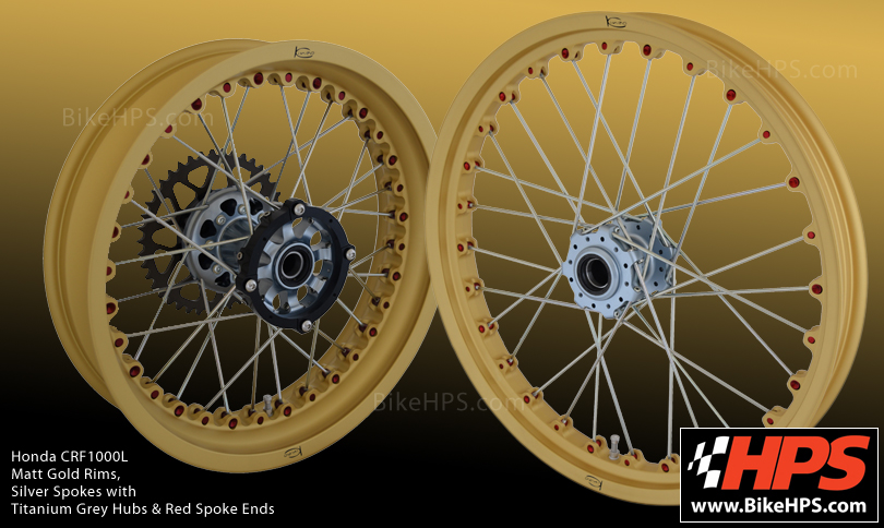

Dear Cutter,
Most of our customers have been converting all they're on road\off road adventure Bikes to KINEO or Kineo style Wheels. They seem to be functional and easily tuenable to convert all Tubed tires of bike adventure bikes to Tubeless.
I think I have a picture.
Best of Luck!
