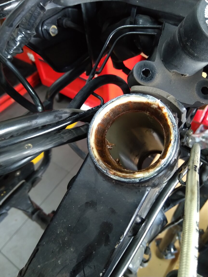

Some additional info. I think I found the issue already. Just got it up on a stand and when moving the steering bar from left to right it seems it's not moving freely, as if it needs to go over a little threshold all the time. In other words, I guess the steering head bearings are shot. This is quick after 10K km. I remember itchyboots had to change hers about 3 times in 36K km going from india to europe.

haha yeah I'm good at answering my own questions. Or perhaps too soon with asking for advice?!? Did a bit of searching and apparently it's a design fault from RE. The steering head bearing cover is designed in a way that the seal doesn't stop any water from coming in even if you're not using a pressure washer to clean the bike.

Called with RE today. Talked to the mechanic today and I can only have it fixed next week. There goes my weekend trip we had scheduled. Then he said it's a recurring problem that needs to be addressed every 5-10K km. This means that every 5K you'll be adding 2,500 thb to the regular service bill for a set of head bearings. Not sure what to think of it but it sort of corresponds with my own experience. The popping noise in the steering head bearing started occurring around 5K and the bike become difficult to handle around 9K. RE says they have no way to fix this due a design fault. The BS6 model has apparently addressed this issue. Interceptor models seem to have a similar problem.

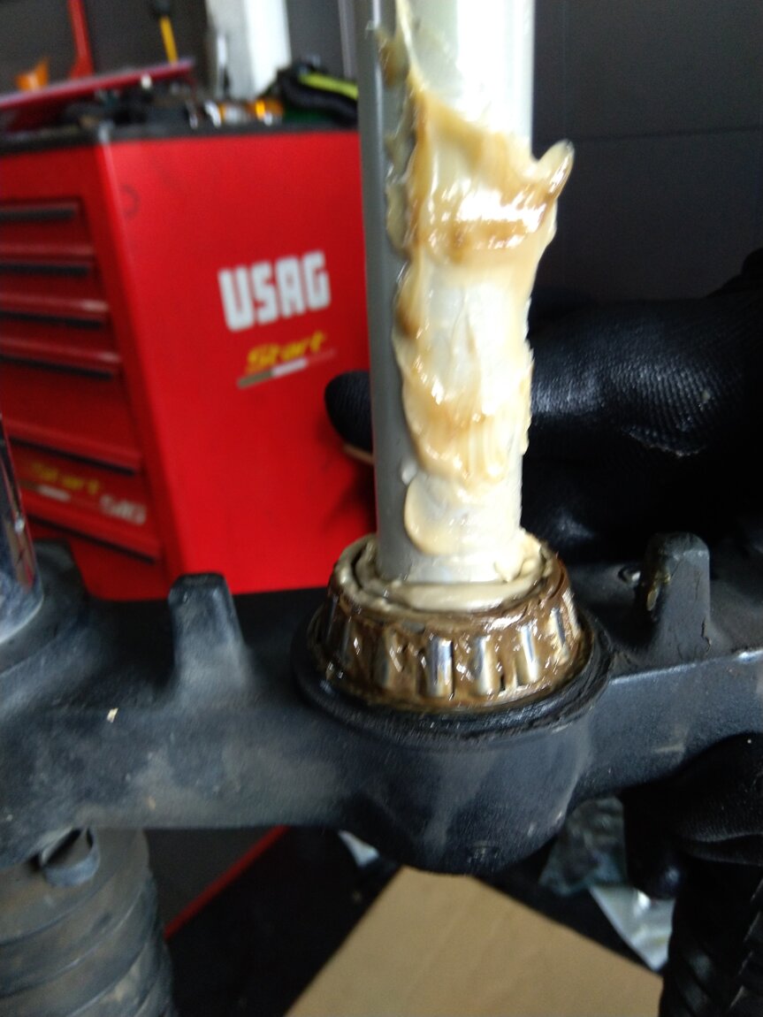

Is it a captive ball bearing ? No machined race ?
If me, I would measure the inside of the steering neck, outside of the steering stem.
Check with SKF - bet they have a pair of tapered roller bearings and races to fit in the size you need.
If they have the OD correct but the steering stem is too large, quick trip to a machine shop, chuck the stem in a lathe, machine to size.
Then just sort out a seal - not hard as all it has to do is keep splash and rain out.
Good to go.

Thanks for the tip. I'll have to look into it. They are tapered roller bearings. I am not quite sure where the water gets. I'll have to do some more reading on the issue. Time is a bit of a problem for me. I'm working full time and leaving for work abroad next month again.

I had to machine my old Bullet to a tapered roller with race, as Canthai suggests. I used a 1" Timken Harley bearing I had lying about, and machined the bottom of the stem to fit. If the new Enfields have tapered rollers, buy a quality bearing with race, and see if you can get a better seal. Most bikes do not have a great seal, so keep the pressure washer away, and use waterproof wheel bearing grease.
Done and adjusted properly it should last a lot longer than 9000 km

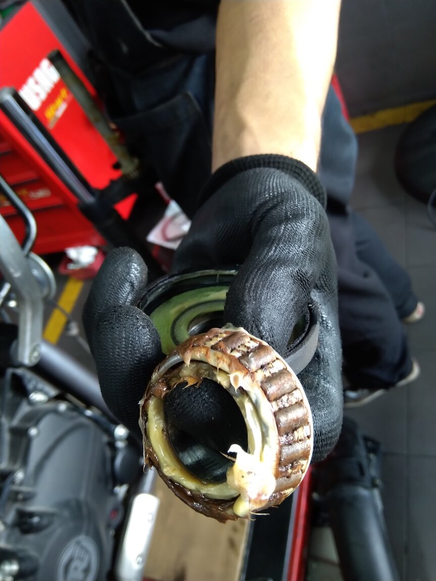

I'm at RE now. There was another branch in Bangkok (Praram 5 owned by Motoholic) that called me back and said they had time today to service the bike. I talked to the head mechanic and he said RE does not have a solution for it. A combination of factors is at play, bad design, RE unwilling to do a recall and address the issue, probably poor lubrication from the factory/assembly line and low quality standard bearings. RE seems to just approach it as normal wear and tear. So I asked if they had any better aftermarket bearings but they didn't. So I've decided to just change it for now and in the meanwhile carefully look at the suggestions that everyone has given here. The interceptor apparently has exactly the same problem with poor lubrication from the factory.
I'm happy they were able to help me out today. The Praram 5 branch on Chaiyaphruek road is cheaper and better than Thong lor. I was quoted half the price in labor than at Thong Lor. At Thong Lor they really don't like it when you walk around and have a look at the bike while they're working on it. Here there's just a big glass wall dividing the showroom from the service area and you can just sit and watch your bike. The 5,000 service the last time was done very well and they work very precise. They have had the same crew working there for a few years now.
I guess it is what it is for now.

We looked at the package and it just said Royal Enfield, no other brands were named on the pack or the bearing itself.

You simply need the bearing number then you could buy any manufacturer. The only benefit from a bearing perspective is that the cage could be stainless but the frame still won't be.

Replacing it with the same problematic bearing is not a solution but luckily bearings are made to common standard sizes. Every bearing has a number on both the bearing and race - very odd that this one did not?
Perhaps a Dealer is not allowed to use non RE parts?
Pity that you did not measure it, then it would be a simple matter of sourcing a quality SKF, Timken, etc. Sounds like that I will be doing this in the near future...............
Looks like the same grease they slathered all over the relay connections - odd that they had no problem using a shitload there to cause problems, but could not get enough on an important bearing
If you have not cleaned this out of your bike yet, so do, and replace all the relays with quality Desno ones. The grease and crappy relays are a known problem
Every bearing on my old Bullet was a problem due to Indian domestic market quality and I replaced every one of them. I would have thought that RE would be using something a lot better when selling to the world.

RE at praram5 did a great job cleaning it all up and replacing all the bearings making sure not to make a mess out of it this time.

No need to buy a common bearing from India. If the 30205 bearing shown is the correct one then an international spec part from NTN, SKF, Timken etc
dimensions are 25 x 52 x 16.25mm
Item # 30205, Tapered Roller Set - Metric Series On NTN Bearing Corp. of America
SKF
Any decent bearing shop will have this or can get it, and cheap as chips. Some waterproof wheel bearing grease, and a poly washer and you are good to go with a DYI solution that should not fail in 9000 km

The set that you can order from india through the art of motorcycle for the himalayan is a set of NTN bearings including waterproof grease and a nylon cap.
