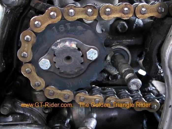

Fix what?
The front sprocket.
It wears the spline on the counter shaft & starts to "wobble along the shaft."
A surprise; but it should not be.
This is the 3rd time round @ 320,000 kms.
The first two times 100,000 kms apart & # 3 is 92,000 kms.
Eventually you need to replace the counter shaft & that is the very last piece to come out of the motor when you strip it down = ouch!
And "laugh" the gasket kit costs more than the shaft.
As I'm off to Laos I need a quick fix for 1,500- 2,000 ms.
let's try welding the locking plate on.

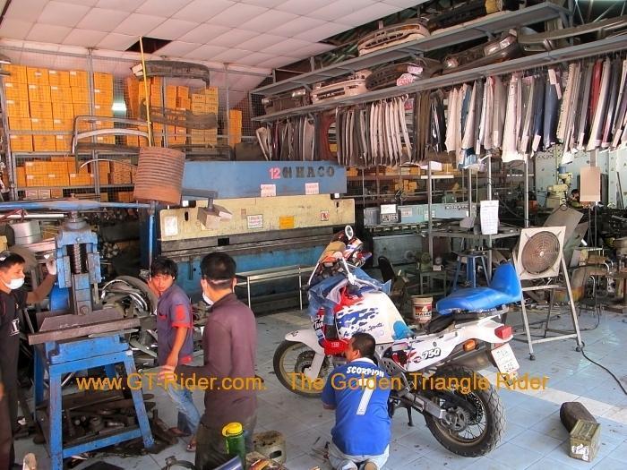

Price 350 baht at Somchit's Daeng Glon Pratu
Will it work? Yes, if done properly, I hope.
The next week or two will tell.

Schackster, nope the idea was "mine" something I once tried 230,000 kms ago the first time the sprocket ate out the spline, but it was not a very good weld & only lasted a few hundred kms.
This one looks good & is a much more professional shop.

Why is it not a 100% weld?
Ian has a valid comment.
I would have had him use a TIG welder turned up high on pulse mode. First weld the high point of the tooth to the plate, alternating to diagonally opposed teeth, and allowing cool down between each weld. Do not cool down with water but allow it to air cool.
Then fill in the root of the spline, using the same alternating pattern and cool down procedure. This takes time due to the cool down procedure, but if you want it done right........
Might as well tack the bolts to the plate while you are at it
Do it right now as there will not be a second chance at this. You may want to think of taking it back for more welding
Hoghead;279185 wrote: Why is it not a 100% weld?
I know nothing about the technical aspects of welding, but one consideration might be that when the sprocket is worn out you'll want to be able to remove it and install a new one without destroying the shaft? Just guessing mind you :)
It would have been a good time for new sprockets and chain before making the front sprocket a permanent part of the output shaft.
I understand from David that this is a temporary fix so that he can go to Laos next week. I bet it will be temporary until it breaks or needs a new sprocket
