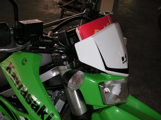

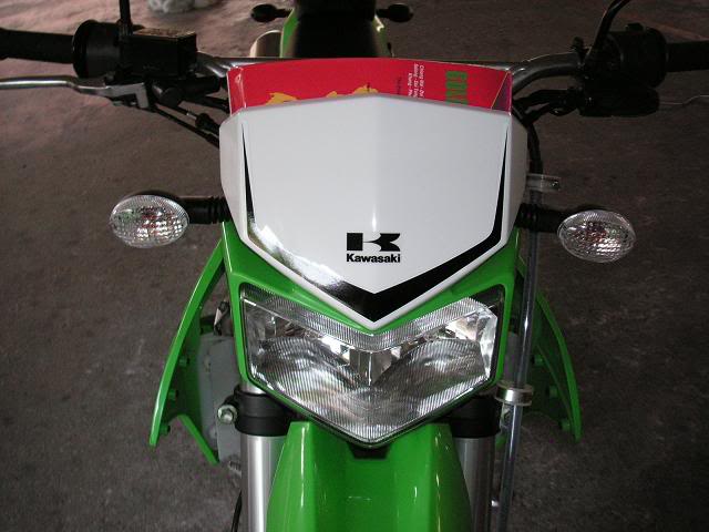

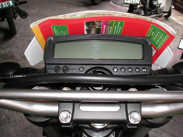

    The most advanced upgrade to the KLX is Kawasaki's innovative "GTRMR" system.
    This unique ergonomically designed system shows the commitment Kawasaki has to the riding experience.
    The "GTRMR" or Golden Triangle Rider Map Restrainer, allows the rider to easily obtain the map without searching
    bags or pockets, and will stay secure no matter the conductions.
    With the aid of the "GTRMR" the words,..."were did I put that #&@%# map," are now eliminated from the riders vocabulary.
    But the "GTRMR" has limitations, it not prevent you from saying..."were the #%@# am I now."
    It also doubles as a headlight shroud and number plate......ingenuous.
