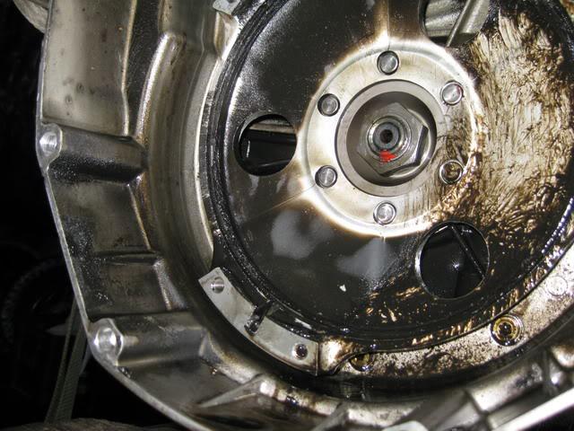

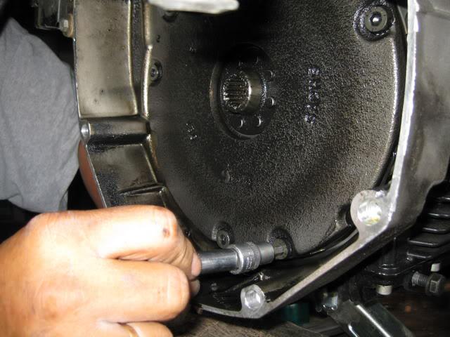

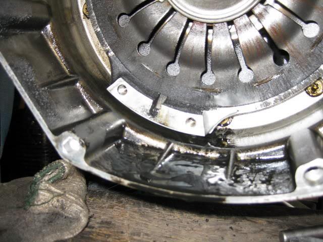

Just to keep you updated abt this BWM K1200LT nightmare clutch replacement

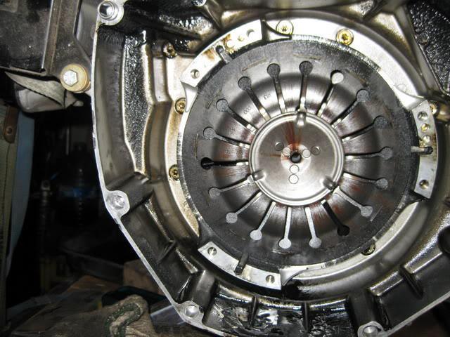

Bike has been driven just under 40K and this is what i found today when we finally managed to open it's DRY clutch,, and this is how it should NOT look.

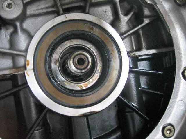

Gear Box side

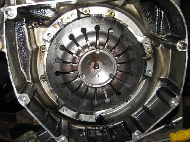

Rest of the pictures from Clutch side

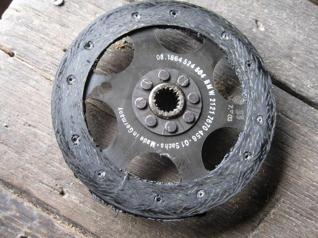

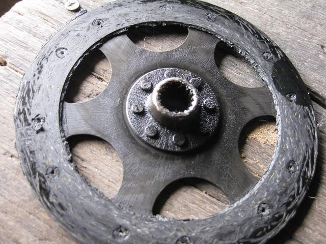

Clutch plate
remember, it should be DRY and so clean,,,,well it was not 5555,clean or dry, we also find few drops of water mixed with oil.
Hi Friends,
You are right, it does not seem so "dry"; however why did it happened ???Isn't it an excess of oil on the other side (this often happen when oil level are wrongly done (please don't feel offensed, it is absolutely not my intention, just to help.).
With good detergents you'll sort it out but i fear the seal is dead as you should have driven like it is today...
Hi All
as i'm part of LT group in US and from info they side this kind of "accident"
is normal but NOT in this scale.
Usually "slave cylinder "fails" with in 10K first time and after replacement,,it should last when replacement is done correctly for quite some time.
There is some thing's to do before she is running again, we have to see if we can fing replacement seal rings from ubon
after all seals are replaced, actuall re-assmbling is not hard and it should run with in few feeks if everything goes well, i still have a lot's of things to do with mods back home

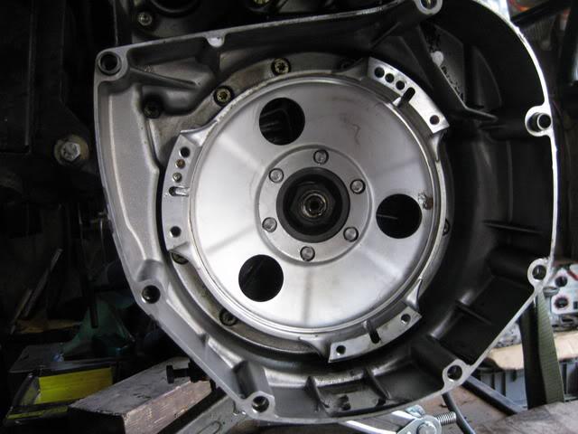

Updated pictures and new issues

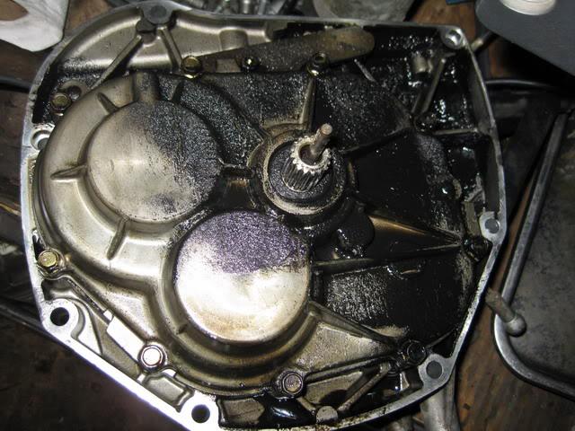

Looks Clean??....NOT,,behind the housing cover
ok, lets clean it..

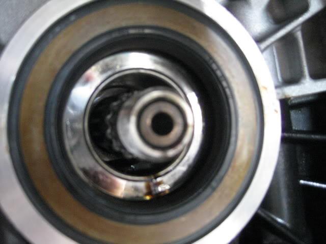

Clean,,,BUT,,, oil coming from engine,,, hmmm,, new issue
looks like ok,, as housing cover is not in place,,but have to be sure b4 put everything back...
