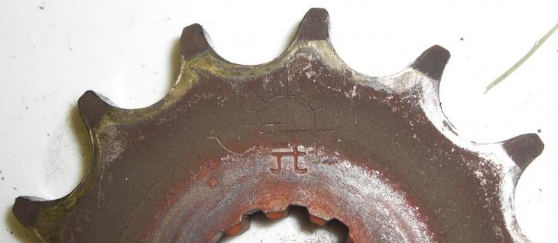

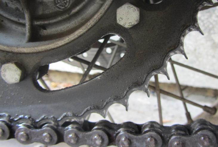

If your sprockets look anything like this "change them as for a chian the best way is to take it off and have a good look to see if there are no kinks in it so to speak or if it is streched to the end of your adjuster time for a new one.

Or this might be a better comparison for you the top one is good and bottom one is worn.
hope this gives you a good idea what to look for.

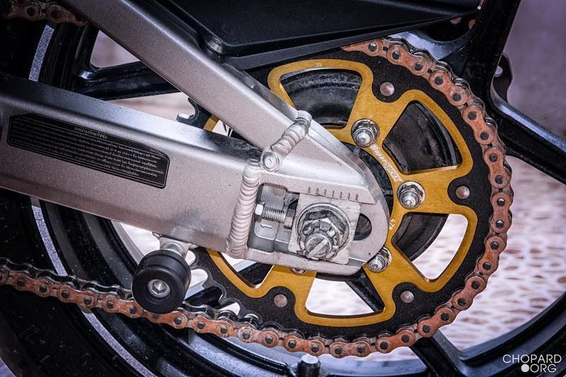

Just changed chain and sprockets at 20'000 for Versys. Took a different quality chain (gold colour) which is about 1'000 more expensive. Total at Kawa CNX slightly over 4'000 (sorry did not keep precise bill)! Seems that it is normal life span (I am not very good in taking care of my chains).

My Versy’s rear sprocket lost two (golden) teeth! It’s new ‘Supersprox 44’ is like coughing syrup for a hectic driver like me; I really appreciate my bike’s new behavior.
I also changed my (golden) chain again; it had run 15’000 kilometers. This, maybe, was not an absolute necessity, but it reduced noise and increased smoothness. The new front sprocket is still stock.
My speedo might now be inaccurate (10 %?) … if it was ever accurate before, and with my casual driving style, I might not notice any other side effect.

Jurgen;295355 wrote: My Versy’s rear sprocket lost two (golden) teeth! It’s new ‘Supersprox 44’ is like coughing syrup for a hectic driver like me; I really appreciate my bike’s new behavior.
A Supersprox rear sprocket. That should last you forever. Top choice!
