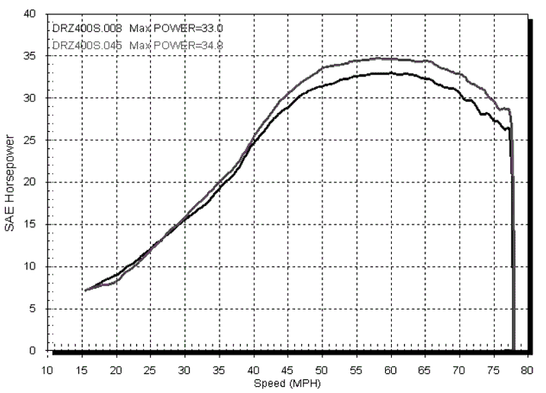

Hi Hiko
Your figures re the DRZ400S hp are the manufacturers which is fair enough
My figures are from non manufacturer dynocharts
Loads of them avail via google
eg
http://www.totalmotorcycle.com/download ... RZ400S.htm
I guess its personal choice which figures one uses
