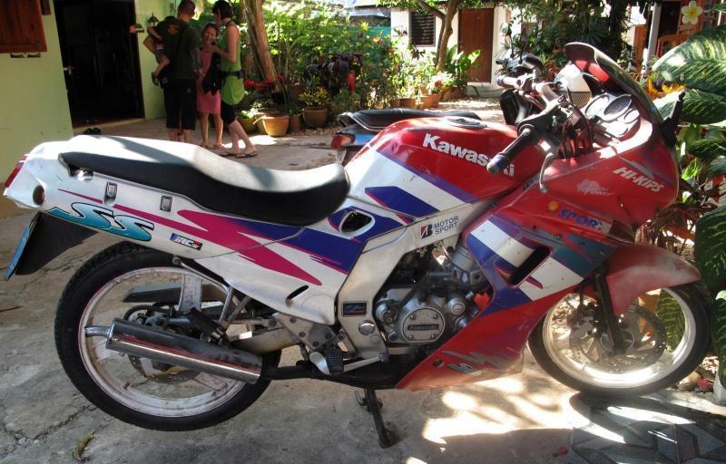

    I need some parts and only found a 150 cc "Serpico" in parts lists. Hopefully somebody knows the answer. It's powerful and feels like a 150 cc, but the Thai lady seller claimed it was "a 125".
    Will add photo later, am at work
    Chris

    i`ve got a ZX 150. what you describe is more than likely some sort of KR 150 engined bike.
    these are ex police bikes that were made in thailand and kawsaki has a heap of spares for them.
    kawaski CM has a ZX,serpico and some of the older KR model parts catalogues.
    what is it you are looking for? and a pic would help.

    Cheers! Am trying to upload a photo. Chris

    Photos: am trying it again
    Attached files 274308=7299-KRR.

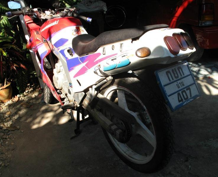

    The file size was too large - I missed that.
    Attached files 274309=7301-KRR3. 274309=7300-KRR4.

    i`ts a Serpico,alloy frame and KIPS and a 150cc.
    http://dwinugros.wordpress.com/2011/03/31/varian-ninja-hanya-mentok-di-250cc-lha-terus-yang-150cc-apaan-tuh/
    looks like an Indo site but it says that it`s a 150.
    http://dwinugros.files.wordpress.com/2011/03/kawasaki_serpico_ss_150_4.jpg
    i think you`ll find that Kawasaki CM will have a parts catalogue for it. you just have to nail down the exact model it is and they will be more than helpful in finding the parts for you.
    most of the engine parts can be used in nearly all the KRR engines.
