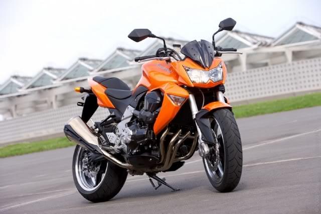

123 Horses, but not sure if thats at the rubber, with some minor mods it can easily push out 150 odd.....
If I was to hold a naked protest outside the office they would surely let me use the Dyno, out of sympathy, looks like a penis, only smaller.
Pikey
www.tbbtours.com
So they've ditched the 4 pipes and replaced them with a ......? Jeez, from this pic at least, a 5 year old with a box of crayons could have designed a better looking silencer!

Feb 24, 2006
I agree with you pikey, the pipes look awful, from what I gather they are still the same setup as the old 2003-2006 pipes, but with reworked silencers, god awful, they will be the first thing to go..... if I was to purchase the bike. The original Z1, wonderful bike, I'll have to dig out my copy of Mad Max.... I used to run mine with a Harris Magnum, it used to growl like a grizzly on steriods. I had a Z750E for awhile also, chopped it in on a GPZ600 which I couriered for 2 years in and out of London.
