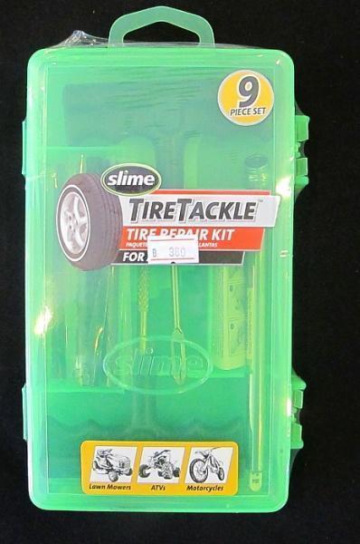

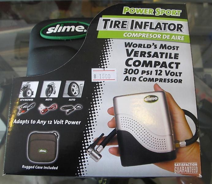

Popping up an older thread, simply because of the title.....": Fixing puncture?/? "
August 2012
Noted these in Piston Shop in Chiang Mai
and reckon that for tubeless riders, these certainly maybe the way to go.
Check with Nat at Piston Shop.
OR
check out the Slime Website.
Marty these might be good for you guys in CEI to sell?
