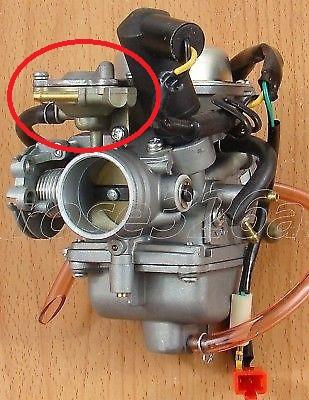

The rain stopped for a couple of hours this morning so I had a chance to do some work. I wasn't sure the ignition/spark was the problem as the engine would run at higher revs in neutral but would not run at the same speed in gear. I decided to take the carb out and give it a really thorough clean.
The jets seemed fine but I gave them a good cleaning anyway. The only thing I found that was suspect was one of the air in/outlets inside the area circled. (I'm not actually sure what this part is - comments welcome). Anyway, I cleaned everything thoroughly whether it seemed to need it or not.
After reassembling and refitting the carb I fired up the buggy and put it in gear as the rain started to fall again. I only managed a quick 2 min test drive around the block but it seemed to be running OK. I only got up to about 40km/h so I'll have to wait until the rain stops again to check it runs flat out without problems but the signs are promising.

I believe the part you circled is the vacuum operated fuel pump...that would indeed be your problem if it wasn't working or got stuck somehow.
Aahhhh, that would make sense. When I stripped it down I blew into the breather inlet/outlet and it seemed to be blocked. When I opened it up it had a narrow capillary about the diameter of one of the holes in the side of the jets that appeared to be blocked. (leading from the brass nozzle in the circled area to the internal area where the small diaphragm is). I cleaned it with a fine piece of wire and squirted in some WD40 to flush it through and that seems to have done the trick.
Thanks a lot for the info.
