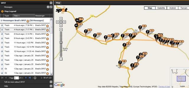

Here is an example that was sent to me;
If you read my last few Laos posts; I was 4 days without telephone contact of any kind, 2 without electricity, (you need to get off the highway more Jeff), the telephone in any kind of emergency is virtually useless.

Dave could you attach a larger image of that SPOT track for us optically challenged peeps. Thanks.
