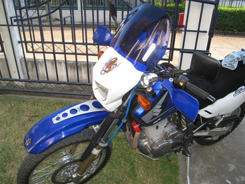

I don't know if you can get them in Thailand, but I just fitted one of these to mt DRZ.
It's 50mm (2") square, runs from 9 - 50 volts, draws .75amps at 12 volts & lights up the trails great. I chose the spot/flood mix.
Cost me $139 Aus, bolted it via a bracket to the triple clamp bolts & wired it into the high beam.
If anyone wants a closer pic as to how I mounted it, I'll post one once I wash my bike.

Hi Pounds,
It look great, specially knowing about the poor genuine lightning of the DRZ, unfortunatly at date I did not saw anything like that around. I use to shop for bikes and cars parts in KlongTon and Banh Mooh BKK area, but never saw that.
Maybe someone has an idea about it ?
As said I equiped all my bikes with a HID Xenon bulb with ballast, it works very good and change life during night.
For the BMW 1200 GSA, I recently change the H11bulbs of the additional fog lights, for 2 "Eagle Eyes" Xenon like H11 bulbs and it works good as well, for the parking light, I found in KlongTon some small bright LED bulbs which fit perfectly.
