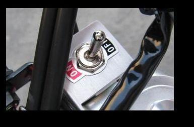

    I took my KLX to Chiang Mai Kawasaki, and for 800 baht they supplied and fitted this small switch.
    KLXlightKawasaki.
