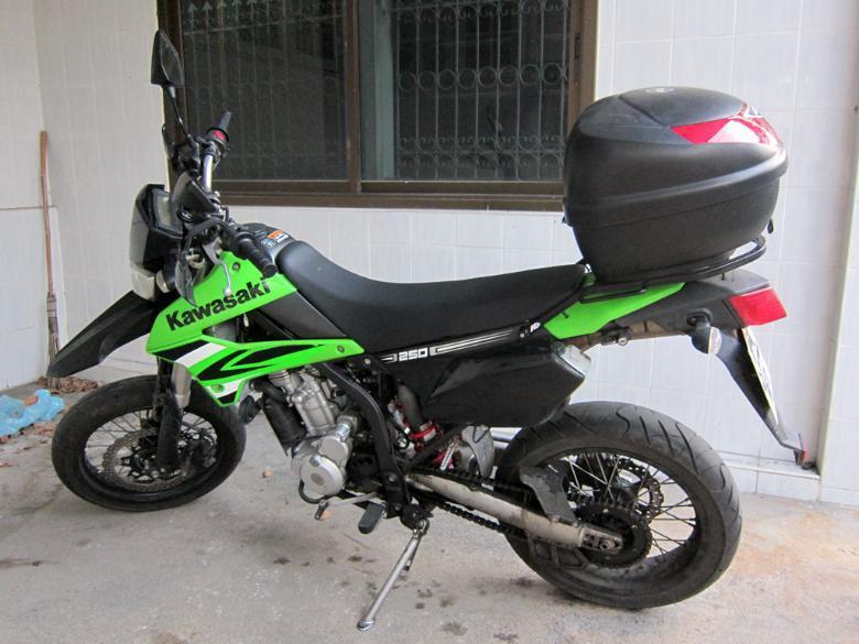

Just fitted my Givi E30 topcase on the back of my Kawasaki KLX 250.
Inside the case, it says the maximum speed is 110 Km/hour and maximum weight is just 3 Kg. I'm taking a 4 day trip next week. Won't have too much gear, but definitely more than 3kg and I will also be riding 130 km/hour in some stretches (on my recently de-restricted KLX).
Does anyone think this is unsafe due to the risk of the case coming off? Has anyone ever had their Givi case come off due to riding too fast or too much weight? I've seen 650 cc bikes with Givi topcases, so people are obviously riding more than 110 km/hour.

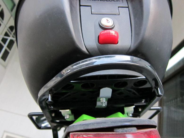

Also, I couldn't find a proper Givi rack for the KLX so I attached the case to the metal rack I already had. It appears to be secure as it is attached with the three screws that came the plastic plate which the Givi case is mounted on (see photos). The advantage of using my own rack is that when I have a lot of gear (more than the box will hold), I can take of the box and plastic plate and just strap all my gear to the rack properly.
Does it look safe?

The box isn't going to blow off. I have 3 different size boxes shared between 3 different bikes. It doesn't need to be mounted on a Givi rack. As you see, they are designed to fit fairly universally on almost any rack. Overloading it can possibly cause the rack or the frame mount itself to break. This is not because of the Givi box, it is because it was overloaded. This also applies to other brand boxes, soft luggage or milk crates strapped on the rack.
I have ridden at what is 'well over' the stated limit (both in speed and in weight). I agree, that I think it refers to bike handling. As it is basically out of the wind, protected by your body, I don't see that as much of an issue either. I did have a rack fail after many days of riding off road in Laos. It was my fault, as I stated above, the rack was overloaded with tools and other gear. The box was fine.
As they say here in Thailand "You think too much!". Don't get crazy with what you carry, ride and enjoy.
Edit: P.S. i recommend you also Loctite or use good lock nuts on the bolts holding your plastic mount to the rack. I have had those vibrate loose on more than one occasion. Over tightening just bends the mounting brackets.

I agree with Silverhawk; I had the nuts/bolts come loose a few times. I used rubber inserts which fixed the problem. Loctite would be just as good.

I used the three screws that came with the case to mount the plastic to my rack. I've been 500KM on this trip so far and I've checked that the screws are still tight. Maybe I'll feel better if I add two or three more screws. See the photo to see if the mount looks sturdy.
What is Loctite?

Looking at your photos, it looks like you have already used nylon locknuts. You should be fine. However, I believe the Givi usually comes with 4 mounting brackets and I only see 3 in your photo. If you have 4, use them all (to spread the support).
Loctite is used by most mechanics. It is a liquid you apply to the threads before attaching a bolt. It helps prevent loosening from vibration. It is available in most hardware type stores in Thailand. I usually find it in the blue bottle. ("Google is your friend").

Garet, the GIVI mounting set usually have 4 screws with nuts that have this little PVC insert that prevents loosening (don't know the English word for it), so no problem there. I use the Givi's myself and only experienced that the FJR became unstable with also the sidecases mounted at speeds exceeding 200......anyway that's far above any legal limit and a no-no. With lower speeds on the enduro's, there's no problem at all. Also the crap about 3kgs max. load I never really care about, even the Malaysian made boxes can carry much much more. Cheers, Franz
