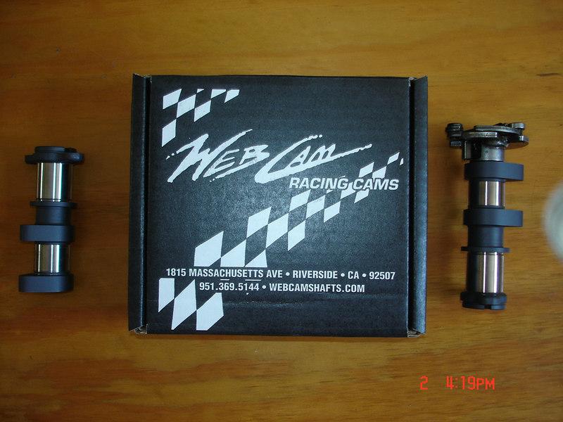

To give my anemic KLX some lungs I punched it out to 331cc, installed a set of Race Cams,
and have it breathe through a 35mm Flatslide Pumper carb. Mighty fine decent ride now.

BignTall, seems like it was worth the investment. How much was everything incl labor? Couldn't have been cheap...
What about the cooling system, a 33% increase in cc and hotter cams should produce more heat, is the stock radiator sufficient?
KZ - From what I have read, on the KLX250S Specific Forums, The cooling is a non-issue. Several members have run tests to see if they could even get the radiator fan to come on and most failed. Those who did were mainly on tight and challenging single track. Many also changed fans to smaller ones due to a larger fuel tank mod that interfered with the stock fan. Many = lots more than I can count and then some.
B&T - what year is your KLX? Is it in CNX also? I was thinking if the 09 feels castrated to me that I might jump in the the big bore kit myself. From what I have read on that it's a relatively easy install. Did you rejet your carb and upgrade your exhaust too?

Not sure of the vintage as the numbers have been changed for a plate. However best guess is around 2002 or something. They have been made in Japan since 1996 with no changes other than color and radiator shroud shape. Kawasaki began selling it in the states in 07 as a new model. What a laugh since it had been putting around Thailand and Japan 5 years prior.
No cooling issues and its been though a lot of tight singletrack
and pressed into motard duty with an extra set of rims.
Been a trouble free bike crossing three countries and loads of KM's both in dirt and motard trim. Nothing wrong with them just a bit anemic stock.
Is the money I pumped into it worth it?? Probably not, between the biger bore, pumper carb, exhaust, etc it was not cheap but it has bought me many smiles and memories which are hard to put a price on.

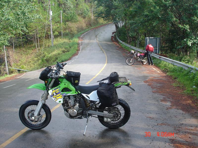

Aha. Nice pic, but ...
1. What's with the 4.06AM time - wrong country?
2. What were you standing on when you took the photo?
3. Where's the road - my guess either the Samoeng loop, or en route to Doi Mae Salong?
Who says I don't pay attention to your photos?
