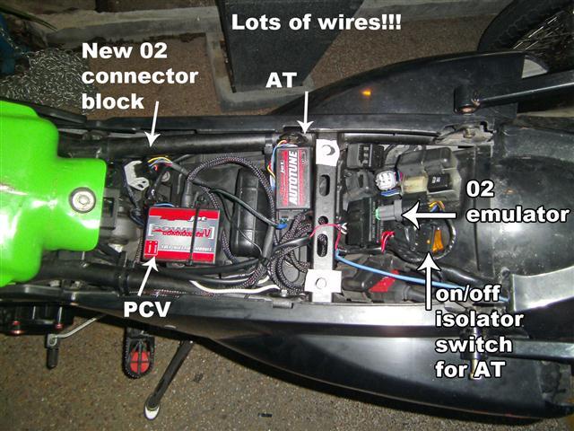

1. quite complicated to install - lots of wiring etc etc (crap instructions) & stuffing the PCV & Autotune all under the seat is a mission in it's self!! Can be done though. AT has to be this close to the PCV !!

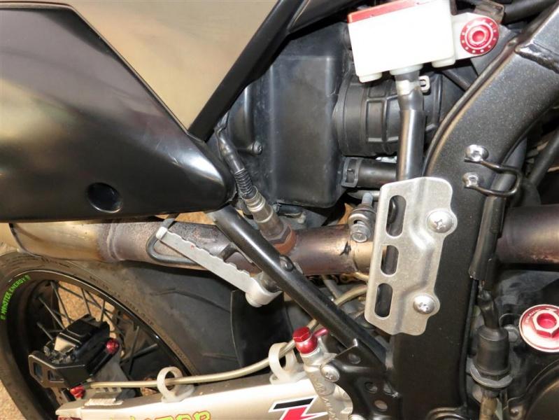

2. your stock 02 sensor bung thread is to small & the larger bung supplied with the AT will need welding in.
3. The new Bosch wide band 02 sensor is way bigger than the stock sensor & you will have trouble finding a good spot to weld the bung. Take your time working out a place not to exposed but away from airbox plastic. (will depend on your exhaust....FMF was tricky)
4. Small single cylinder bikes are hard to tune with Autotune at low revs....just not enough reliable gas from a 250 engine for the AT to sniff for accurate readings. It will eventually work but will take way longer to fine tune than a large cylinder engine!! The 331 or 351 will work better for this reason.
5. Expect to take a week to really get you head around setting AFR's & trimming MAPS with AT & maybe a month to get really good with the software.(If your only playing for a couple of hours at a time or at weekends etc). Your gonna be doing hundreds of KM's of steady revs test riding for you to eventually get to the fine tuning side of a quality homemade MAP. No detailed video tutorials on the AT unit anywhere on the net!!! that I could find.
6. The on/off isolator switch was not suggested in the instructions. The instructions recommend taking a power feed from the rear light loom (which I did), so then the AT comes on with the ignition. With my isolator switch I can now turn off the AT when I don't want it on! When the isolator is off I can use a water-proof switch on my handlebars to toggle between MAP1 & MAP2 on the PCV.

This is my mess under the seat!
This is where Bob from Indonesia fitted his 02 sensor.
This is where I fitted my 02 sensor.
