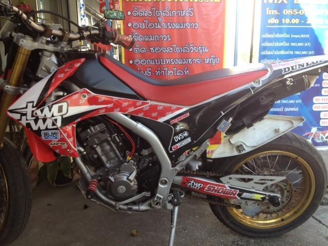

Have seen quite a few CRF's about with 2 red wires attached to the engine as shown in above picture. Can anybody enlighten me as to what they actually do ? I havent been able to get a sensible answer from anyone yet.
Ian Bungy
2,307
310
www.chiangmai-xcentre.com
Hi Gary,
A couple of Guys I know have these Wires Fitted with the Stated Purpose being to give a Better Earth and Spark Blah Blah??? Something along the Lines of Peter Brocks Controversial Atom aligning Box??? We actually got a few Bikes in a Straight Drag Race and saw NO Difference at all? One actually had a Complete Exhaust System with Header, Power Bomb and Carbon Pipe and that ended up the Slowest of the Bunch!!! Hows that!
