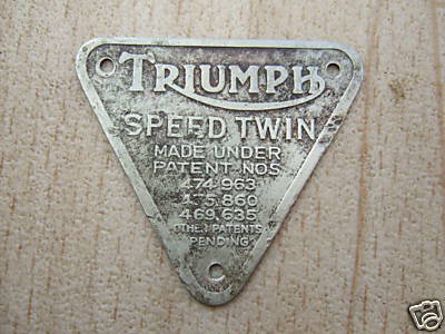

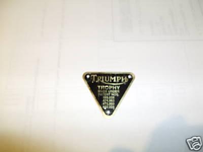

Oh and by the way…… Triumph’s Coventry factory was destroyed by the Nazis in the Blitz of 1940. After the war, Triumphs were built in Meriden.
Regardless of anyone else’s opinion, my old Trumpets are my Mia Noi’s and much like my Mia Luang they have their foibles, but I love them all and wouldn’t ride anything else!
Ian
OH SHIT I,VE BEEN TWICE AT THE FACTORY IN MERIDEN. I GOT COVENTRY FROM WHAT I REMEMBER FROM THE SMALL BADGET ON THE TIMING COVER. DOESN'T IT STILL SAY TRIUMPH COVENTRY IN THE 1970'S?
HIKO
Hiko,
No sorry. By '71 they had a badge common to all.
OK I GIVE UP.IN MY OLD BRAINS IS STILL LEFT THE SAME BADGE YOU POST SAYING TRIUMPH COVENTRY,
MAYBE I'M GETTING OLD.....BUT THE BADGE IS BEAUTIFUL.
HIKO
PS I THINK I CHECKED THE SAME BADGE ON THE NEWER "TRIUMPHS" IN BRITBIKE 2 YEARS AGO AND SOME BIKES SAID MADE IN BRITAIN SOME SAID BRITISH DESIGN. I WONDER WHY....
HIKO
