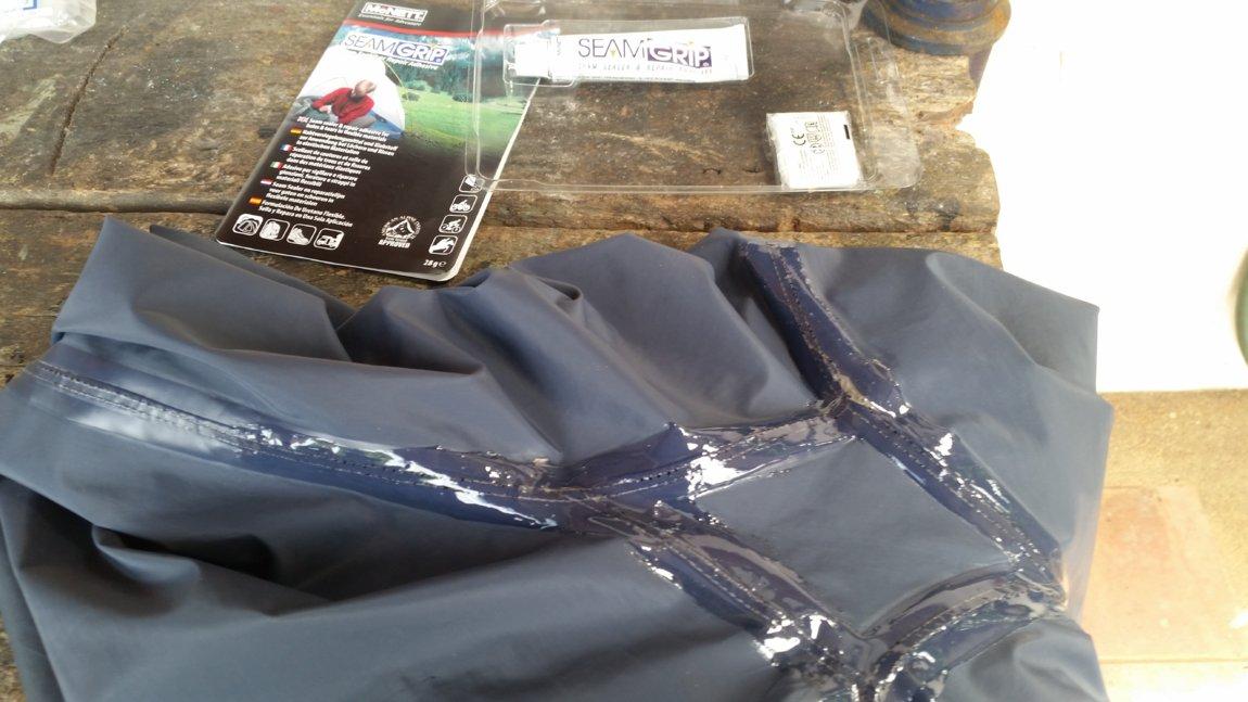

My 4 year old Givi rainsuit has been excellent and seen a tremendous amount of use every wet season.
But the trouser crotch seams had started to leak. Looking at them in the light, I could see right through 3 stitch holes.
I used McNett "SeamGrip" to re-seal the seams. It is a very sticky adhesive and cures overnight to form a flexible new seam tape. Wonderful stuff. 10 GBP a tube on Ebay. Much cheaper than a new rainsuit. This sealant is specifically for polyurethane materials.
I now expect the rainsuit to last many more years and have put the SeamGrip tube in the freezer to try and prevent it curing in the tube.
They also make a "FreeSole" for glueing your boot soles back on, which is a common problem in a warm humid climate.
