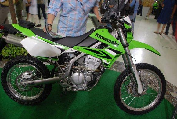

Venman, if you can't get things sorted out I trade you a brand-new KLX150 for your CRF! ;)
KZ25
Nov 19, 2011
805
I throw in an Airhawk - it wouldn't raise the seat height of the KLX150 too much.

That's why I thought of the KLX150!
Lower seat height + Airhawk = soft but not too high.
Deal? :)
