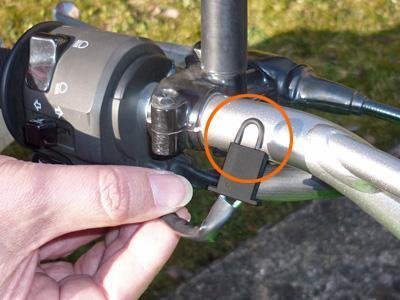

    First picture: locate the plug close to the clutch lever.
    275082=7923-Kawa-frisieren-pic2.
    Pull out the plug and bridge it - bingo! This supposedly activates a second, hidden ECU map and lets the engine rev all the way in all gears.

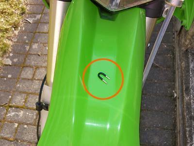

    275082=7924-Kawa-frisieren-pic4.
    A wire of appr 1.5mm strength should do the trick.

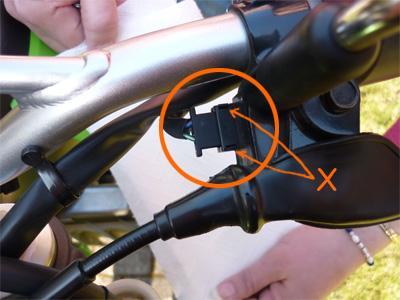

    275082=7925-Kawa-frisieren-pic6.
    That's the idea! Job done! And it's easy to reverse without anybody ever knowing it, so no worries about voiding the warranty.
    Now tape it/secure the cable to the handlebar and make sure the wire stays in.

    I tried this mod, and it works, wish I knew exactly why. I tried to ride the bike without the mod and quite frankly its almost unrideable , you can feel the difference and its quite obvious how bad the restriction was.

    I suggest clicking the links and reading the posts. Bridging the plug or crossing the wires will give you the same result.
    As mentioned, a different map gets activated.
    The switch (and plug) is there so you can't accidently start the bike while it is in gear. So don't start your bike while it is in gear.

    I've blocked the connector end with a bit of plastic and silicone to keep out dust and dirt and the loop wire hangs nicely on the black cable tie thing thats already there.
