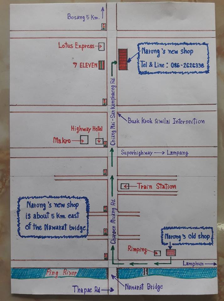

For a custom seat try Narong. Not cheap, but quality.
He made me one for my CRF to fit my fat ass
Reactions: Biggles

By the way Canthai, thanks so much for the map. Very kind. Also how does the thumbs up work. Just click through it as a thank you?

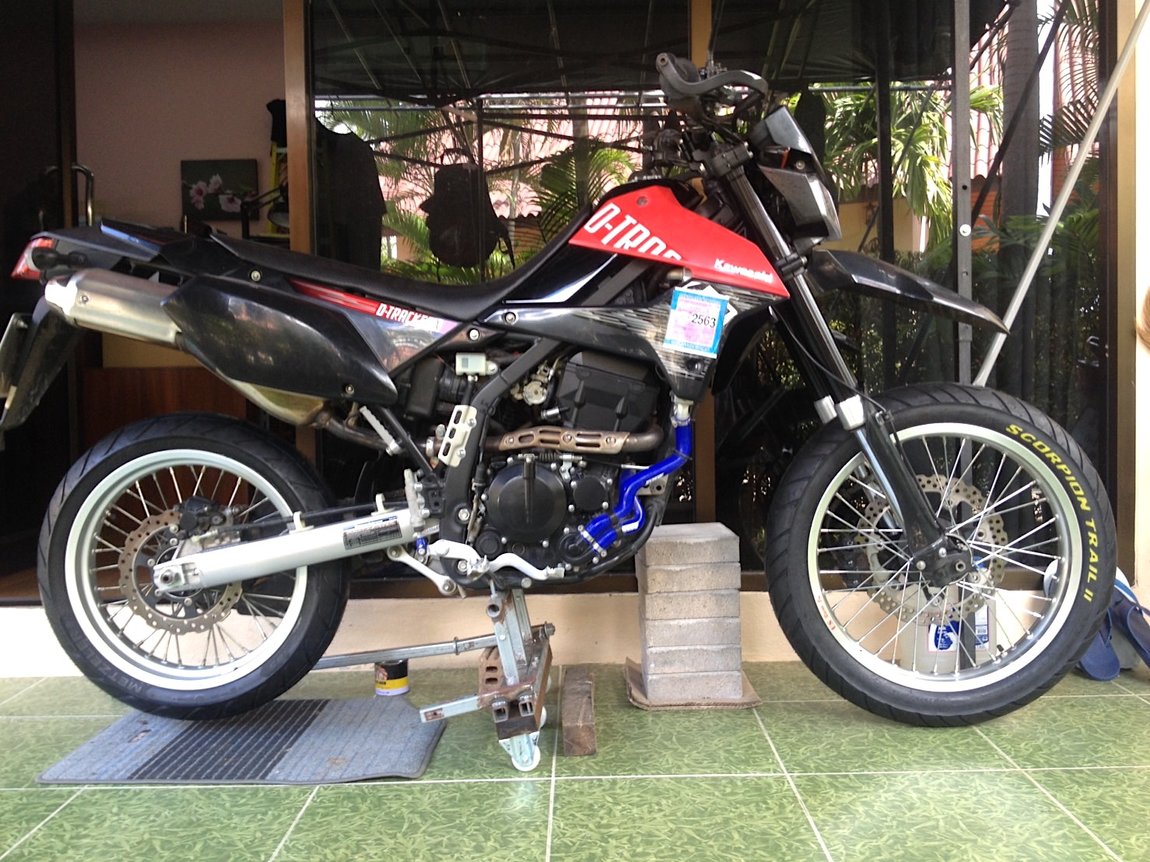

I looked at Burning Co. Shock Shelf yesterday. Did not have my glasses with me, but through my not so clear eyes looks like about 18K-20K for Ohlins Rear for KLX/DTracker / CRF. Based on size and number of parts, my guess is 45-50K for Front Forks. Thats 65-70K total. So, I’m going to try RaceTech or similar springs initially I think, because I can spec the springs to my weight & ride style. A quick look says the stock units are Kayaba / KYB, and they do make good stuff, so maybe a re-valve if I can work out how to do so later on. (A few national class A grade race guys I knew in Oz that I was a small sponsor of were fitting Kayaba / Showa bits in the front & rear units of their Bears / Thunderbikes etc, with great results). Ian, thanks for the tip on Home Motor & Canthai, thanks again for the map. Heres a pic of the bike thus far.

Front Suspension is cheaper than the Rear and Canthai is about right in Price? You can also check with CMS as they are the Agents for both Ohlins and YSS I believe? He can set them up for You also? For Your Thumbs up look at the bottom right of the Chats and there is a Row of Emojis. Just Click on which one You want.

View attachment 133784 I looked at Burning Co. Shock Shelf yesterday. Did not have my glasses with me, but through my not so clear eyes looks like about 18K-20K for Ohlins Rear for KLX/DTracker / CRF. Based on size and number of parts, my guess is 45-50K for Front Forks. Thats 65-70K total. So, I’m going to try RaceTech or similar springs initially I think, because I can spec the springs to my weight & ride style. A quick look says the stock units are Kayaba / KYB, and they do make good stuff, so maybe a re-valve if I can work out how to do so later on. (A few national class A grade race guys I knew in Oz that I was a small sponsor of were fitting Kayaba / Showa bits in the front & rear units of their Bears / Thunderbikes etc, with great results). Ian, thanks for the tip on Home Motor & Canthai, thanks again for the map. Heres a pic of the bike thus far.
