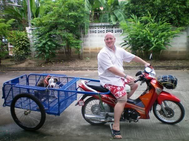

Found a pic as my mate has one for his dog!
Pikey.
Nov 2, 2008
344
18°47'49.98"N and 99° 0'7.45"E (me thinks) there is a selection of trailers on display here.
2,393
376
www.chiangmai-xcentre.com
Do you know:
1. Cost?
Bugger All, around a 2000 Baht?
2. Legality?
Totally Illegal as are every other Side Car and Trailer for Bikes in Thailand!!! :shock:
They make another version with Smaller Wheels which looks a lot smarter than the Pictured Colossus!!! If you got one make up a Hitch onto the Grab Rail at the Back would make it much easier to use instead of Sitting on the Handle and I am sure it would be easier to Handle? Have you ever seen the little Tuk Tuk / Bike Taxi's they use in Siem Reap Cambodia? They have a Hitch where the Back seat would normally be on the bike! Quite neat.

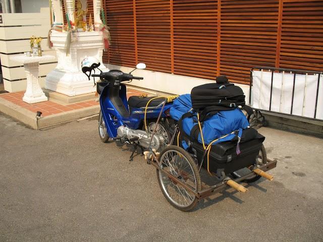

Hi everyone, it's been a year now...
In the end I made my own collapsible trailer out of 25mm square tube and bicycle wheels.
I lashed the trailer to the rear hand grip of the scooter and off my wife and I went in Thailand.
When we were done in Thailand, I dismantled it (it was put together with bolts), put in a suitcase along with the wheels and took it on a plane to Vietnam where we used it.
I left it in a place called Phan Thiet when we came back to the UK as I decided that version two needed to be made out of 3" bamboo and not steel
How do you upload pictures to this site?
Nigel
Nov 2, 2008
344
Very creative, looks like your were able to take it all with you on your tour. Nigel, how did the Dream drive riding two up pulling the trailer?
Never have seen larger units like the last two in your pictures, carry your gear and a spare Honda Dream.
Jan 30, 2006
19
It worked really really well. We were in Chiang Rai 3 yrs ago and just toured around from a fixed base on a Dream. It worked really well providing you keep the speed down to about 60kph which is fine for us because we like watching the country side go by.
I hired this Dream from Mr Mechanic on Moon M. Road. The first one had knackered suspension so I changed it for a newer one - worked a treat. Because the load is in the trailer it tends to pitch the scoot over a bit on the tight hairpins into Pai, but other than that, worked a dream (pun)
Next version will be made out of Bamboo. You can see bits of bamboo under the cases in the photo you kindly uploaded. If you make one out of Bamboo you only need to make the brackets, which is easier to carry in your 'plane luggage.
Thinking of coming back this November (2010) as the visibility in March is bad.
Thanks for the picture upload
Nigel
