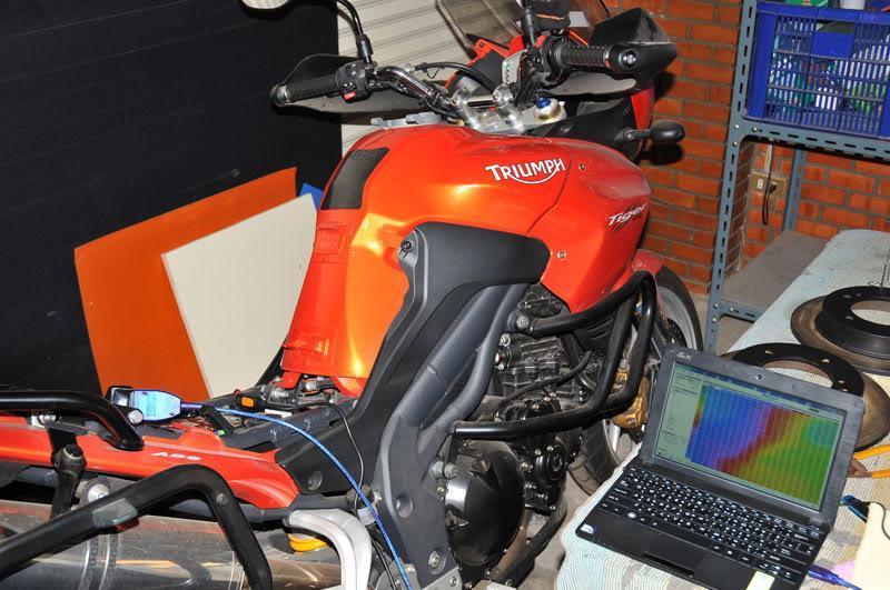

  6. Well I'm happy to report the software works fine. loaded the updated tune to my bike this morning and running fine so far!
    DSC_2274r.
    Only 1 minor panic moment after I finished, the Tiger won't start without the headlight fuse fitted!

  14. Well, I went ahead and ordered the cable and plugs to remove the o2 sensors from Triumph Twin Power in the UK. I had already removed the air injection and had an airbox removal kit, k&n filters etc already to go in so once I installed everything I dragged my desktop pc out to the shed, downloaded the map from TTP and uploaded it via tune ecu. It all went well apart from after downloading the map the bike wouldn't start! After shitting myself and fretting for a half hour I put the headlight fuse back in (they recommend you pull this so you don't drain you battery and also have it on a battery tender) and it fired right up! That was a relief I can tell you! Screwing around with an ecu and then getting just a click sound when you go to start it is not nice! I bought the map with the ignition advance included and man, it really goes now. Night and day! It wasn't cheap but am very happy with the results. It really goes like a 900 twin should now!
    here's the set up:
