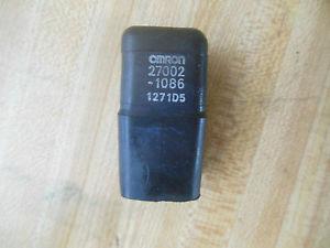

The second I am looking for is an relay.
The omron 27002 - 1086 aside from buying at Kawa itself.

The relay is the aux-power relay for the Versys, right ?
They are headlight relays, but I could never get anywhere trying to find the right 'grey' market one, so I bought the Omron from eBay, second hand, shipped from Germany, I paid 500B inc shipping. I use it to power my LED lights.
There are work arounds, most Thais wire their lighting etc. into the horn circuit or something else, i forget where to, because it sounds a bad idea to me ( you can find details on the Versys forum ) and there are also other relays that you can connect up using spade terminals, the Omron fits exactly into the socket, its a weird pin arrangement.

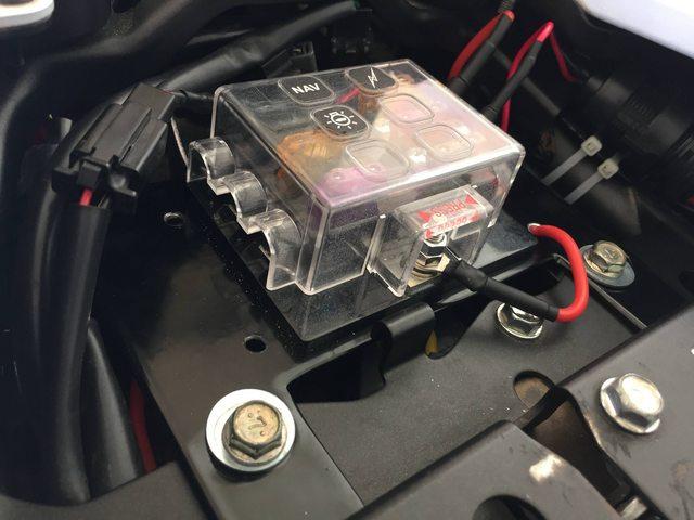

I also have a aux fuse box under the pillion, which has a cheap Chinese relay that is activated from the dashboard light power - the power is drawn directly through from the battery via a inline fuse to a 6-way DP that powers my halogens / GPS / 12V / 2x USB outputs. By rigging all my aux power pretty tight saves a lot of wasted time on the roadside in the rainy season when fuses always blow.
