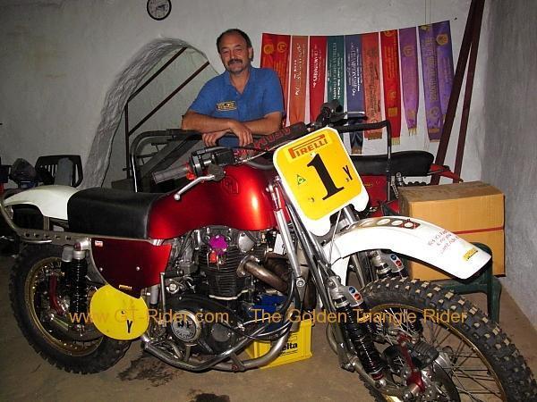

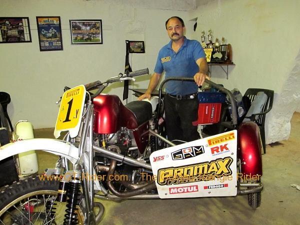

Walter Preisig
Note the plate

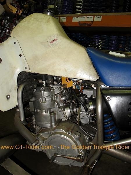

Who knows this bike?

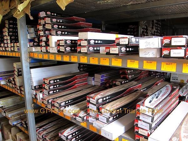

note the spring stock in the background.
that's a hell of a donk for a two-stroke!

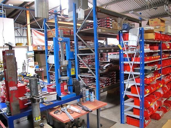

Some of his shock stock
Walter can build / set up any shock for you
send him your details & he will set it up for you.

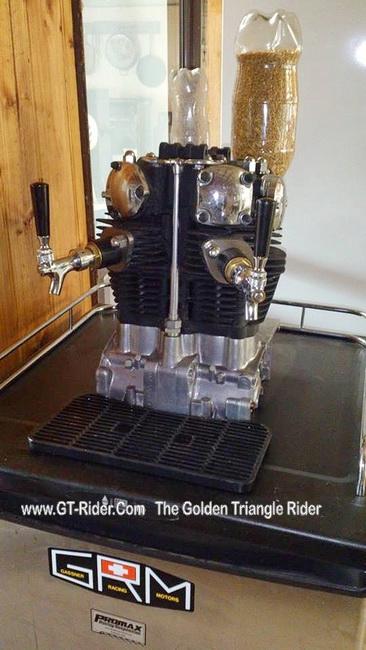

He also has a pretty trick beer tap.
now what motor is that guys?

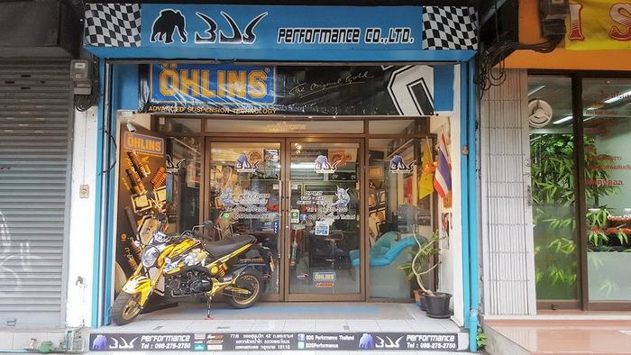

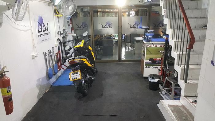

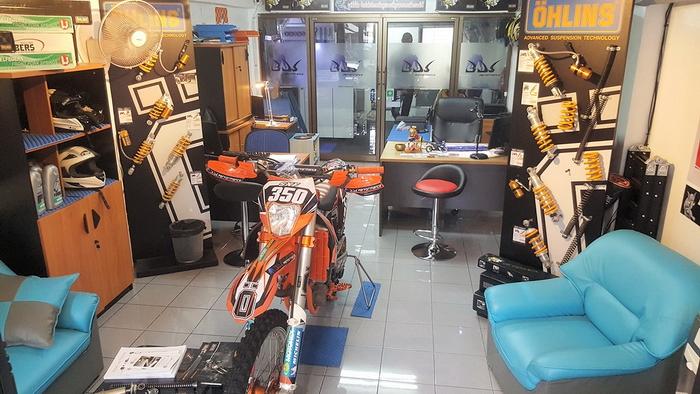

You could contact these GTR supporters
banner-bds-performance-gif.3960
Home
BDS Performance in Bangkok
Home
Contact: Mr. Brad Judd
Operations and Engineering Manager
Tel: (66) 098.275.2750
Excellent reviews for them on GTR
