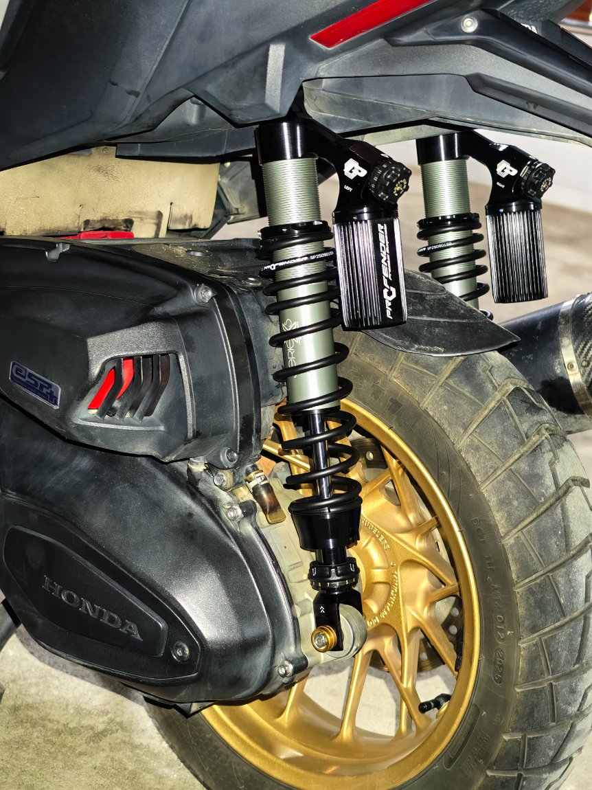

The Ohlins HO 208 rear shocks have lost the plot after covering 39,000km. Oil leaking and ineffective damping. I'm waiting on a rebuild quote together with timeframe to repair.
It will either mean downtime, refitting the original shocks or buying Profender Series X. I'll probably go for the Profender and have the Ohlins rebuilt if the cost is not ridiculous high. Not into weeks of downtime.

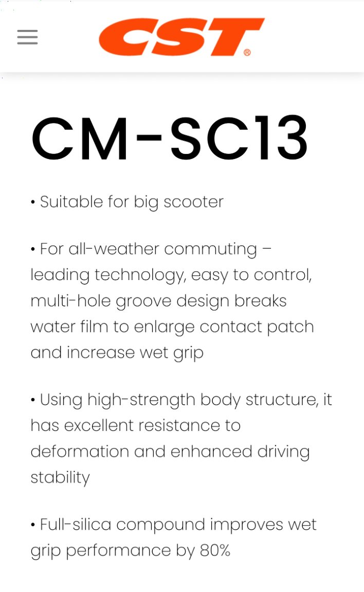

Those Karoo tyres are terrific. I'm using my second set CST bought under 3000thb pair. I've not seen them that cheap again. So, I'll be very content to return to the Metzler Street Karoo.

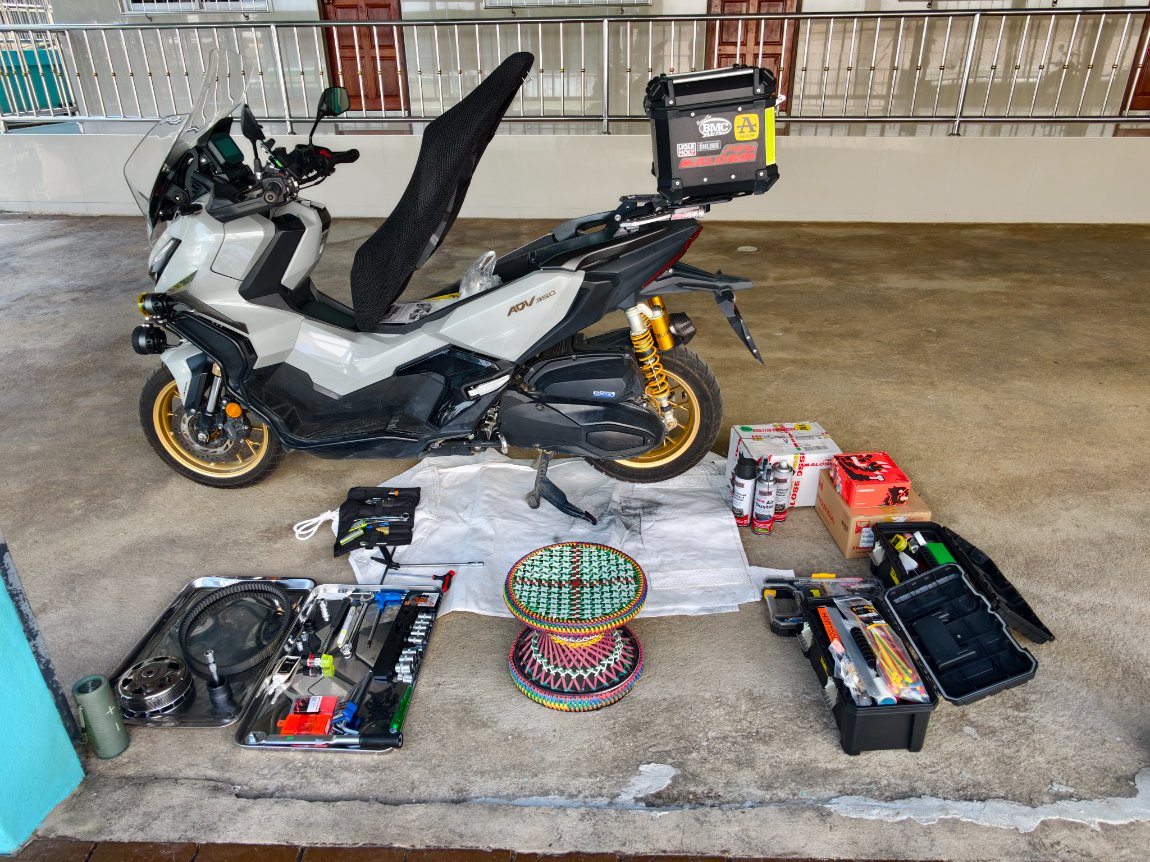

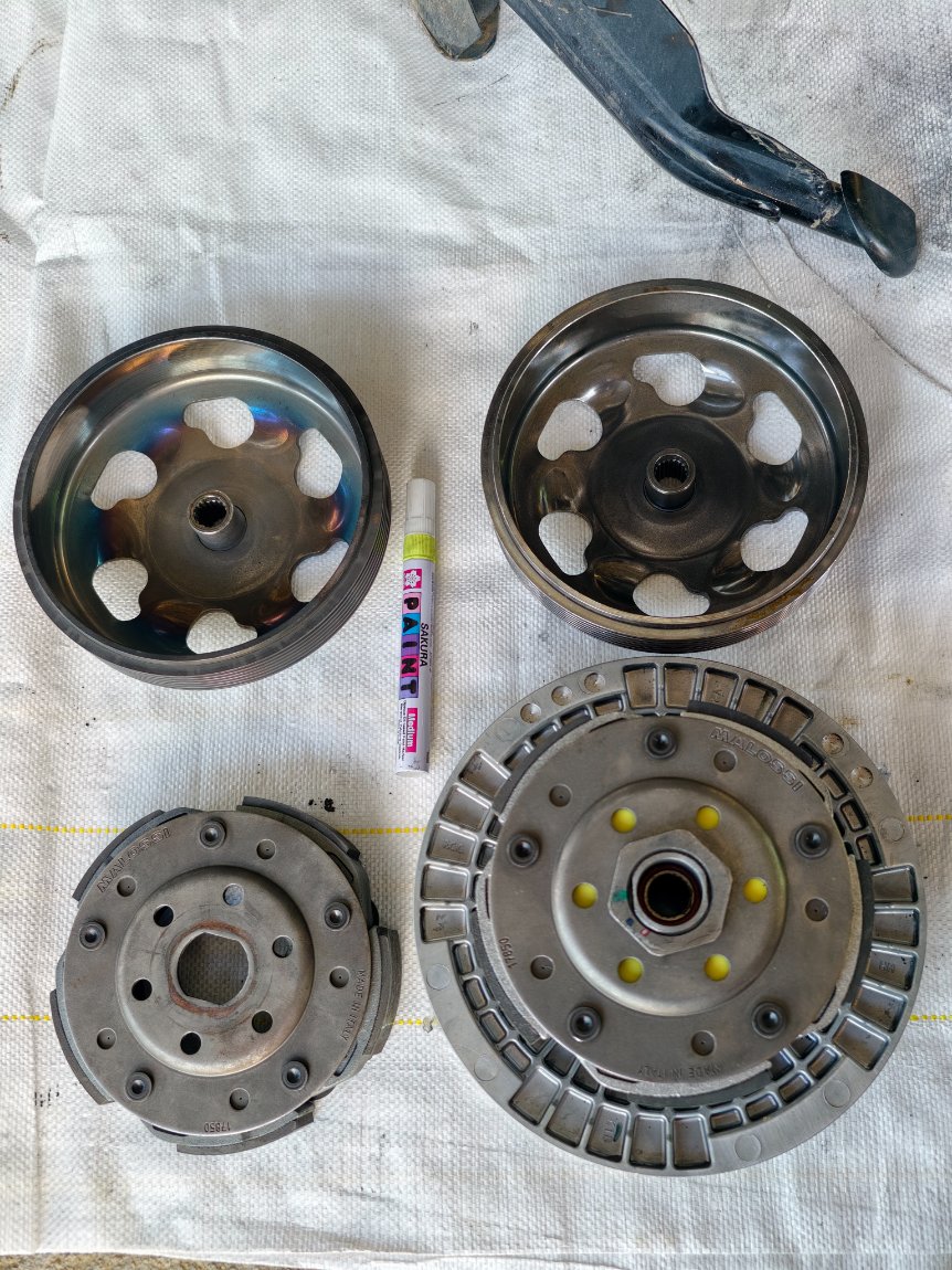

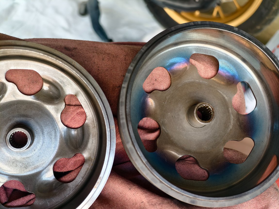

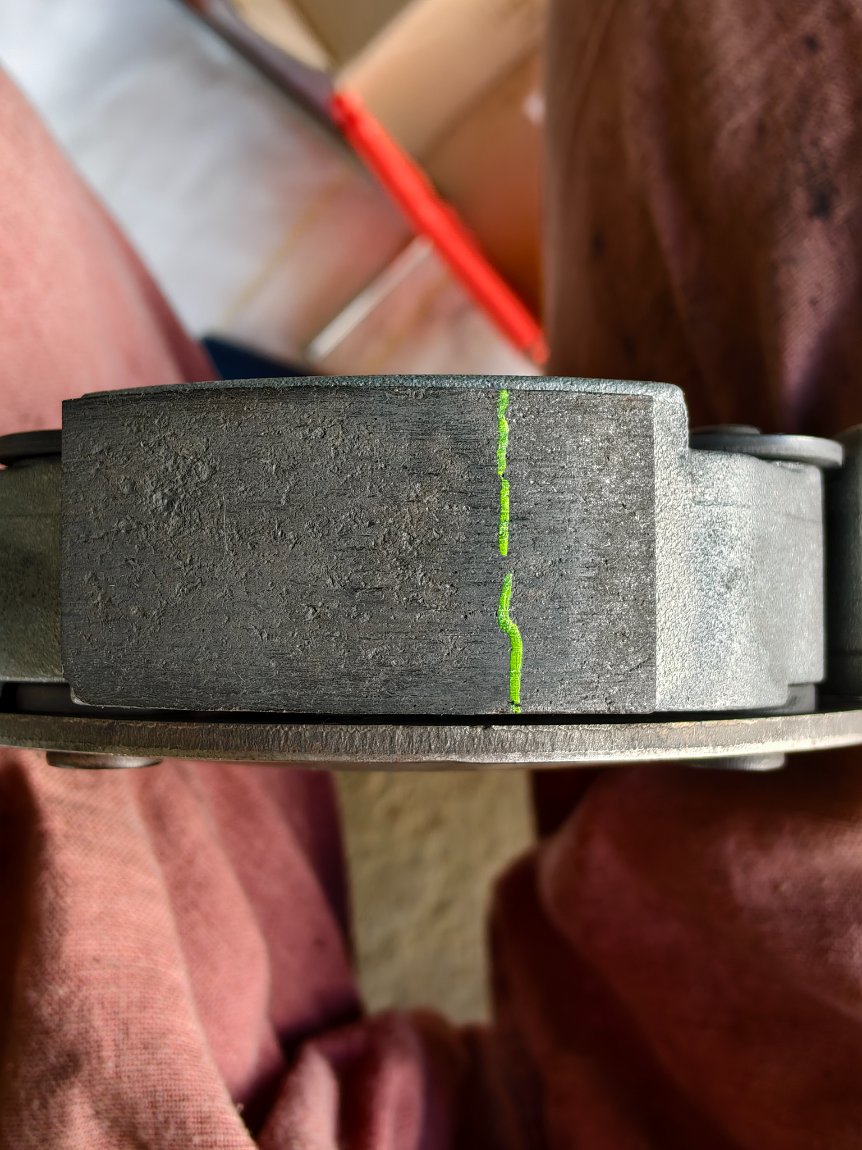

12,000km have been ridden since my previous full transmission service.
On this occasion I am dismantling and cleaning everything, blowing out clouds of dust from rollers, belt and clutch wear. I do the blow out at the local self service car wash, in between other customers so as not to piss them off. Back home I have a much cleaner transmission to work on and I feel it keeps thing sweet with my landlord.
I am replacing the Malossi rollers and sliders as a full set. Although just two rollers with a very slight flat spot and the sliders showed minimal wear.

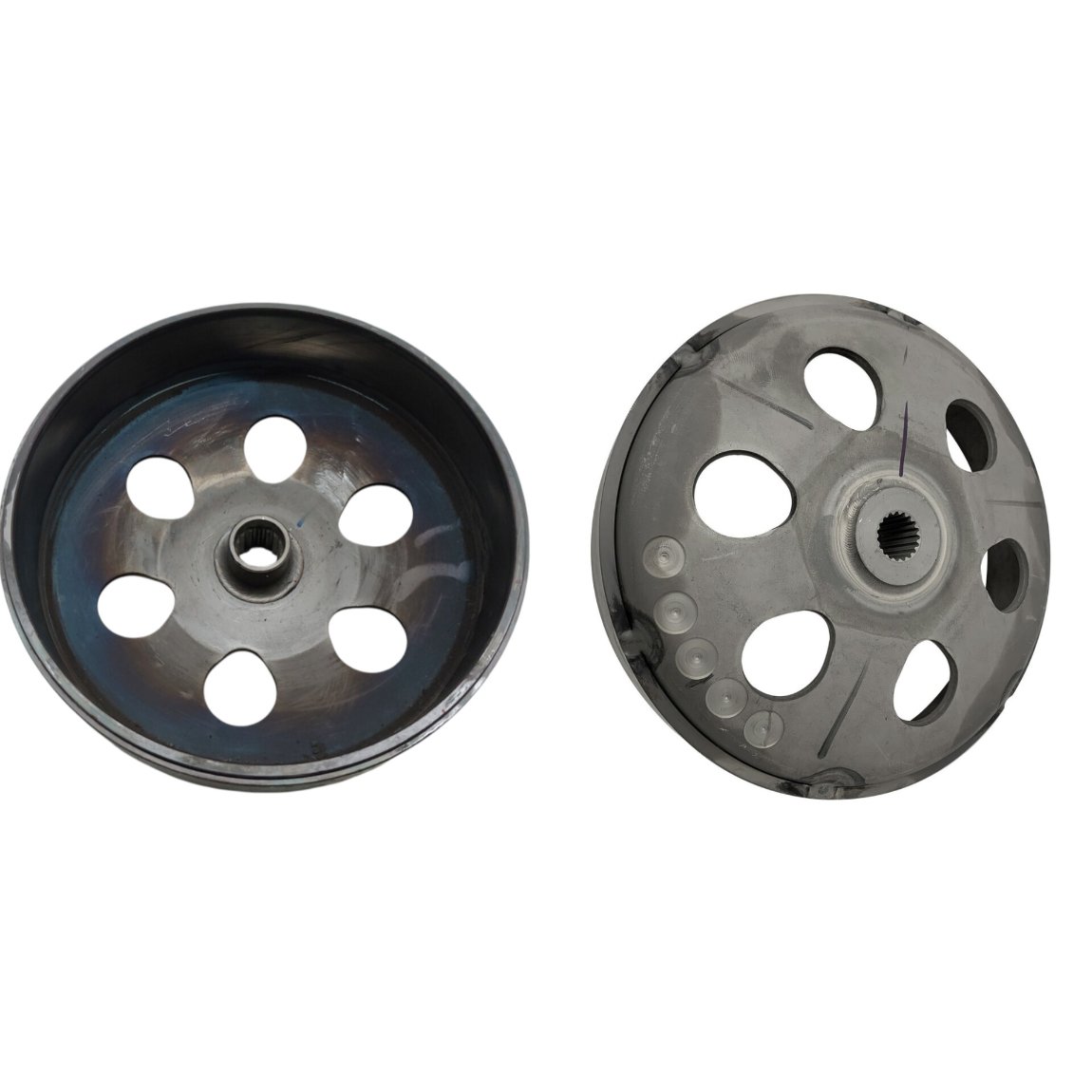

The clutch and bell, which has now been in use for 32,000km will also be swapped out for a new Malossi set.

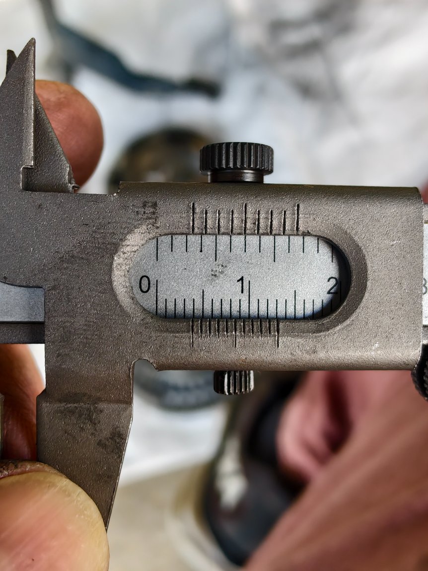

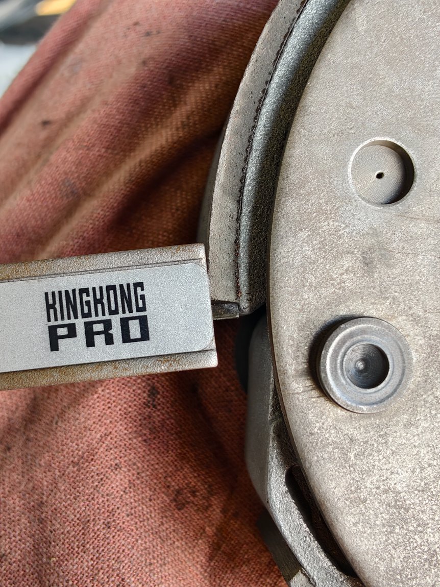

The worn clutch thickness of the trailing edge of the friction material is a fraction under 4mm. Versus new clutch thickness 5mm.
I intend a very through clean up of the old clutch, especially shoe hinges. Hopefully after cleaning up I can put the old clutch back on the parts shelf for reuse, as its only 1mm friction material wear over 32,000km traveled.
In the photo below the friction material still has some unused surface on the leading edge of the shoe. (Area to right of green fluromarker line).
Malossi clutch bell has minimal wear, but I'll swap it out with a new one as the clutch can only be purchased in a complete kit set, so might as well.
(The older clutch is the blued one).
Okay, on with the service.

I snagged a pair of Profender X shock (445mm standard length) on a Shopee sale for ฿10,300 delivered.
I wil fit them myself. I had the same shock on my first ADV350 and really liked them. Supply and fit price from a workshop was ฿13,900.
I haven't got a second quote for the Ohlins rebuild yet, from the Ohlins service centre in Chiang Mai. I'll do this at my leisure.

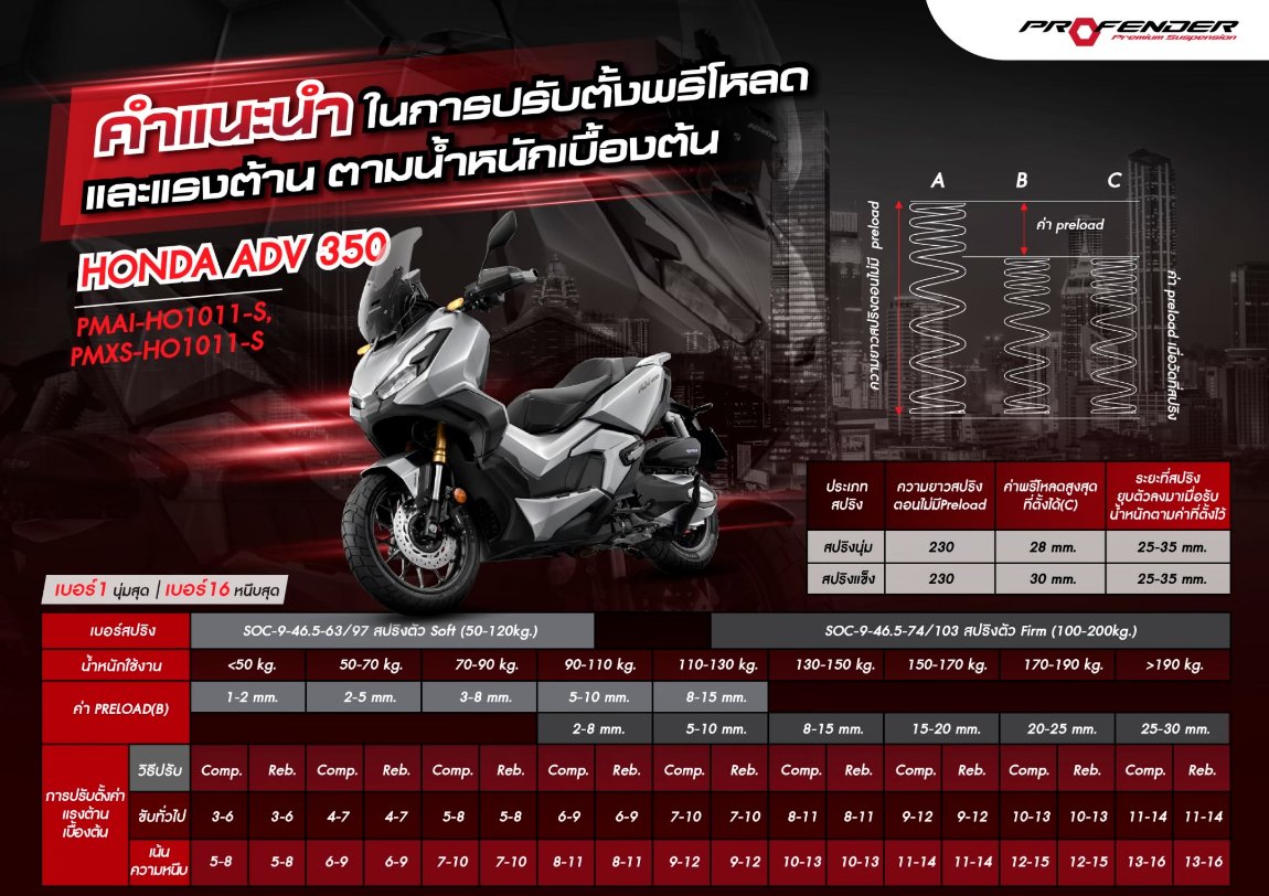

Profender have a reasonable set-up guide. I'm going to try the firm spring this time around because with riding gear, fuel, top box/rack and a change clothes I'm just at the start of the firm spring (lowest weight guide 90-200kg).
....and the following link opens Profender's company Google Drive location to download the official installation and sag guide.
Reactions: Heineken
Wow, what a difference fresh shocks make...ride and handling is superb on the firm spring and 5mm preload matched with YSS fork upgrade and 10W fork oil I'm well impressed (again with Profender).

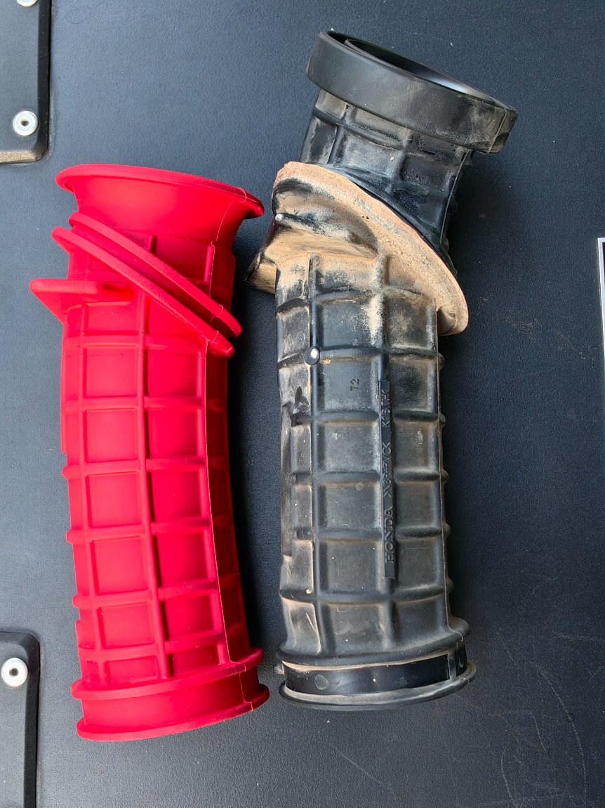

For the fun of it I also fitted a Malossi intake pipe, giving a more direct airflow into the engine from the BMC air filter.

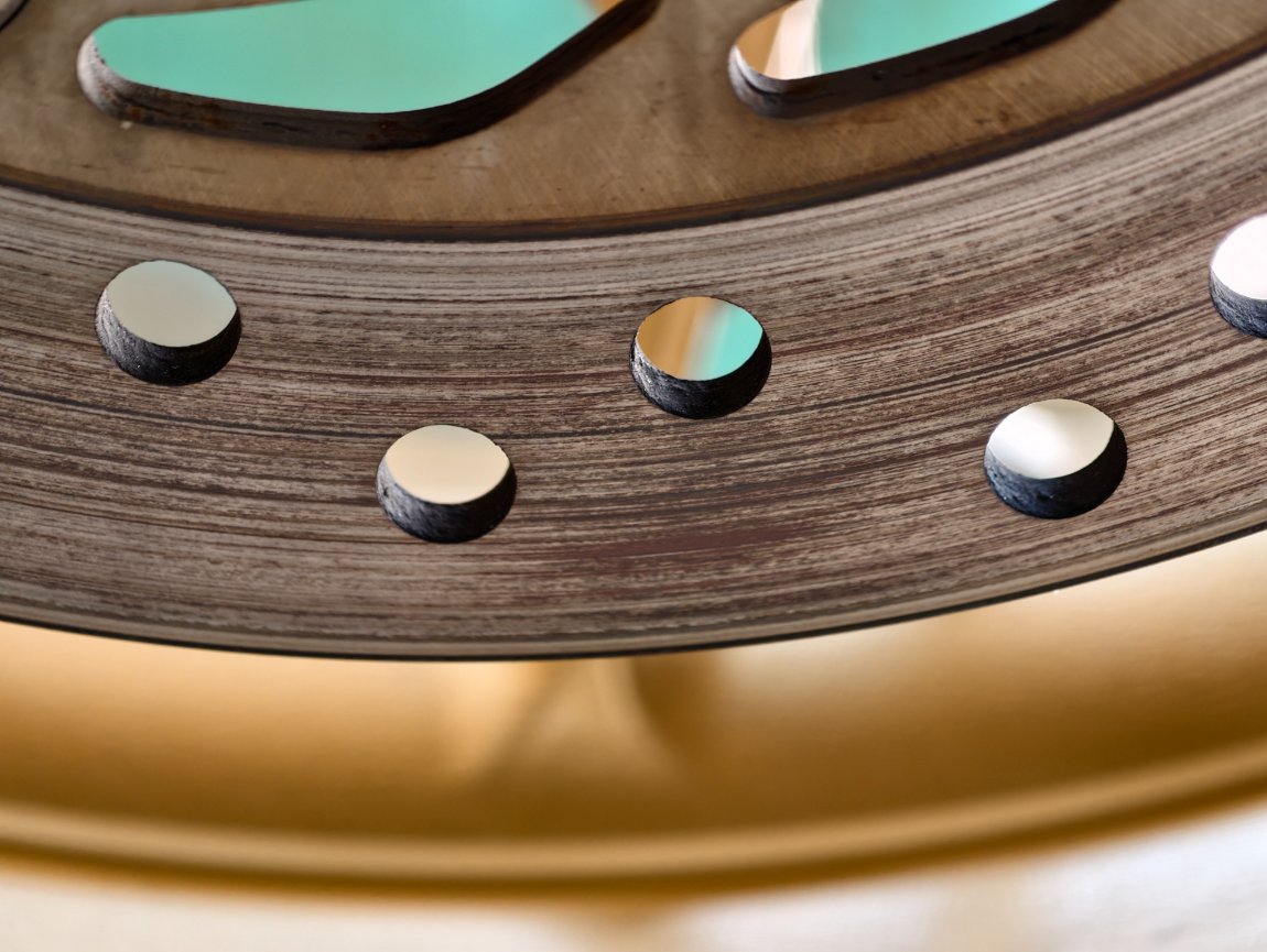

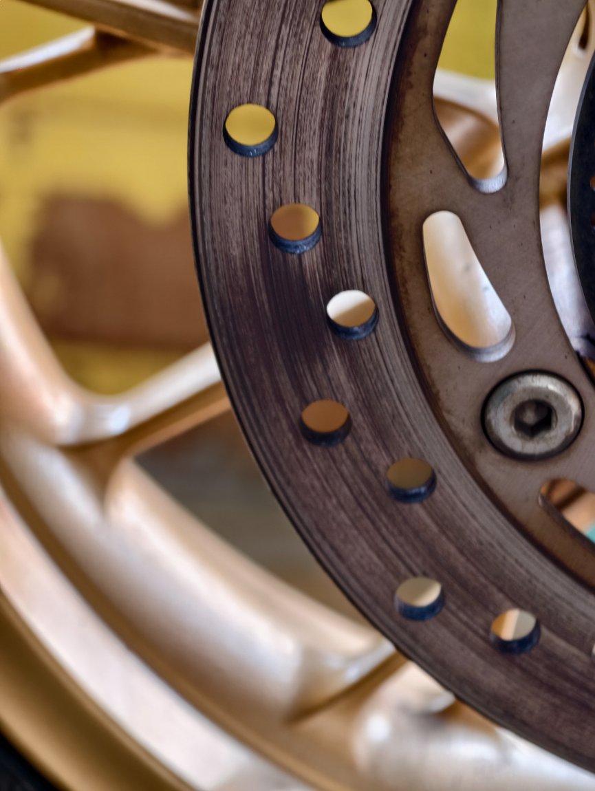

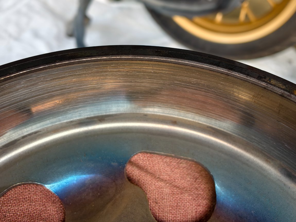

44,000km on these front discs.
Just beginning to developed some visual hot spots. Also I can feel the brake ever so slightly juddering. I am thinking this will be a combo of brake pad retaining pin wear and disc wear, pad material oxidation build up on the hot spots.
I could try using emery paper to reduce any oxidation from pad material build-up on the disc itself. However, seeing that the disc thickness is heading towards minimum disc thickness, I'll stock up to replace the discs.
Lazada / Shopee 3.3 (3 March) sale approaching so I intend to purchase new front/rear disc (฿800 each and parts to rebuild the callipers (other than pistons/piston seals which are in good condition).
The hotspot discolouration can be seen in these two front disc photos.
@ 6 o'clock
@8 o'clock

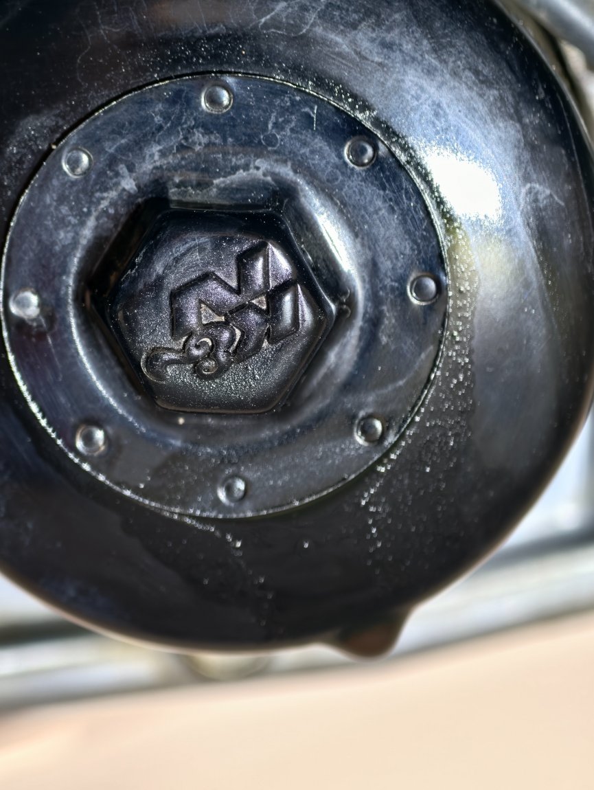

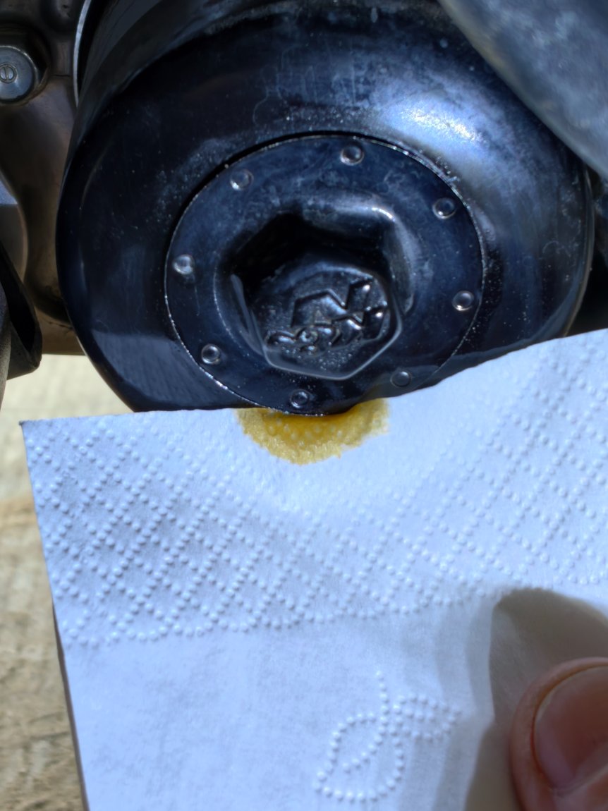

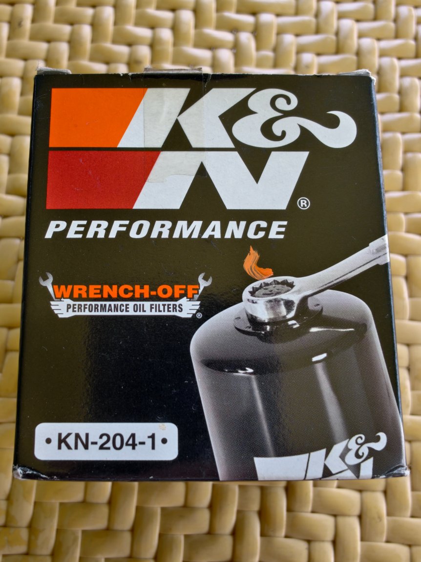

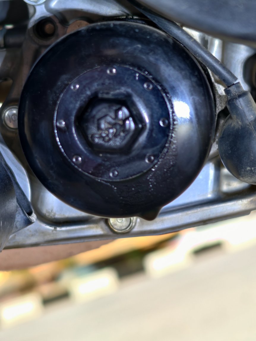

K&N oil filter failure, leaking oil.
So, I always had a good opinion of K&N oil filters over very many years of use.
However, I've now had 2 out of three K&N 204-1 filters fail and leak oil over the back tyre.
The point if failure is the spotwelding on the flange bolt. Seems like K&N cannot get effective quality control together.
Checking the web for this issue K&N oil filters have been failing at the spot welds for many years. Significant number of reports of same issue.
I will never trust another K&N oil filter.
The first K&N 204-1 failed at 1000km and the second failed at 4500km. Both filters were hand tightened.
I did not use a spanner or socket on the flange bolt spot welded on the end of the K&N 204-1 oil filter other than for removal.
The first K&N 204-1 oil leak was a dangerous dump of oil over the rear tyre in mountain twisties. I managed to find a Honda shop in Fang for a pitstop, after coming down off the Doi Ang Khan > Chiang Dao loop.
The second K&N 204-1 filter started leaking at the spot welds, onto the clean concrete floor with a splattering on the rear rim /tyre, so I saw and caught that one very quickly.
I've binned my remaining unused K&N 204-1 filters. No confidence whatsoever in K&N quality control.
