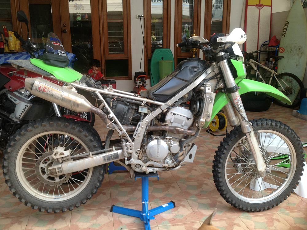

    3 gallon IMS tank on KLX!
    Decided the stock 2 gallon (7.7 liter) stock tank on the KLX just isn't going to cut it for touring so ordered a 3 gallon (11.3 liter) IMS tank from http://www.justgastanks.com/
    My bike has a Bill Blue 351 cc Big Bore kit which is paired with a Mikuni TM 33 8012, flat-slide, pumper carb. The FI and fuel pump have been removed.
    Pretty quick shipping but they ignored my request to declare cost price on the customs form so I got charged quite a bit of duty. Oh well, win some, lose some.
    Swapping tanks is super easy-
    IMSTankKLX351asm.
    Forgive the filthy bike :lol:

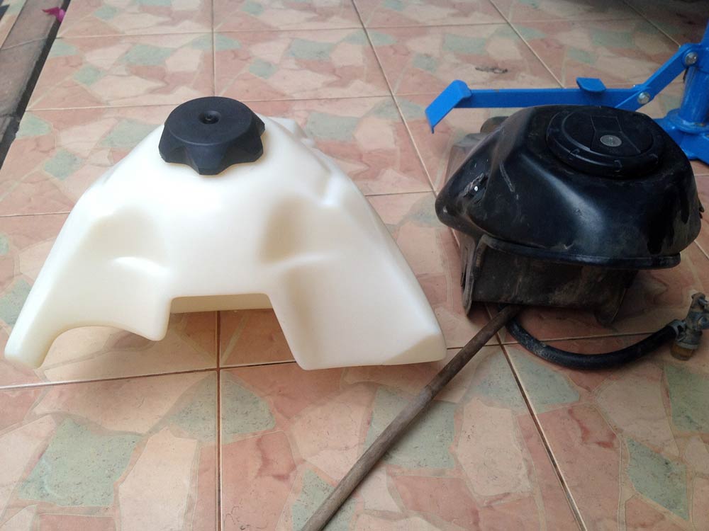

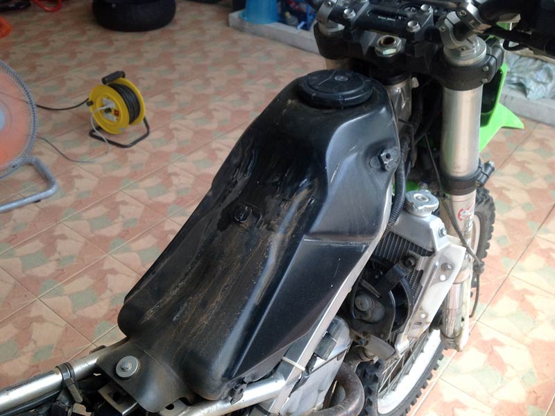

    Stock tank is tiny- only holds 7.7 liters of fuel.
    IMSTankKLX351csm.
    Stock next to IMS. Cool thing is the plastic 3 gallon IMS doesn't weigh any more than the 2 gallon metal stock tank.

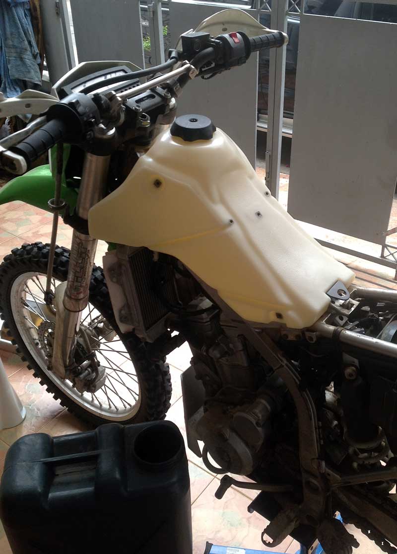

    IMSTankKLX351dsm.
    Another view.
    IMSTankKLX351esm.
    Installation is a breeze- the IMS fits perfectly and does not interfere with the carb or choke. One little hiccup- the IMS tank uses the fuel fittings from the stock tank, but it's made for the carb'd bike which has a different fuel tank, so I had to scrounge around Red Baron's used parts warehouse where I was lucky enough to find the tank fittings I needed.
