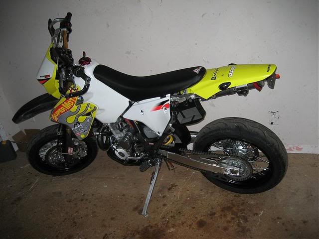

Safari 17 liters(4.35 gal):

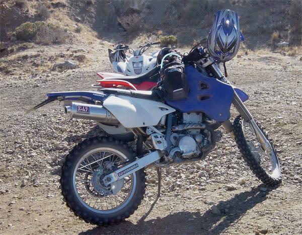

Clarke 3.9 gal:

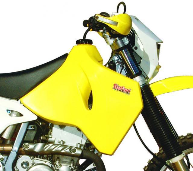

IMS 3.2 gal:

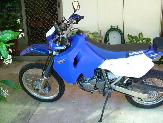

IMS over 4 gal:
