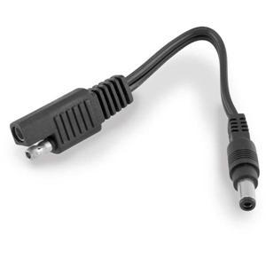

You may have to instal a plug so you can do it. That will be the trick part finding a male/female SAE plug which is the best type. Like the left hand one of these
