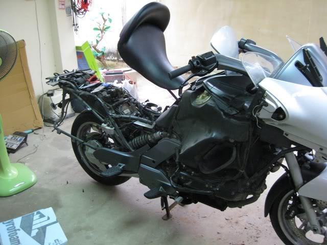

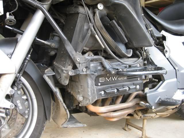

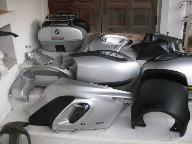

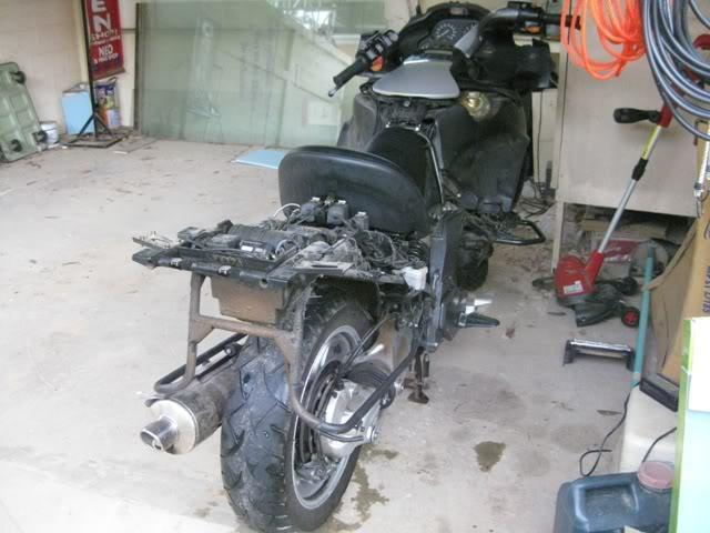

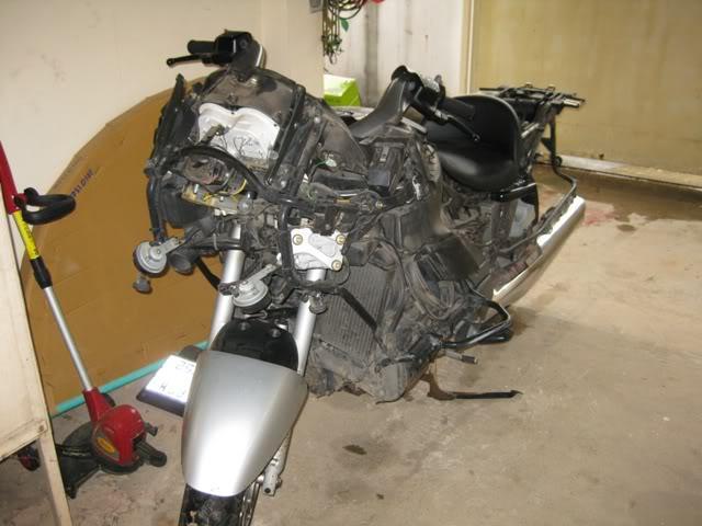

If you ever wonder how LT will look inside, here is total strip down
as i prepare her to Clutch repair and additional modifications
Well here you are and now you knw,, it's look darn UGLY
So what is on the mod list is by so far
New Head lights HID 5000K low beam and 6000K high
Police siren and flash lights
12v air compressor and 2 outlets where air can be given to every one and i can fill in my own tyres as well.
Reverse gear activated parking censor and display distance meter
and some additional lights
This should take about 1month to do.
Some kind of paint job as well.
but will keep you guys posted :wink:

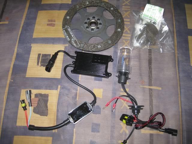

Hi Azoulay
I ordered HID from USA DDM turning, they are made for beemer and plug&Play 45US+Shipping 32, fare deal
http://www.ddmtuning.com/index.php?pcsid=tga2i87oum0ekefpdqirsh8mi7&p=catalog&parent=61&pg=1
Slim 55W ballast
Police siren from Local car spare shop 600THB
Police flash lights from Ebay (HK) 10USD+12USD shipping
under the bike show lights, from Ebay 25US+25US shipping
Air comp ordered from Ebay 45US+Shipping 25US, that needed modifications and will provide picturial when actual installation will take place.
All these bit's, will not effect in any electrical circut as they are working from they own electrical and fuced box

Nice to hear from you and it's like you read my mind...
In the plastic bag is Slave cylinder and all bit's needed for that and i saw in your picture that you had "weep hole also drilled,,i dont have that yet,but it's on working list.
I also have seals for rear end "pinion seal, Gear seal and Rear Transmission Seal

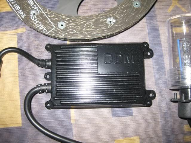

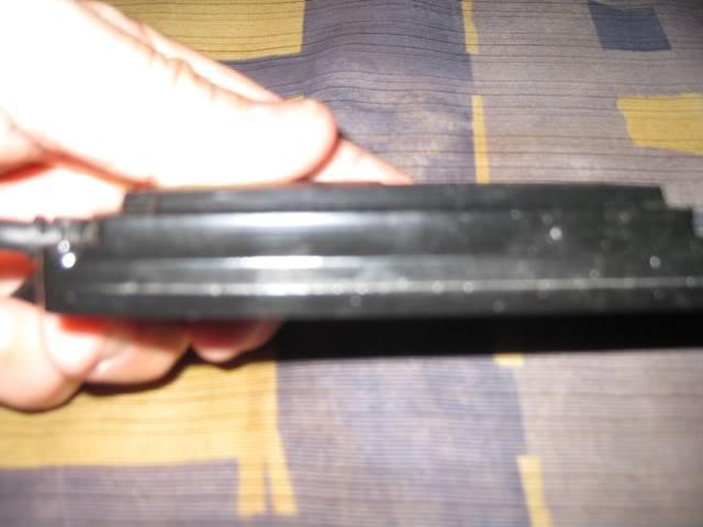

almost forgot this is picture of HID 5000K H7 and other is H3
Slim 55W ballast from DDM Turning
