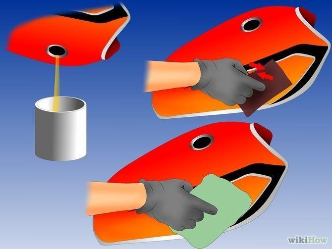

    • 670px-Seal-a-Plastic-Gas-Tank-Step-1.
      Drain the gasoline from the tank and allow it to dry. Sand the area around the hole or crack, and clean the area with a shop cloth saturated with rubbing alcohol. Ad

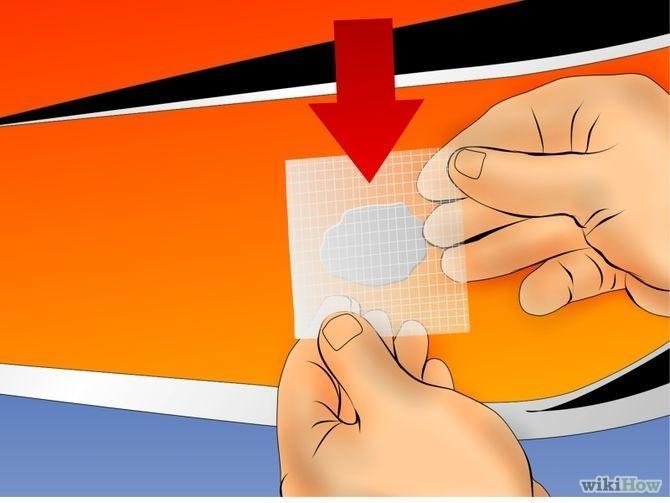

      Mix the 2 part epoxy together and apply all around the perimeter of the opening. Cut a fiberglass patch large enough to cover the opening and overlap it.
    • 670px-Seal-a-Plastic-Gas-Tank-Step-3.
      Place the fiberglass patch over the hole and press into the epoxy. Apply more epoxy to the patch and surrounding area, pressing firmly to saturate the patch.
