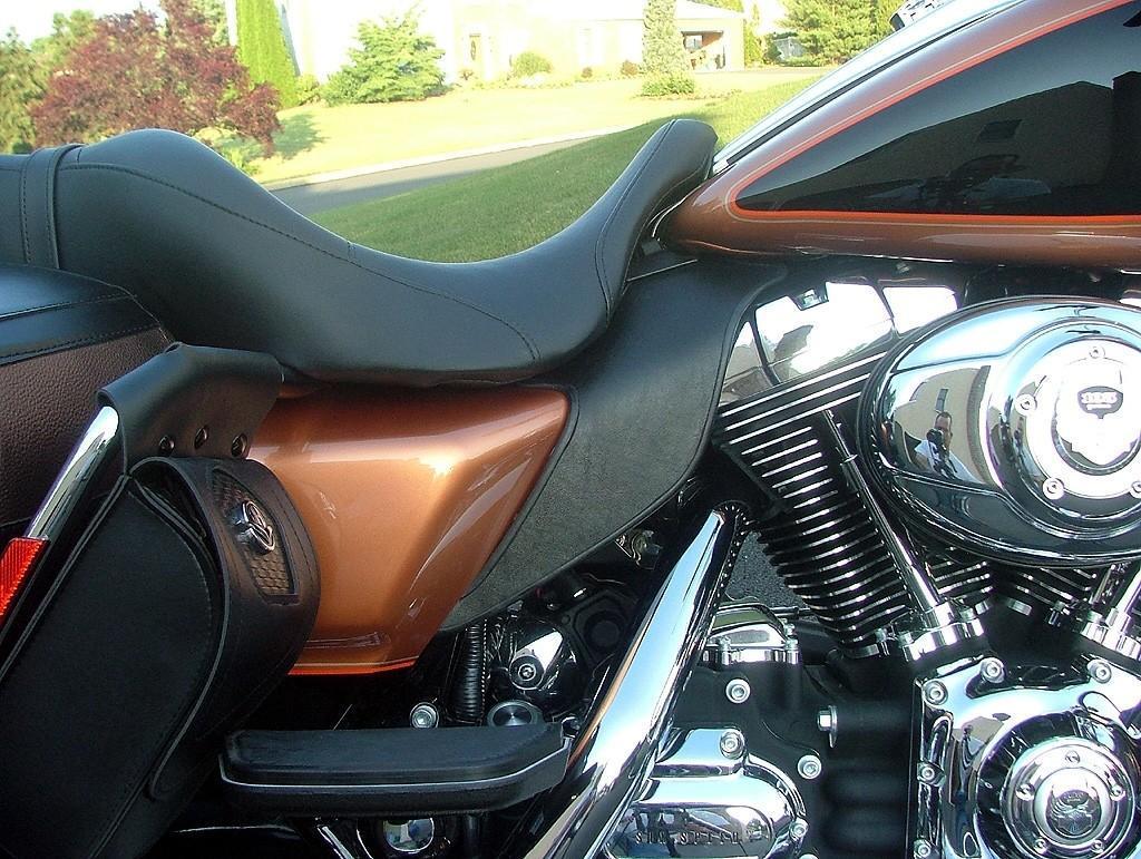

Ok added the oil cooler and the Mo Cool, bike is running cooler. But, it did not solve my problem finally hit me my legs are only 4 inches from the rear cylinder, The area where I have a problem now. The bike only heats up enough for the fan to come on if I, leave idling at light.
I guess one option would be to put a switch on the fan.
The other would be to make up a trim kit to direct the heat from the clyinder down and back. I was thinking of tow pieces of fiberglasss with insulation in between
Any thoughts?
