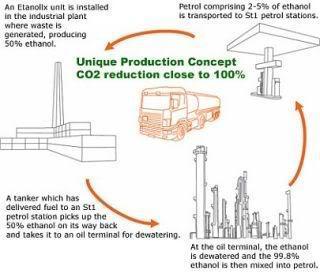

What St1 Bio fuels now offers is a way for food processing factories and a likes to get rid of their waste at a lower cost by providing a small scale Ethanol factory to the premises were the waste is. The ethanol manufacturing unit is a small modul unit, where the moduls are a mass produced standard parts and by adding more moduls the capacity can be increased to suit any sized food processing company. This method makes ethanol production profitable even on a small scale.
These small ethanol factories are unmanned and controlled by a remote control room. No employees are needed at the ethanol factory.
The chemical process is based on a fermentation process associated with an evaporation process producing an ethanol/water concentration of 50%-85% at a plant installed in the place of origin of the waste. By-products include water, solid waste and a liquid which can be used in soil conditioning, for example. Depending on the raw materials used, other by-products are suitable for use as animal feed, fertilizer, or feedstock for anaerobic digestion.
The ethanol mixture is then transported to St1’s dehydration units, where it will be refined to a purity of 99.8%, mixed into the fuel and distributed to the petrol stations. The transports from the ethanol units to the dehydration stations are handled by the empty gasoline tank trucks going back to pick up new loads of gasoline, thus not causing any new environmental load.
The amount of carbon dioxide that is released into the atmosphere during the production process has been minimized by generating the energy needed for running the process using heat from the “mother factory’s" industrial installations or renewable sources of .In logistics they take, as already told , advantage of the empty tankers returning after having refilled the petrol stations.

To visualize the concept I post some promotion pictures I found
