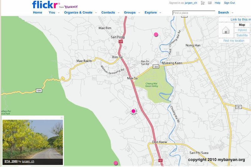

Geotagging pictures.
This post only describes the technical process of adding GPS information to pictures. The benefits and possible applications are formally not part of this thread. However, I will give examples, in later posts, for people wondering what the fuss is about.
The “Wintec WPL-2000 ” gadget easily fulfilled the first part of my basic “localization” requirements. The tracking task (of my motorcycle tours) was “plug and play” and it generated maps automatically (see my earlier posts).
The tracks included the specific “waypoints” recorded to remember important photo taking locations. This feature covers the main part of my needs and, at that stage, does not involve a camera. Any interesting neighborhood can be precisely pinpointed with a “waypoint”, even without taking a picture.
However, geotagging pictures was also one my requirements list. The operation consist in adding the latitude and longitude coordinates in the Exif metadata of a picture. If the camera is not linked to a GPS unit during shooting, it must be post processed. This tagging can be done manually, if the waypoints coordinates are available, or if the localization is defined on a map (it needs a specific software). This is a burden.
The software, included on the “Wintec WPL-2000 ” stick (nothing to install), does the geotagging operation automatically. It does not need specific waypoints (these are only markers for the maps) and will deduce the coordinates from the registered track points. The only condition is to synchronize the camera's clock with the WPL-200. It is straightforward and pictures are backed up before the changes. In addition, "WPL-2000" can generate maps with the pictures and save informations to be viewed in otehr sites or softwares.
Example of a map with pictures generated by WPL-2000:
Unfortunately, I was unable to run the picture tagging process with “Wintec WPL-2000 ” in Ubuntu (Linux). A work around might exist but I have not yet found it. Softwares like "Geotag" might have the trick. In the meantime … I use a Windows box for this operation :geek1:

Picture « geotagging » - Just a buzz ?
In earlier posts, I described my basic needs for « tracking motorcycle trips » and « pictures geotagging » . The “Wintech WPL-2000” tool was « plug and play » and straight forward in fulfilling both wishes. Being able to automatically rebuild an itinerary, on a Google or other mapping site, has an obvious interest. The task to add localization information in the meta data of pictures, also worked well. However, once information are added to a couple of photos, the question might be: « so what ».
I would need more space, time and knowledge to give a comprehensive answer to that question. In addition the technique of geotagging pictures is quite new and still in development. Software like Picasa recently added this feature. With the development of mapping sites and tools for writing and reading coordinates, the number of applications will increase, particularly if the process is nearly transparent for the user.
Some benefits are already clear:
- pinpointing the localization of a picture (without having to memorize the data)
- sharing photos and allowing others to localize the proper spots
- filing and retrieving pictures based on their geographic data
- uploading images on maps (for commercial and non commercial applications)
- searching pictures on the Internet, based on coordinates (image search engine)
Geotagging pictures with the “Wintech WPL-2000” is an extra operation to my usual pictures work flow. I will thus limit the data inclusion to non obvious places and to some “reference” pictures, in each topic folder. Pictures to be shared and uploaded on maps will also be tagged. As long as the original GPS tracklogs are saved, the process of automatically writing the latitude and longitude as Exif information can be postponed, to whenever needed.
In Picasa 3, pictures with Exif coordinates are marked with a cross-hair symbols and viewed directly in Google Earth (1).
On the popular photo-sharing site Flickr, the existence of localization data is signaled by the word « map ». A single click allows to see the picture in his environment. An additional click provides a larger map view.
Many softwares can generate KMZ/KML Google earth and Google maps files (including one or several pictures). These files are easily shared as they open in Google Earth (this is also working under Ubuntu Linux).
(1) Unfortunately, Picassa 3 for Linux has geotagging still grayed out. Writing and viewing localization metadata with this software requires a Windows box. I have not tested Mac OS.
