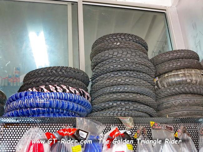

A tire that is available over here for the same price and provides much better grip both in the dry dirt and pavement is the "Quick" tire. Here's a pic of the rear tire.
They are a copy of a Dunlop MX tire and last quite well. I used one offroad from the Cardamom mountains in southern Cambodia and it lasted all the way to Vientienne Laos. They won't grip quite as well as the IRC in the wet hard pack clay but everywhere else they outperform the IRC in my eyes. These Quick tires can be found in Thailand ( and hopefully Cambo for you Bill) for quite cheap and for the price are the best things I have tried.
Best of luck.
Edit: They also produce a front tire that has the same characteristics as the rear.

Got a contact in Thailand for the "Quick" tyres (tires?)

Haven't seen the Quick brand yet in Cambodia but will keep an eye out for them.
