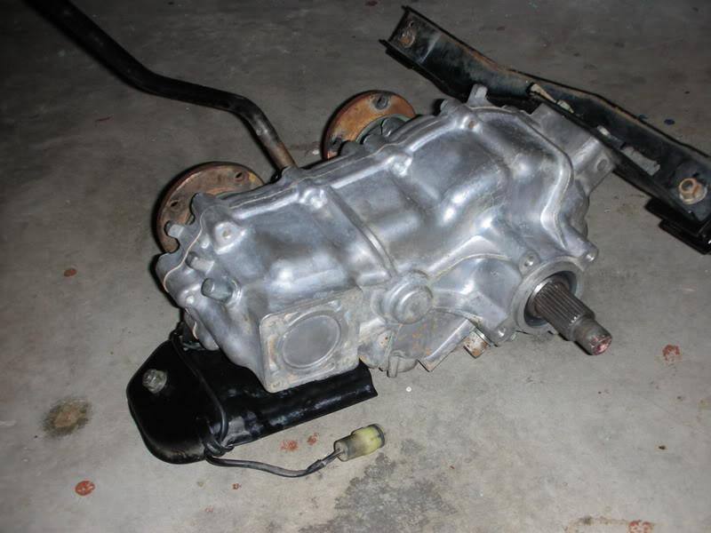

Well, The car is coming along fine. Taking a bit longer than I expected though! Serviced the transfer box with new seals and all new universal joints in the drive shafts.
It's all the little details that take time... Cleaning, painting and replacing all the perished or worn bits. Engine/Gearbox mounts, doors seals etc. Patched up the 2 rust holes.

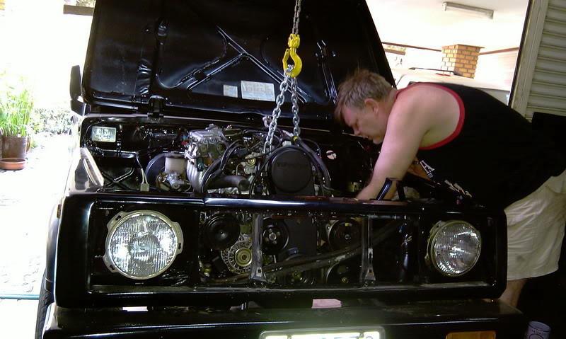

Before the engine went in gave it a service and fitted a new timing belt as a precaution. Engine is in and runs great...Lots of little things to tidy up but the main install done.

Hi Trev,
I put the Same Engine in My Caribbean and Goes Like Hell! Trouble is the Rough Ride and Shitty Steering!!! Good Springs and Shocks could fix the Ride but not sure How to make the Steering better??? I would love to take a look at Yours once you have it finished Come over and Show Me?

Hi Ian,
I'm really impressed with the engine too. Luckily my gearbox is in very good condition, so with the new shifter sheet etc. it drives like a new car!

Hi Franz,
I fitted a fuel injected 1.6l 16 valve engine ( Japan import ) that's the same as used in the Suzuki Vitara. The stock 1.3l 8 valve is meant to put out 64 HP and the new engine is rated at 99 HP. Nice boost of power and from other reports should be more economical too...A lot of fun to drive, car can now go up hills and overtake safely! The hardest part of the swap is the wiring for the new engine.
