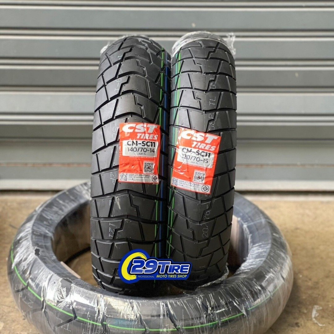

So a little follow up on the tire debacle. I was in contact with RE a few times over Line the last couple of days and after stalling an answer several times they said tires might come in on the 8th. And now it's changed to arriving in Thailand on the 8th, but only arriving at their dealership after 11-12 days most likely. So I gave up on them and called with 29tire again. They said they will have Matis 07 tires coming in on Saturday morning and they will be able to fit tires on my bike in the afternoon, confirmed. The only thing is that they don't have the 120/90 17 rear tire but only the 130-80 / 17. This is not really an issue so I'll just go with that. They seemed to be aware of the Himalayan issue and mentioned they have changed these tires on all Himalayan bikes so far. OK, let's hope so. Set of tires 7,100 THB. Fingers crossed no other hiccups will come up in the meantime.

So today I got the tires changed. 29tire didn't tell me they were going to mix the E07 and E07+. I called them three times and they never informed me that they only had the rear tire in E07+ even though I explicitly asked about it. So we go ahead, get it changed and find out afterwards that they put an E07 on the front and an E07+ at the rear. I'm not happy with the set up now but I guess it is what it is. I've read some people mix them in the same way and people seem to have varying experiences with it. They said they can change it back but crap we already waited 2,5 hrs because they forgot to tell us that the automatic tire lifter was broken and alternatives are not available. Don't know but not a place I'll go back again, disappointed.

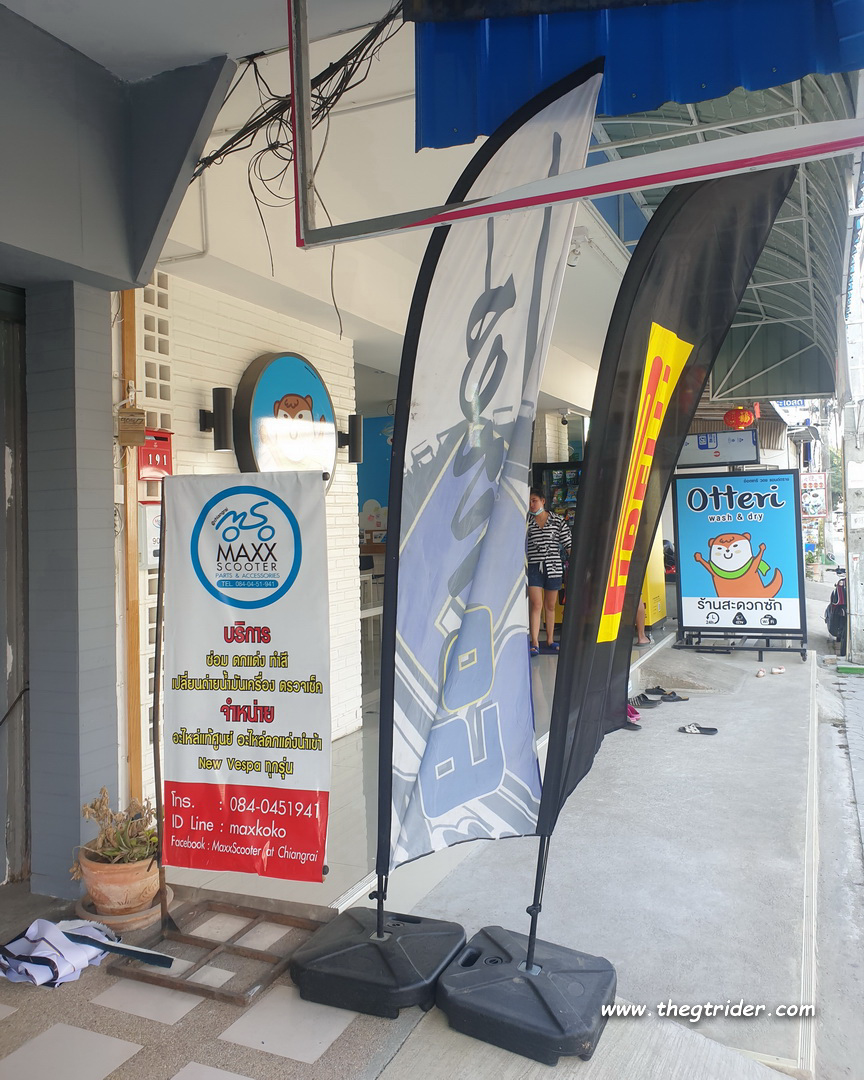

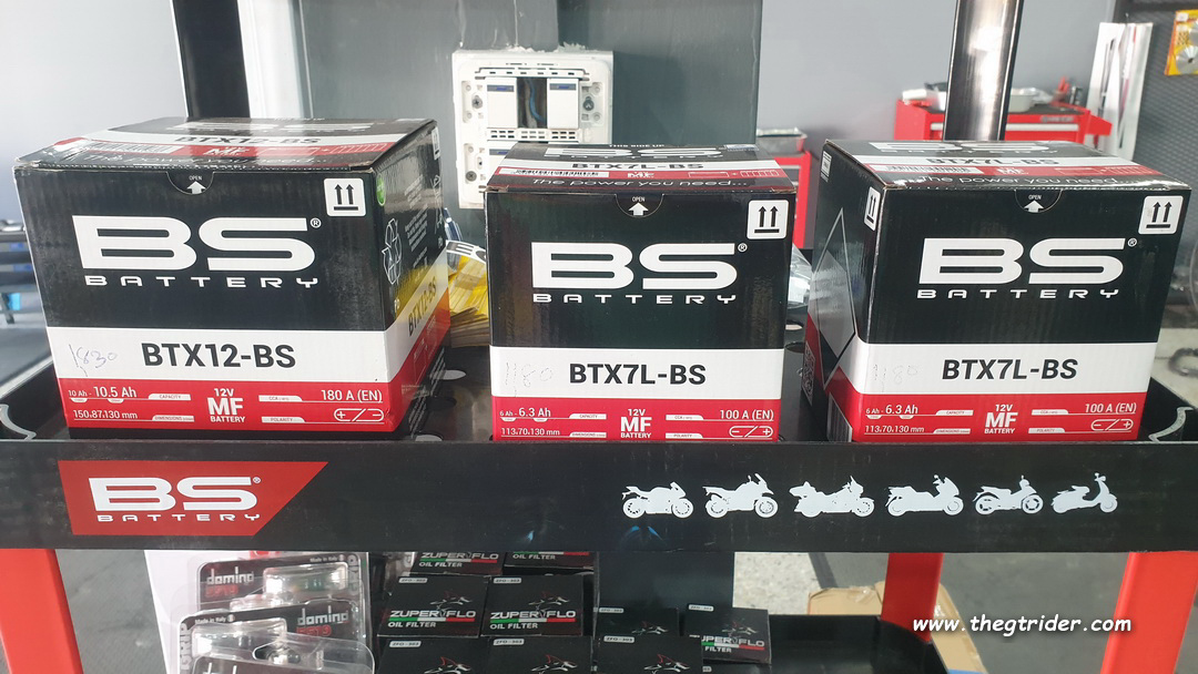

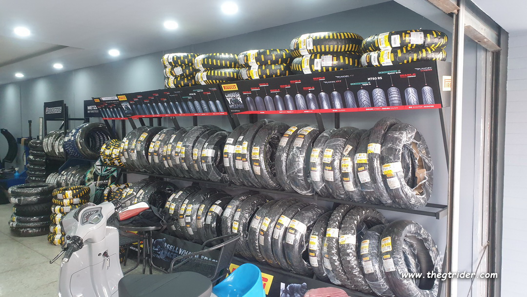

69 Tyres (Maxx Scooter) has opened a branch in Chiang Rai, directly opposite Honda Big Wing
They have a small range of accessories and batteries.
Location: Max Scooter 69 Tyres
