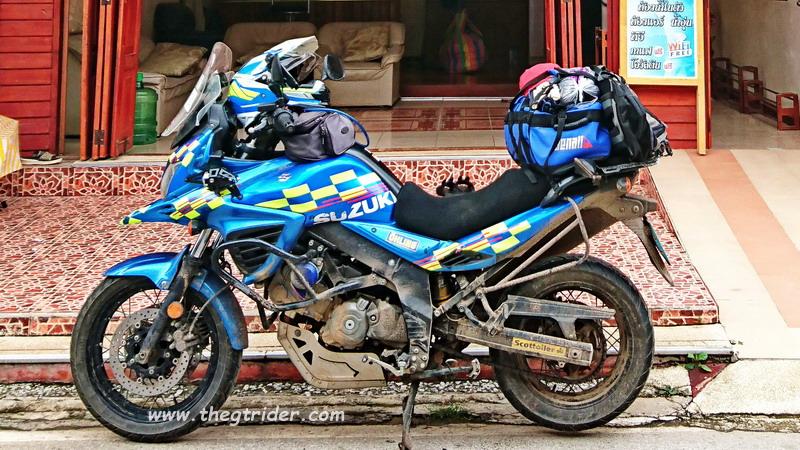

On my recent trip Chiang Khong - Vientiane return I was somewhat over loaded coming back, such that I needed to buy another bag & reposition the load on my bike.

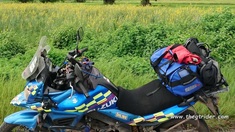

The main bag, the Denali that carried the goodies & the heavy load was placed on the seat so the weight was not too far behind the rear axle.
Then I bought a nice rucksack for 500 baht, put it on the back with the dirty clothes, spare shoes & the 2 cans of chain lube.
How it looked after 2 days on the road
A rear end view
it was here that I readjusted the load, pulling the bag a bit more to the left to have it centred properly.

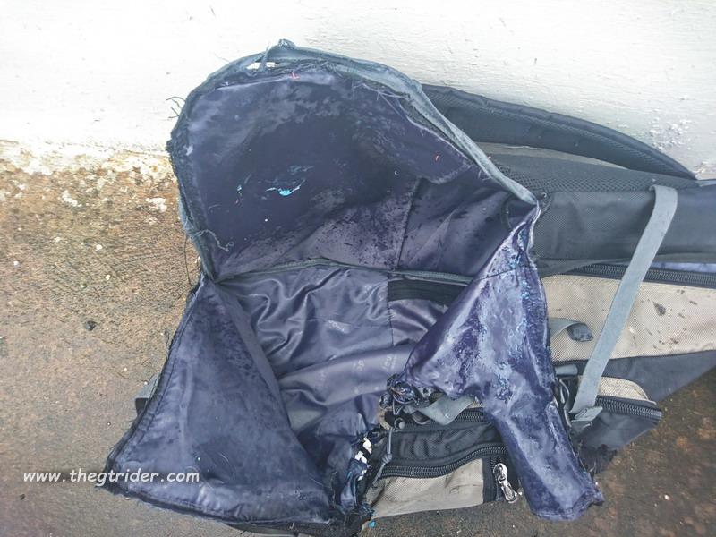

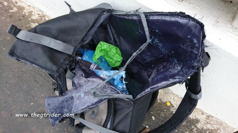

I parked up & walked back to my debris laying on the road. Shirt socks jocks, shoes & a back pack blown apart!
Bloody hell. The chain lube cans must have exploded!

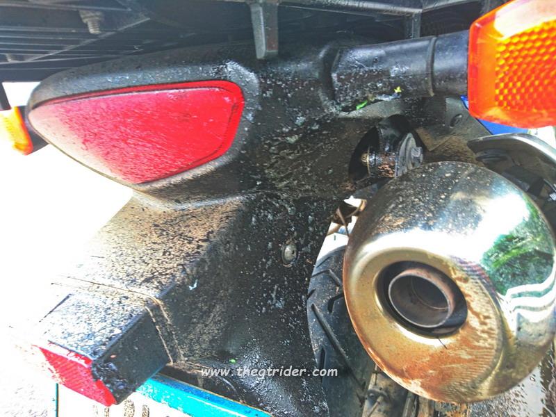

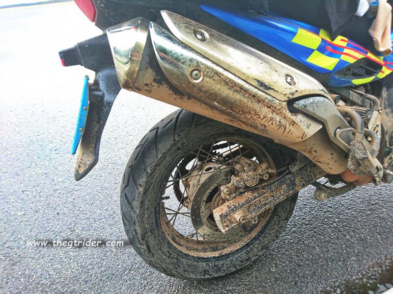

A look over the exhaust & tail of the bike
What a mess.

Well I guess the pocket that the chain lube was placed in just happened to be straight over the exhaust that day & it got too hot - caught fire and kaboom.

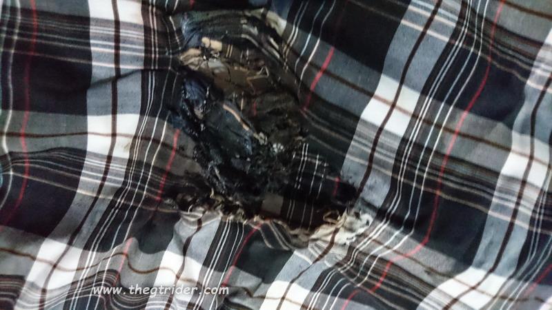

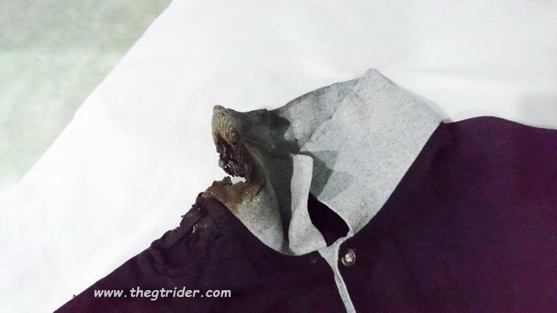

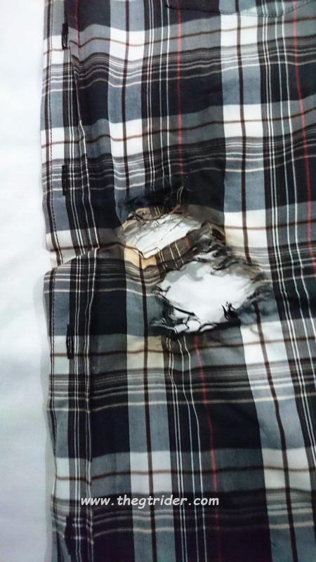

Two items of burned clothes.

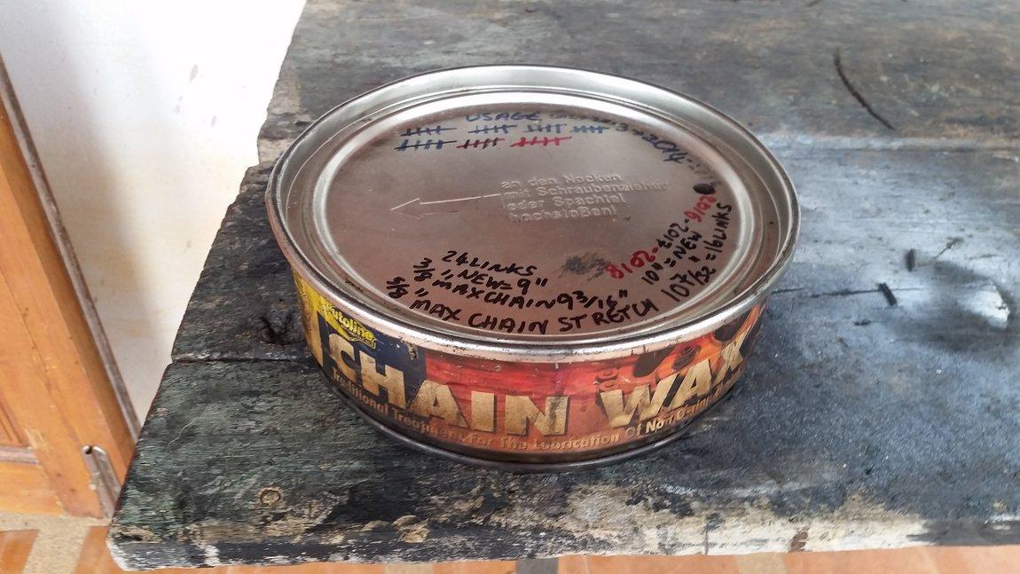

My Putoline chain wax has been used 35 times in 6 years now. It should last another 15 times. It cost 25 GB pounds and another 25 GB pounds postage. 50 quid a tin and 50 uses sounds cheap. Then there will be 1/2" left, to go in the next tin, so that should be cheaper still.

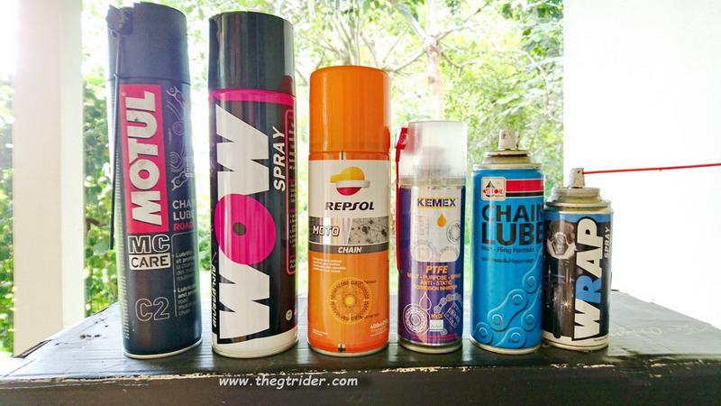

Working my way through a few more lubes
The Kemex is supposed to be a teflon lube?
Haven't tried the Wow yet.
The Repsol disappointed.
Motul is still tops at this stage of the game.

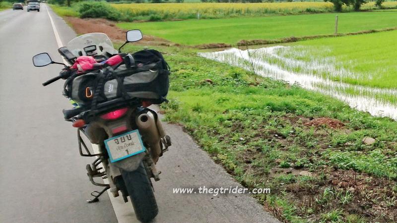

I had a similarly exciting experience on the way to the Dan Sai "Phi Ta Khon" Festival. After David's experience, I thought that learning from it was a sensible move. My chain lube has been standing upright in the back corner of the faux leather saddlebags for 18 months / 29,000 kms - but as far from the exhaust as possible. Mainly because that's the bag my my "One-armed Stand-it" bike stand sits in...
Aside from the great mirth engendered in the mental spectacle of David's shirts and underwear being blown sky-high into the air above the highway, and raining down in his wake...It did serve as a warning to others! I bought a tool bag for the front forks and began storing the chain lube there as a precaution.
But then... the day before heading to Chiang Mai for a night, and Dan Sai the following morning... I prepped the bike and lubricated the chain. The can was almost done - maybe one shot left in it. I decided to toss it in the saddlebag and empty it the next morning before leaving Chiang Mai.
About 65 kms out from home, just east of the turn-off to the Mae Tho National Park, there's a nice uphill section... I was in the zone! Passed a car after the first left hander on a short straight before the next right-hander. Full throttle, third gear. Into 4th on the exit to the corner and full noise/max revs up the next section. Just as I had to ease off for the tight right-hand corner there was a massive "Kabooom!" behind me... As in a 12 gauge shotgun kind of bang right, a foot behind me. Not a tremor from the bike, no change in engine tempo, no vibration nothing at all... my first thought was a backfire but I've never heard one like that before! 5555
Unlike David, I could not look in the mirror because I was already cranked over navigating through the corner. There was a guy leaning on the guardrail at the exit to the corner with a visibly startled look on his face...

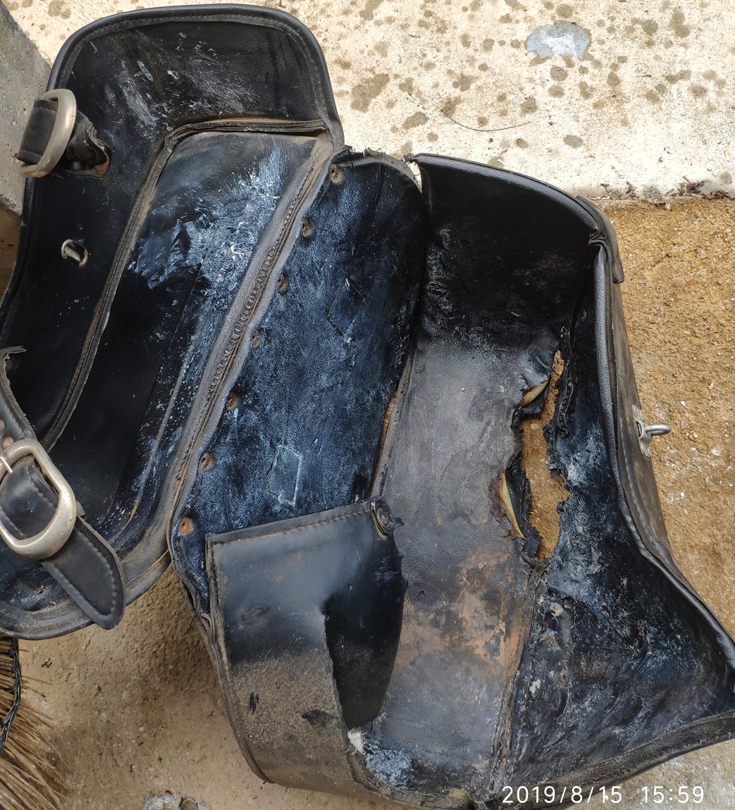

I stopped a couple of hundred metres further on and got off the bike to see if there was anything obvious - and then I saw the ragged tears in the right saddlebag and knew instantly what had happened! I did a quick U-turn and scooted back down the hill to see my shoes, umbrella and sundry other items of kit scattered along the centre line. Gathering up my gear, I reallocated items to different locations, tied up the saddlebag with a spare bungy cord and carried on.
Chain Lube: WD-40 Specialist "White Lithium"
When it explodes, there is obviously;
  • a tremendous amount of pressure, judging by the way PU leather was shredded
  • and heat, judging by the melted sections in the base of the bag
