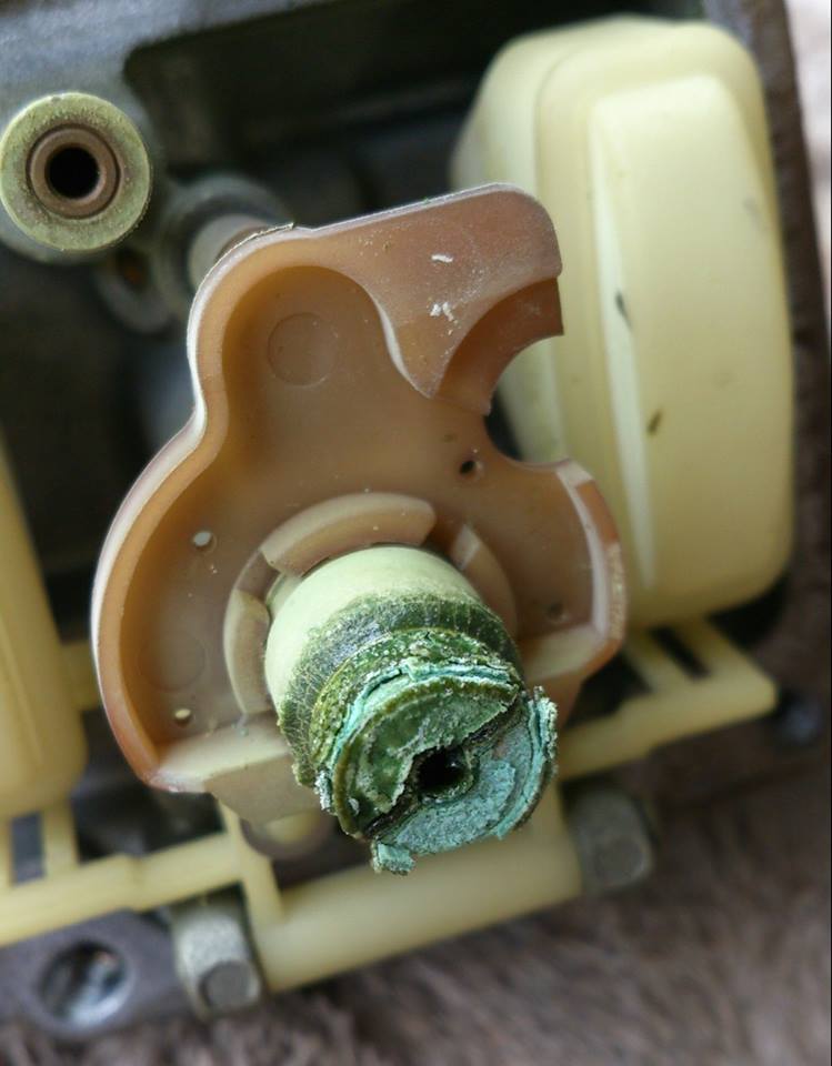

Just returned to Thailand and could not start the KLX. Took it apart and this is the state of my carb after letting the bike sit for 3 months with gasohol in the float bowl:

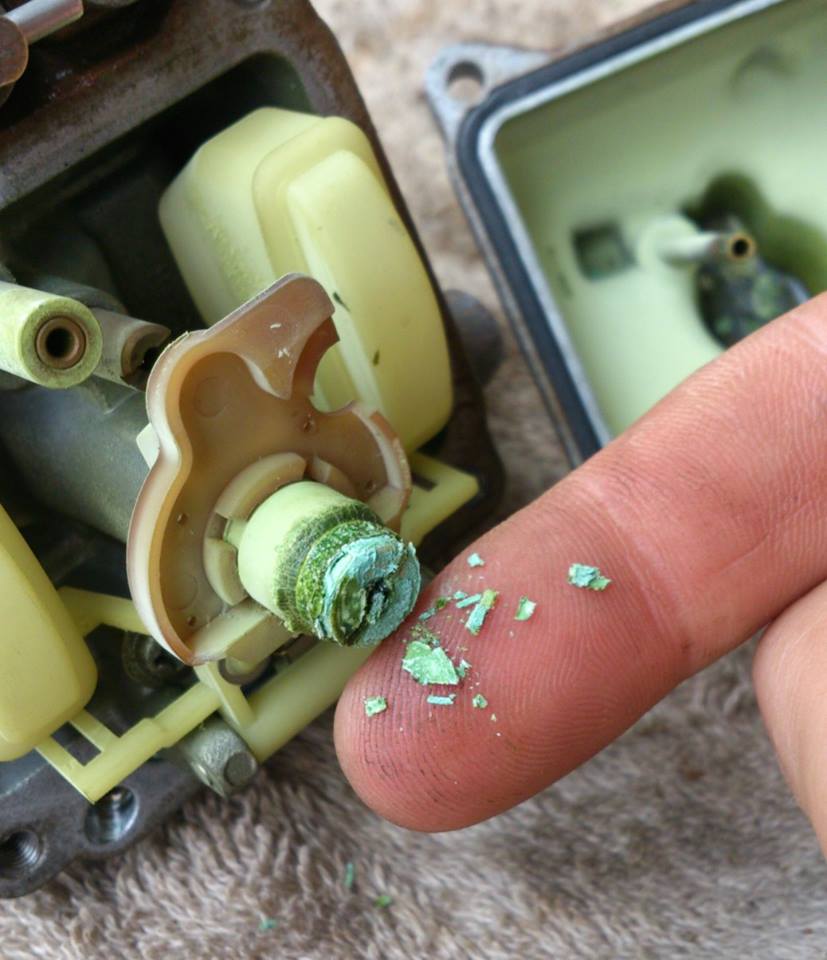

Main jet is completely clogged with this nasty gasohol residue:

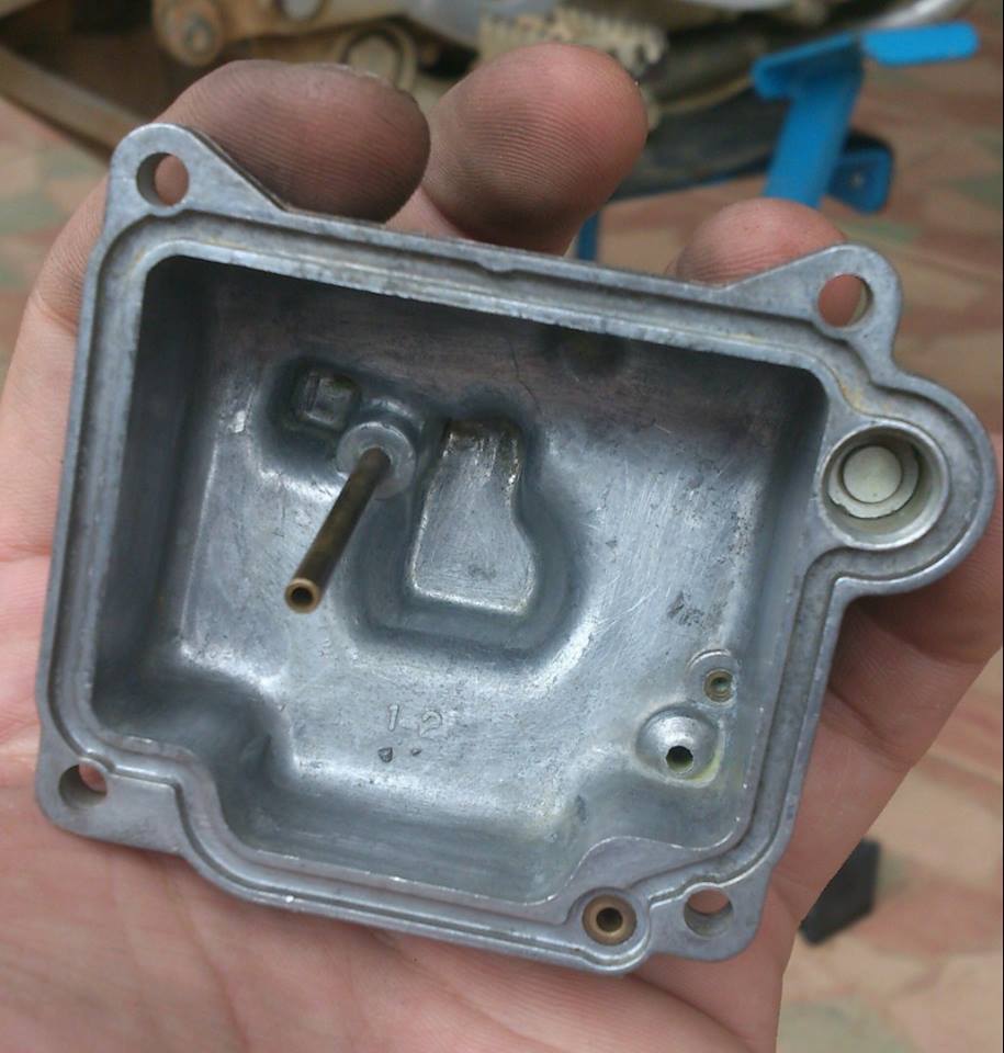

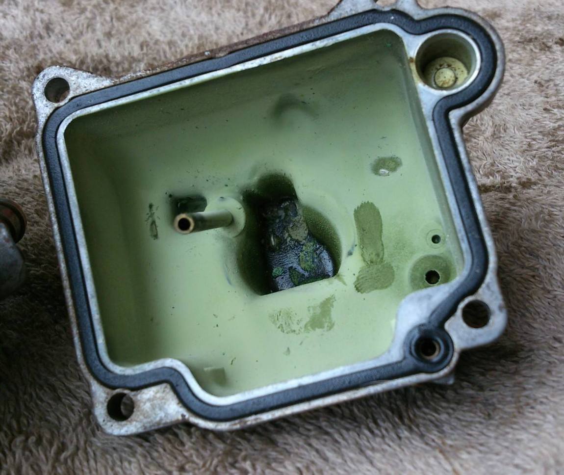

This residue is not only on the parts that were submerged in the gasohol. It's also inside the jets and on the needles. Obviously a complete rebuild is necessary.
Completely my fault of course- I should have avoided using gasohol in the first place and should have drained the carb before leaving the bike, but it is what it is, and perhaps this post might save others from having to deal with a similar mess.
Happy Trails!
Tony :happy1:
brake034;292766 wrote: Tony, this is strange!
Normally Gasohol causes certain rubber compounds to swell and deteriorate, leaving a residue.
But in itself the alcohol in the petrol can never leave such green debris as you show on the pictures.
If gasohol is the cause then some rubber/plastic materials in the bike must have deteriorated?
What year is your KLX?
Another observation is that the debris is hard/brittle and greenish, did you use any fuel additives or fuel from unreliable sources?
I also see corrosion on the float bowl cover, are you sure no water has entered your petrol tank??
I am not a corrosion expert but I believe we see copper oxidation or some form of sulphur deposit on the pictures.......

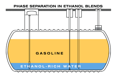

The problem with gasohol, as I understand it, is that the ethanol that is blended with the gasoline absorbs water and phase separates, leaving you with something like this in your tank-
It's a chemical process and once phase separation occurs it can not be reversed. When phase separation occurs you will have an upper layer of gasoline with a milky layer of Ethanol and Water below it, and sometimes a third layer of just water at the bottom.
The Mikuni TM33 carb is supposed to be able to tolerate ethanol blended fuels, and as far as I can see none of the plastic parts or rubber seals are damaged. Fuel lines and fuel filter look fine too but I'm going to replace them all the same. Clearly there is oxidation in the float bowl from the water in the fuel. I'll soak the carb in cleaner overnight and run narrow gauge wires through the jets and blast everything out with compressed air. Annoying but not the end of the world.

Gnasher328;292844 wrote: I had similar problems years ago in the UK, well before gasohol. I think it is polymeriseation of the fuel molecules. Marine people experience it and there is a 'fuel stabiliser' available. I tried pouring a good dose of injector cleaner into the tank and running for a bit, then draining the carbs before lay up. On my fuel injected bike I try to run the system every month or so by turning the ignition on and using the kill switch to cycle the pump half a dozen times or so.
"polymeriseation of the fuel molecules"... Hmmm, I'm honestly really not sure what that means, but I left my Versys and GSXR sitting alongside the KLX for the last few months and they both started up at the first push of the starter buttons and are running fine. Only had a problem with the carb'd KLX. Weird huh?

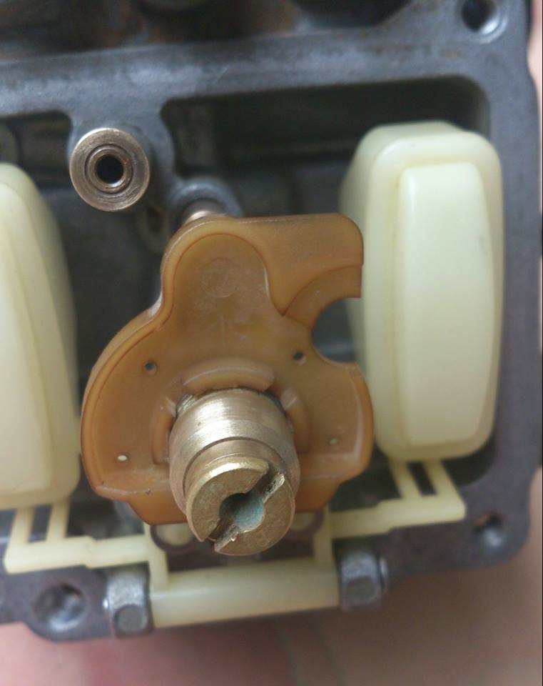

I already cleaned the carb. Ended up mixing up a batch of carb cleaner because for the life of me I can't find a shop in Bangkok that sells the stuff in anything larger than spray cans... So, consulting the interwebs I found a few different recipes and ended up making the following:
1 part gasoline, 1 part diesel, 1 part kerosene and 1 part Dichloromethane (I really wanted acetone but couldn't find it).
Even though I mixed it up outside in a well ventilated spot the fumes got me higher than a kite! Left the carb to soak overnight and scrubbed it clean this morning.
Before:
After:
Before:
After:
Moral of the story, avoid gasohol and drain your carb if you're not going to ride for a while to save yourself this hassle!
