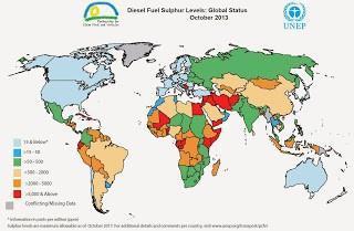

Also when the fuel quality gets better international, there are still areas where you will run into trouble when you use an Euro5 exhaust emission standard based car with an managed diesel particulate filter "DPF". But you can avoid these problems.
Here is an article about that topic. About people who had breakdowns because of this, about how they could solve their problems during their journey:
In german language: 4x4tripping: Moderne Euro5 Diesel-Fahrzeuge auf Weltreisen
In english: 4x4tripping: Using an Euro5 Diesel car for an worldtrip
Better you prepare your car before your journey, if you plan to use such an modern car...

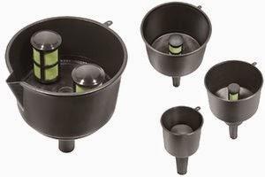

fdale;296784 wrote: Any diesel, anywhere, will benefit from a better than OEM fuel filter. Racor is the world standard. Come with water separation, and can be equipped with heating elements to allow sub zero operation. None finer.
An additional fuel filter or replace of the existing one may be helpful. I did use an external filter:
http://www.4x4tripping.com/2014/08/diesel-benzin-filter-Fernreise.html
