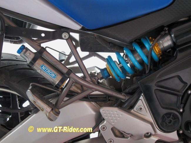

On my Africa Twin I ran YSS, Technoflex & Wilbers; now on the Versys I am running a Nitron, brought from Nitron (Malaysia) Asia in KL
Testing the shock on the computer
Every shock from Nitron in KL is built for you - they ask for your riding weight + preferred set up.
With rebuild the shock is computer tested before & after the rebuild.
The engineers are Nitron in KL are genuine craftsmen, making a shock just for you.
Nitron is a UK company. All parts are made in Europe. For the Asian market there is an assembly plant in Malaysia supplying S E Asia (Malaysia- Singapore - Thailand Indonesia) plus one in Japan for the Japanese market.

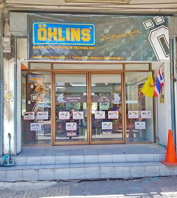

I googled Ohlins Thailand & came up with these
Ohlins Asia
Öhlins Asia shock absorber, ohlins, ohlins for honda, ohlins msx, ohlins forza, ohlins crf, ohlins zoomerx, ohlins scoopyi, ohlins click, ohlins cbr150, ohlins cbr250, ohlins cbr300, ohlins pcx, ohlins cb500, ohlins cbr650, ohlins for yamaha, ohlins spark, ohlins fino, ohlins ttx, ohlins mio, ohlins nouvo, ohlins for kawasaki, ohlins d tracker, ohlins ninja250, ohlins ninja300, ohlins ksr, ohlins er6, ohlins versys, ohlins klx150, ohlins klx250, ohlins for ktm, ohlins ktm, ohlins duke, ohlins front fork, front fork ohlins, front fork msx, front fork zoomerx, โช๊คโอริน, โช๊คอัพ, โช๊คอัพโอริน
Ohlins Thailand Facebook
The start up of Ohlins Thailand
This is Öhlins - Öhlins Racing
