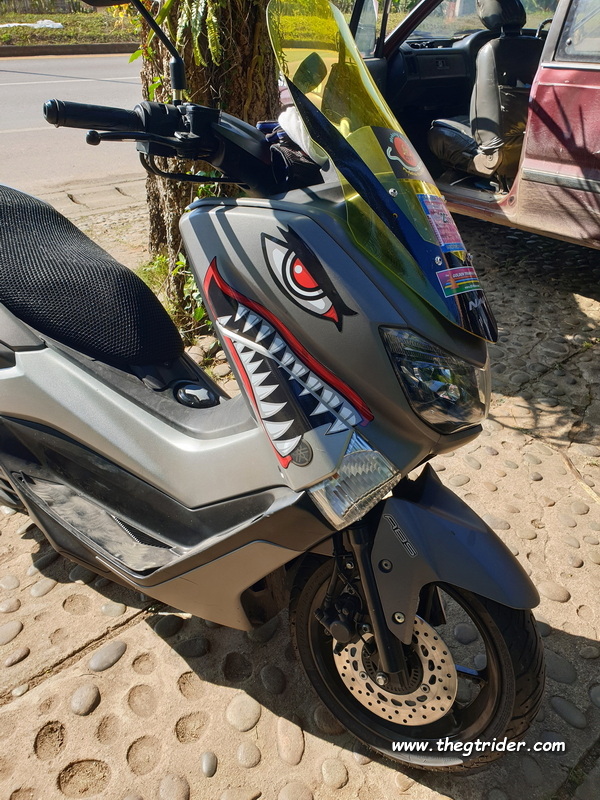

First was an improved fairing.
It looked this when I got it
1672071259605-jpeg.150470

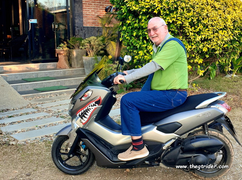

But now looks like this.
It was sourced of Lazada from a shop in Bangkok for 699 baht.
I also found some hot stickers for 250 baht on Lazada to give it a stunning appearance.

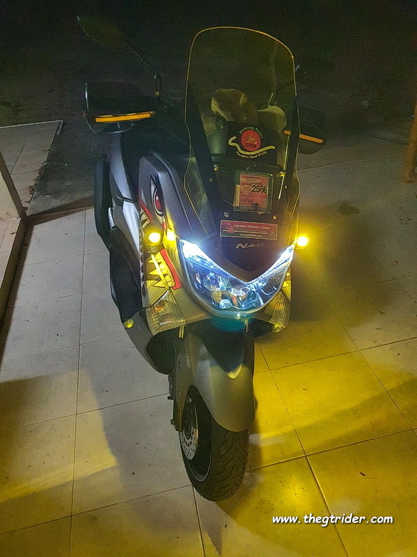

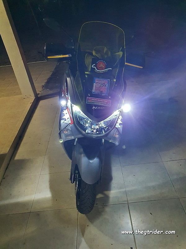

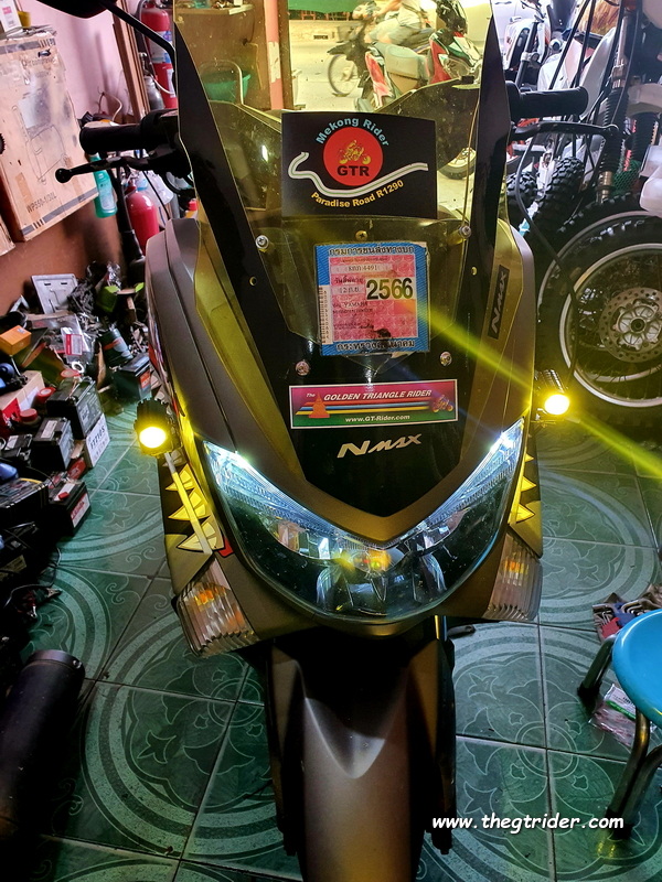

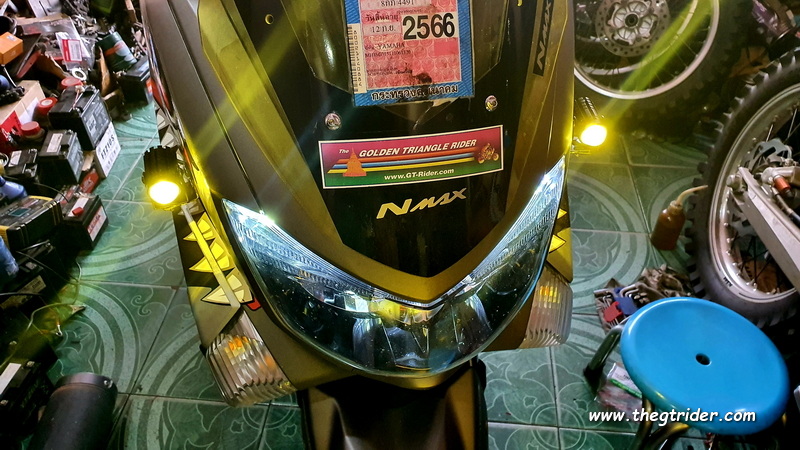

Next up has been extra lighting for coming home at night from a Mekong Pizza plus.
Sourced on Lazada for 271 baht.
Fitting them high enough was a bit tricky, but Kong & I managed to work something out so they fit neatly on the side & high enough to be useful.
These little spots are 2 coloured, yellow & white.
The yellow is wired into the ignition & come on automatically as running lights, whilst the white are wired into the high beam switch.

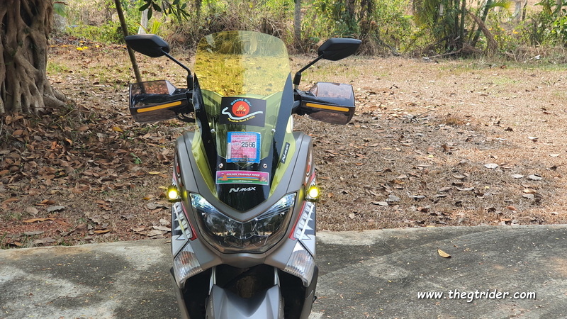

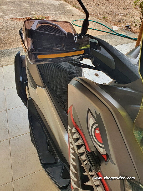

At the same as Kong fitted the spots I got him to fit some clear hand guards.
I struggle with the cold in the mornings & these will work a charm, to help my hands warmer.
Fitting them also needed some innovation with brackets & cutting a few bits out on the handguard that you can only see underneath.
The fairing also needed tilting forward a cms, so that they did not hit on full lock.

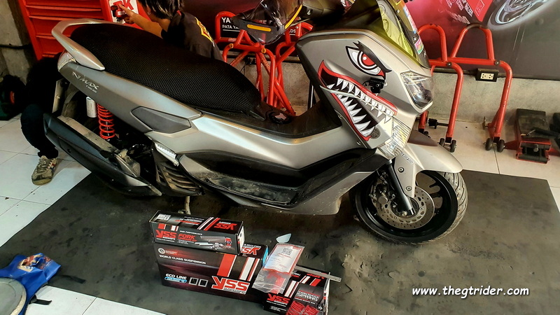

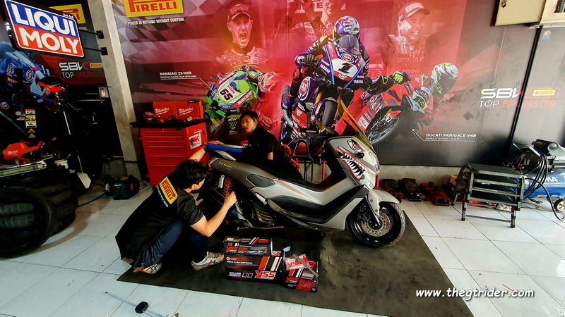

A seal on the rear shock started leaking a couple of weeks ago, so time to upgrade the suspension.
The cheapest & hopefully best value for money way to go is YSS - a full YSS suspension kit, front & rear.
Sourced via Ban Chang in Chiang Rai.
And I'm a happy NMax punter & am enjoying the bike.

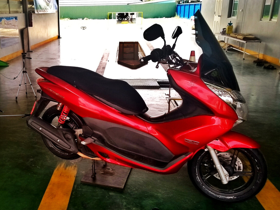

A big screen, daytime running lights, and YSS suspension front and back are the best way to go. Did the same myself, but not the shark stickers, yet. :joy:
What other mods are there? You could reduce the unsprung weight on the rear shock by changing the stock end can to a lighter model. Can't say I've bothered myself. The best possible quality tyres are a worthwhile investment. Pirelli and Michelin do excellent scooter tyres. Anything else? On my PCX I fitted a back protector under a mesh seat cover to add a little extra height to the seat. The mesh doesn't get burning hot when the bike is left out in the sun, a valuable comfort mod!
