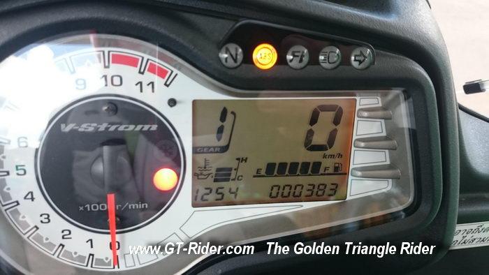

Wow first tank of petrol. The fuel light comes on at 375 kms.

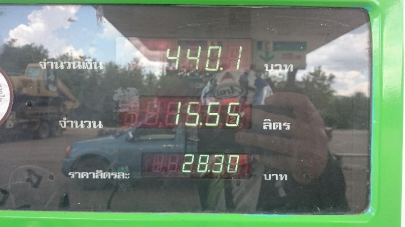

Fueled up for 440 Baht @ 382 kms for 15.5 litres = 24.5 kms a litre. That's economical ++.

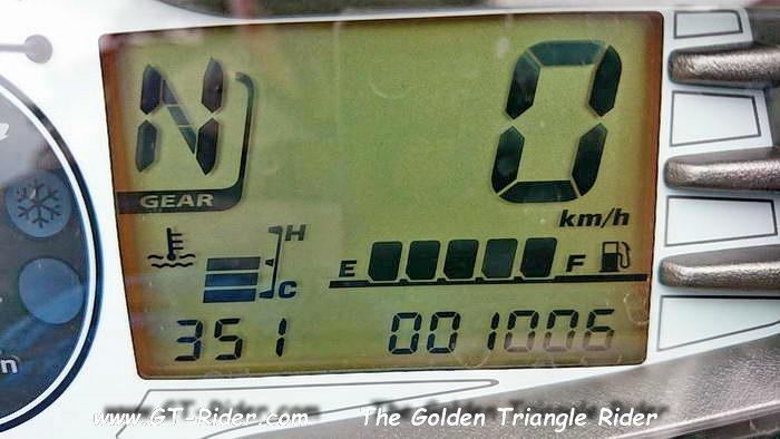

1,000 kms up..after 2 full days use

Amazing miserly fuel consumption = 24.5 kms to the litre. My dear beloved Africa Twin only used to get 12-15 -17 kms a litre.
On the Vstrom the fuel warning light came on at 375 kms & I fuelled up at 382 kms for the first tank of fuel = you can get 400 kms per tank, which is enough for me in this region. No need to carry extra fuel whatsoever.

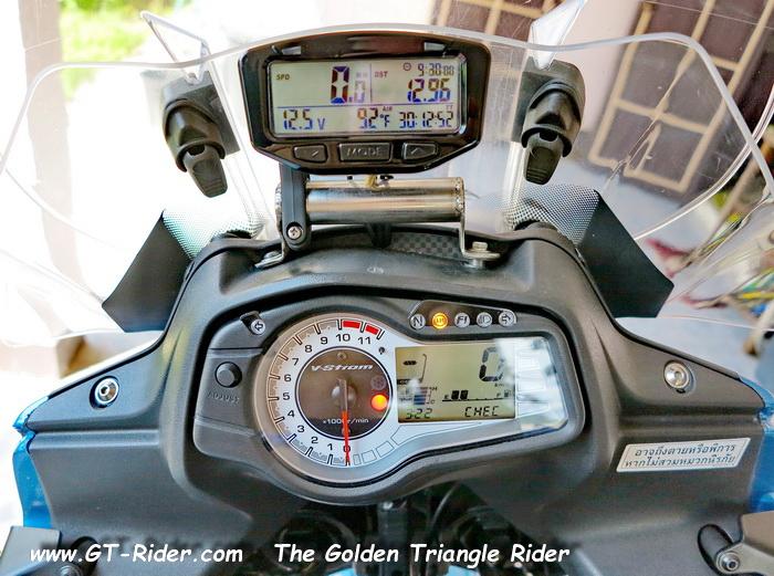

The bike does not have a radiator temp gauge or a voltmeter so I will be getting a TrailTech striker gauge.

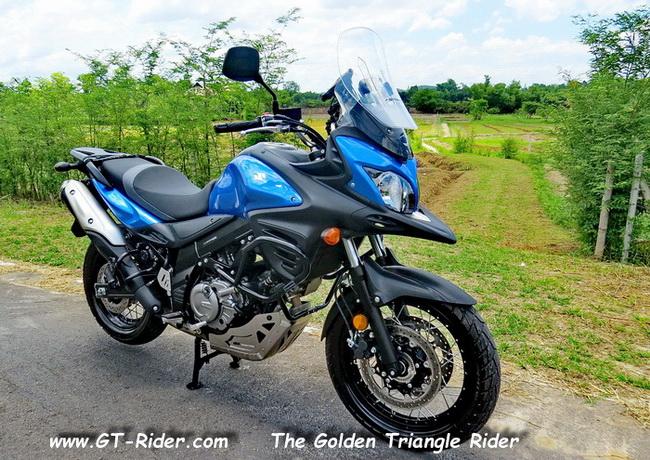

How she is shaping up.
The extras so far.

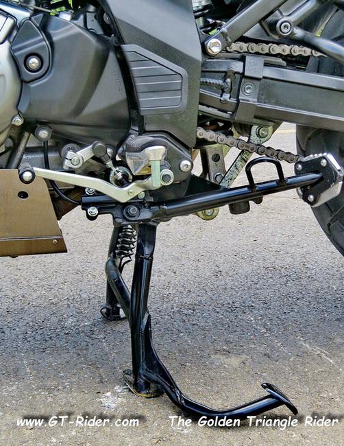

1. Centre stand
brilliant. Makes it easy to check the oil, check & adjust the chain, check your rear tyre for nails. You could not do this so easily on the Versys.
The Versys did not have one & you could not fit one because of that exhaust set up underneath.
Bought from Suzuki at a cost of 5,400 baht, but I should have bought from Jacket Boy for almost half the price!

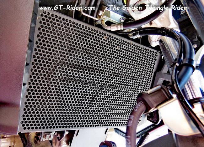

2. Radiator Guard
sourced from Jacket Boy in Bangkok. 3,200 baht.

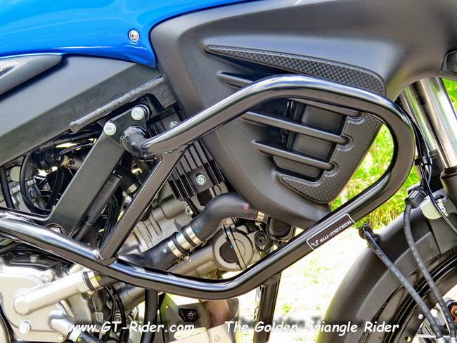

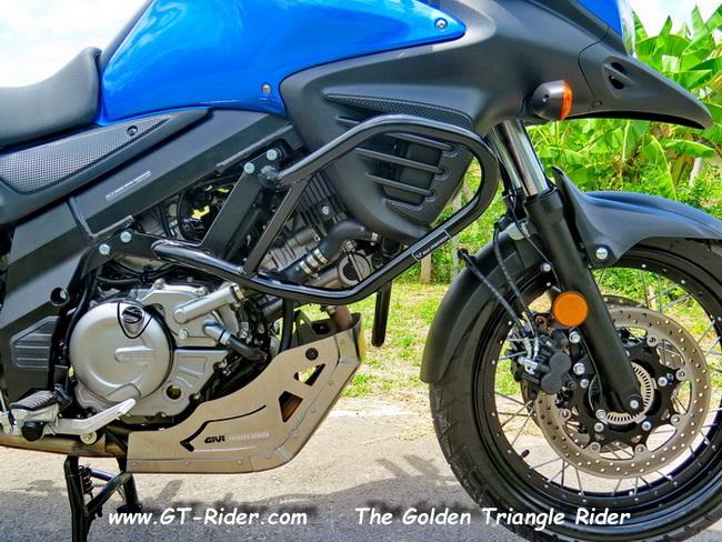

3. SW Motech Crash Bars
Look smart & should do the business & IMHO much better looking than the Givi ones
Sourced from Panda Rider in Bangkok . 6,900? baht.

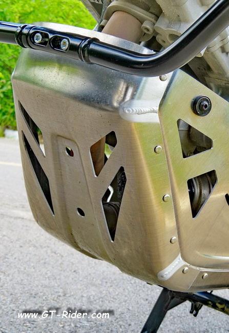

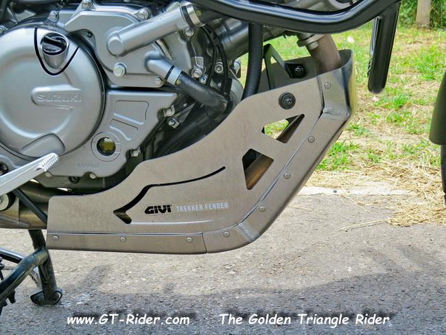

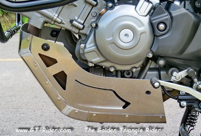

4. Givi sump bash guard
Sourced from Jacket Boy. Considerably less than the SW Motech one at Panda Rider.

6. Sidestand shoe - Foot enlarger
sourced from Jacket Boy. 750 baht.

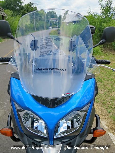

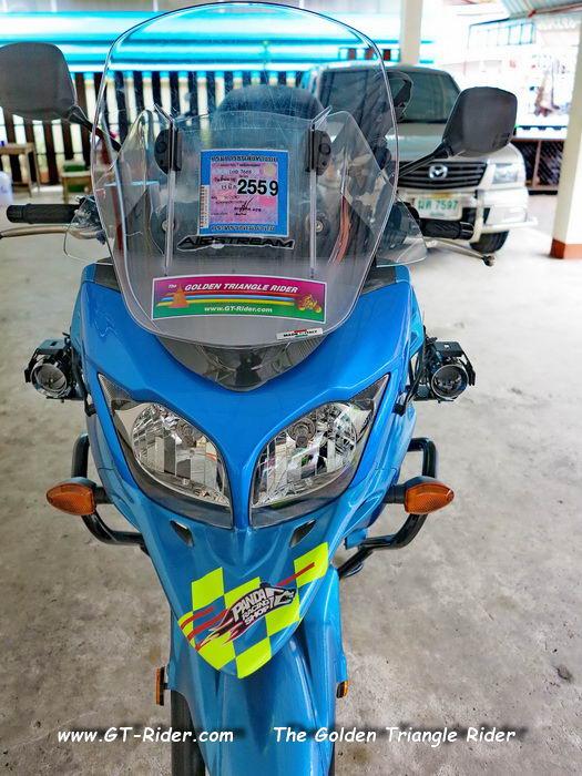

7. Kappa windshield
made in Italy & a beauty.
Trick height adjustment.
The above is at a low setting
Below is at the highest setting
adjustment is simple & on the inside so it can be done sitting on the bike.

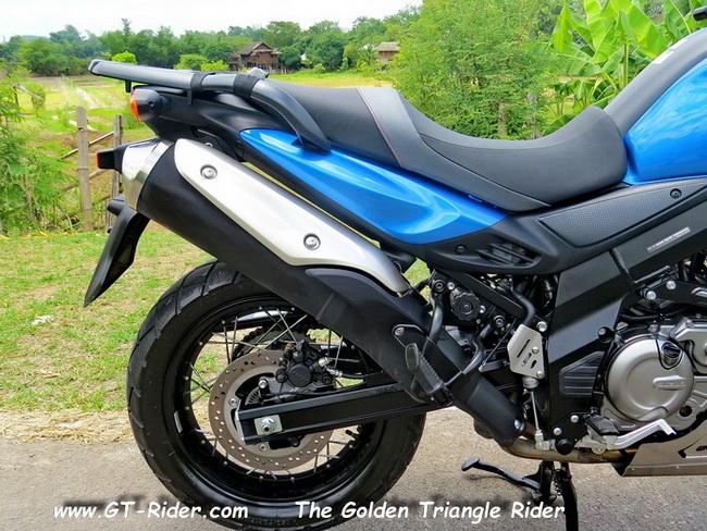

only that large exhaust
is a nuisance fitting side boxes & keeping the bike narrow. More research is needed.

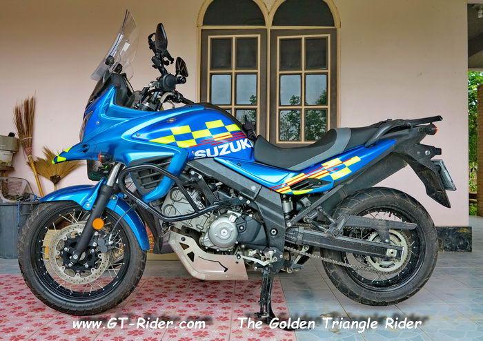

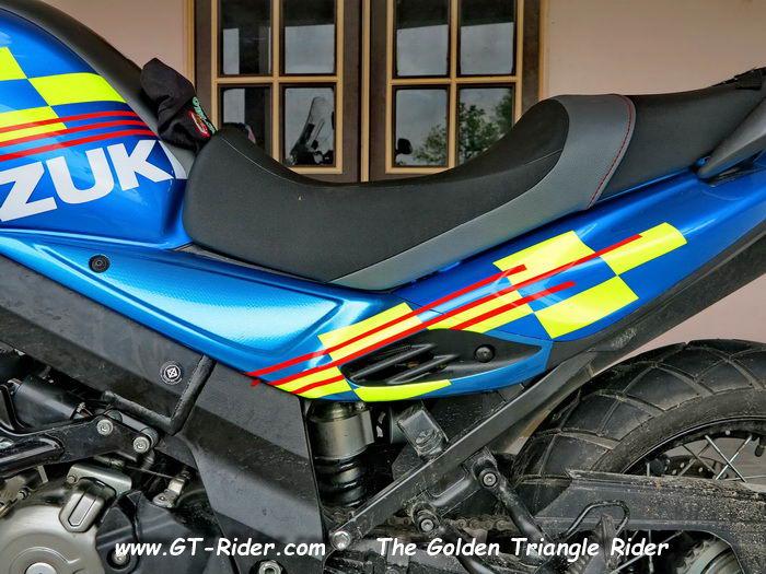

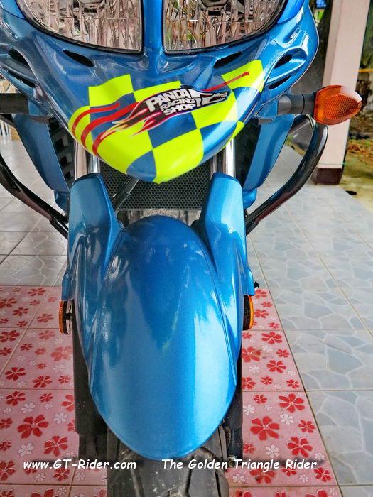

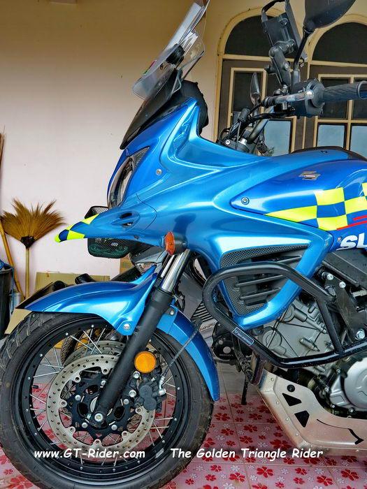

Progress....tarting the VStrom up to be more photogenic & eye catching.
Not being one fond of dull black bikes, it was time to do away with the some of the black.
1. The black beak
The side of the cowling
this included the black mudguard
The side covers
to end up like this.
for the time being.
There will be a bit more tarting up once some more green sticker comes in.

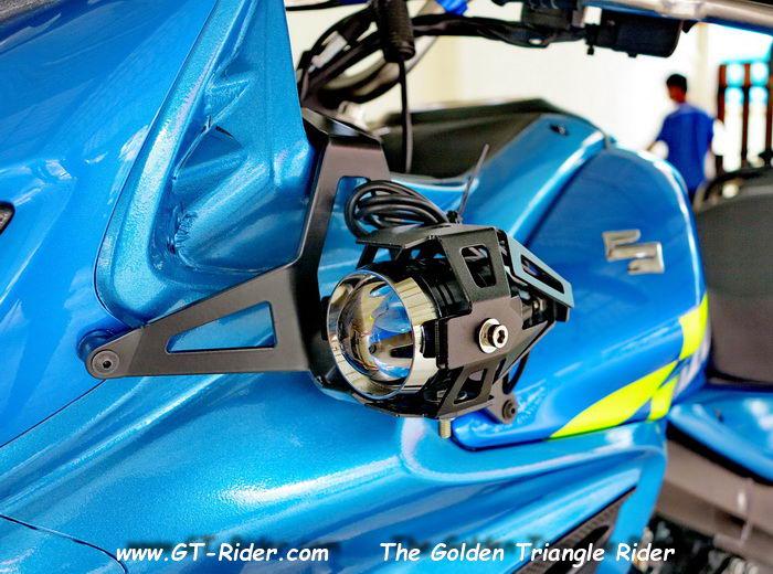

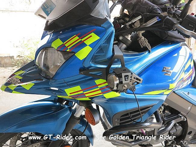

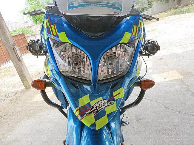

Spotlights - sourced from Ambassador Bungy at the X-Centre
mounted with SW Motech brackets sourced from Jacket Boy in Bangkok.

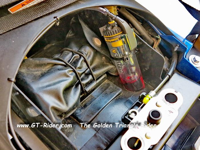

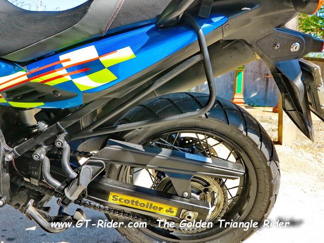

A Scottoiler - automatic chain oiler.
sourced from Sunny Oh at Sunny Cycle in Kuala Lumpur, Malaysia's oldest big bike store.
I swear by Scottoilers for oiling your chain. 320,00 kms on the Africa Twin, 100,00 kms on the Versys - & I used a Scottoiler all the time!

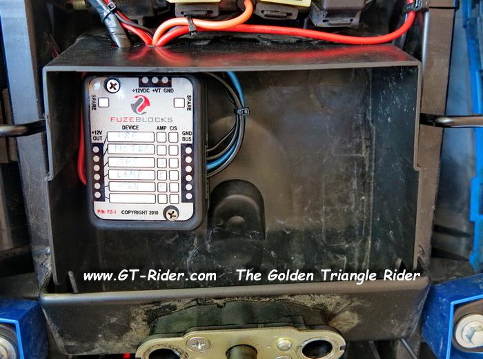

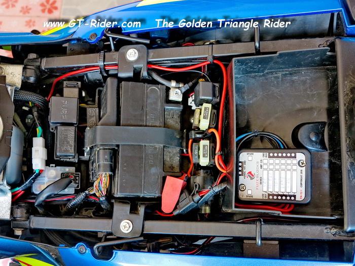

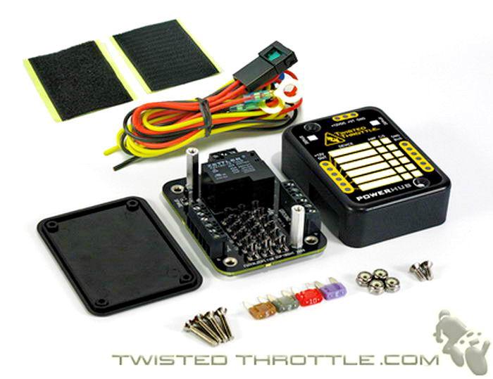

Next step get it all the accessories wired up properly using a Fuzeblock, already in hand.
sourced from Twisted Throttle in the USA.

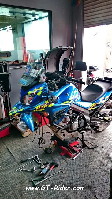

Does anyone have a recommendation for the best - a good automotive electrician in Chiang Mai?
& I've got 5,700 kms up on the Vstrom already.
6,666 kms up & it's finally all wired up with everything working nicely.
The Trail Tech Striker gauge
a volt meter, radiator temp gauge, air temp gauge, speed - maximum / average,clock - hour ride, travel time, accumulated ride time, maintenance reminder - oil , service .
The Fuzeblock is mounted under the seat
all the electrical accessories are connected to the Fuzeblock, then it connects to the battery

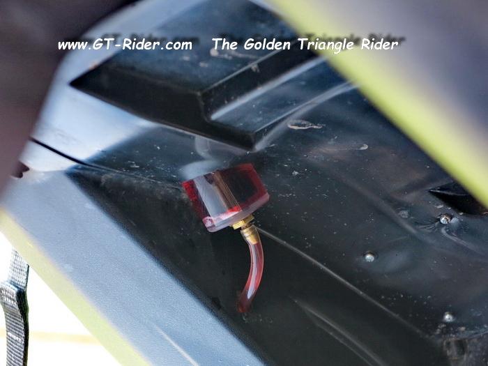

A note on the Scottoiler

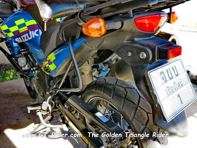

beautifully mounted,m by Joe at Joe's Bike Team,  under the seat where it is  protected
exiting under neath to run down to the rear sprocket & lube the chain nicely

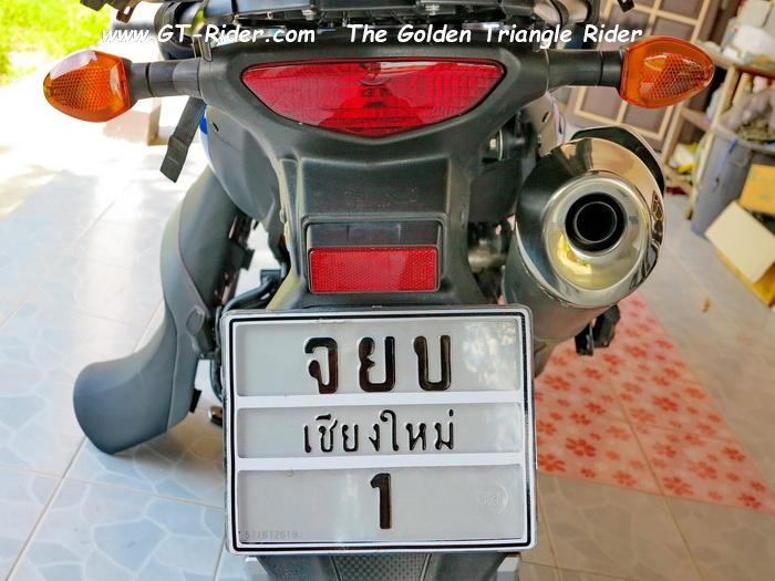

New number plate
Cost 5,800 baht in Chiang Mai.  Picking numbers in Chiang Mai number is cheap & fast compared to Bangkok.
When I first got my bike I was told 3 months wait for # 1 again; but I could have any plate / number in a couple of weeks & later on request a special number & wait. So in a couple of weeks of buying the bike I had plate # 7228, then Suzuki applied for plate # 1 & a month later I had plate # 1. Suzuki tell me it easy to change plates in Chiang Mai, so if you fancy a special number it is no real trouble to apply for another number that you fancy. Take anything first to get a plate, then later on apply for a new number.

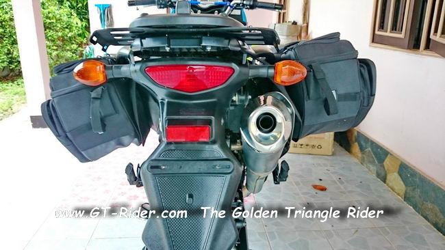

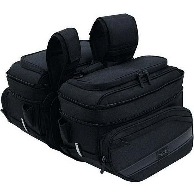

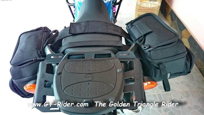

The MotoCentric touring saddle bags
Small 21 litre bags for travelling with the GF & the alternative to unnecessary big wide dangerous car clipping side boxes.
Priced at US$89 = steal at that price. How they sit on the bike
How it all looks - goes together on tour with the GF.
the left side flops down a little & I will install a small bracket to hold them up nicely. & if you don't install the rain covers in thunderstorms, the moisture soon gets in.

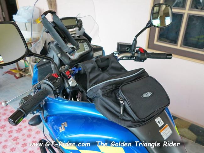

An experiment - a  new handlebar bag  - in an attempt to set up a hyrdration pack on the tank, rather than a back  pack.
The handle bar bag
Marketed by Gears

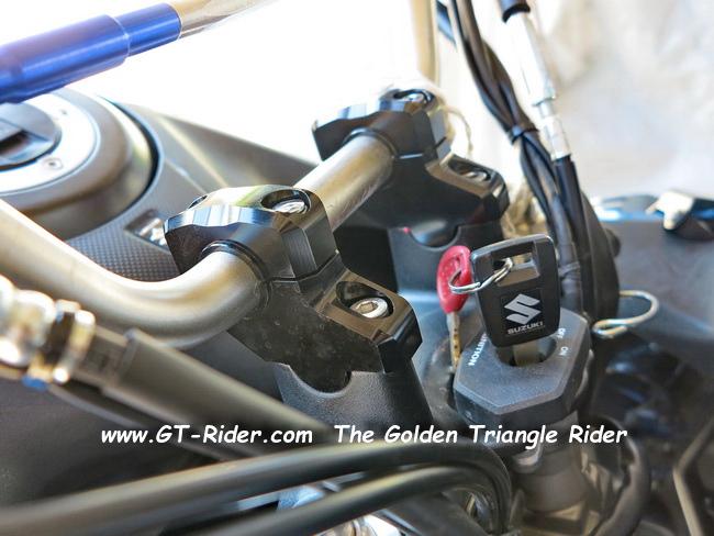

The next little improvement - handlebar risers
that enable the bars to be come back just a little closer & so have a better grip & control, something that I felt was not quite right in standard form.
Sourced from JacketBoy in Bangkok. Cost 1,000 baht. They fit straight on with no necessity for changing cables either.
A saddlebag support bracket
fitted to hold the bag up on the left hand side only, & so stop it from flopping under towards the wheel.

The first big test heavily loaded up with bags all round.
Chiang Mai - Houei Xai - Luang Namtha- Luang Prabang - Vientiane absolutely no problem.
And then Vientiane south of the fast R13S.

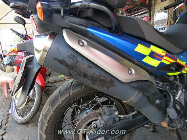

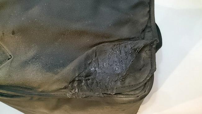

Carrying a bit more speed I discovered the right saddlebag had the bottom rear corner of the bag touching on the exhaust.
My conclusion was that the extra speed - sitting on 140KP - was generating more airflow & causing the bag to tilt out at bit at the front & in at the rear.  There was absolutely no problem from Chiang Mai to Vientiane, only after Vientiane south on the fast flat open road.
The solution came from Louis Motorcross in Savannakhet.
450 baht & I think Louis is a genius.

Doing the original sticker job 8 months ago, the guys at Panda ran out of the lemon - green fluorescent colour.
Now a mere 8 months later we are back on track to finally finish off the job
It was just the front of the cowling that needed tarting up
The unfinished sticker job
so now the last little bit is done

9 months & 27,800 kms up = the suspension is a bit weary.
Off to CMS Chiang Mai Motorsport in Star Avenue by the arcade bus station on the super highway.
CMS are an authorised Ohlins dealer & know how to set up your suspension.
Öhlins suspension By Chiangmai Motorsport
The CMS workshop is small, but clean & well organised
In a matter of minutes the guys have the front off
the oil is changed & all the parts cleaned & checked. In no time I'm called back in to sit on the bike to test & measure the sag. All done I get to head of for some coffee in the aircon shop next door, while they do some fine tuning.
The front end is calibrated properly.
45 minutes later I'm called back, the suspension guru takes the bike for a short ride around the Star Avenue car park & we chat about the back end. The spring is too soft already & at its maximum adjustment. Yes I agree totally, that's why I'm here. Suzuki where are you - it's an Asian spec spring for a 60kg rider & not for a big fat 99kg farang! A problem to sort out later on...
So. The CMS Service fee is 1,500 baht with a fork oil change. I get on the bike & ride home. And it feels almost like a new bike again - a plush ride, eating up the bumps & ripples in the road, except for that soft spring on the back.
But I'm highly impressed with the guys at CMS - let them check our & set up your bike's suspension. The change is incredible when done properly - precisely measured & calibrated all in a flash. Top marks guys. 10/10 for excellent service.
CMS is mentioned here in the GTR Chiang Mai Motorcycle shops
Chiang Mai Motorcycle Shops
Highly recommended.
Now what to do about that weak spring on the back...
