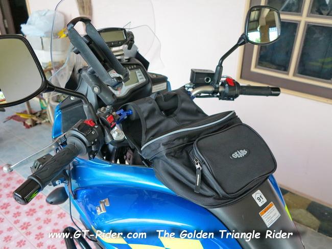

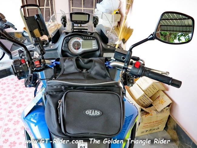

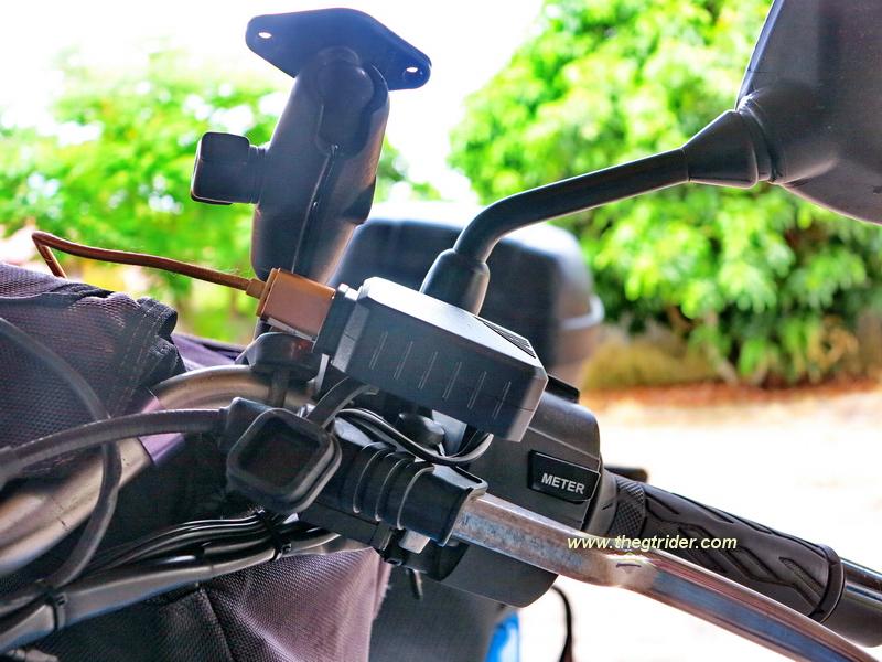

An experiment - a new handlebar bag - in an attempt to set up a hyrdration pack on the tank, rather than a back pack.
The handle bar bag
Marketed by Gears

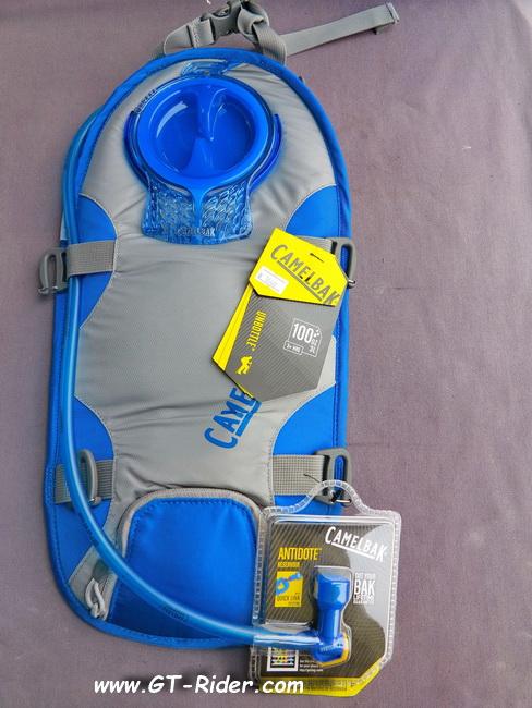

A big test on a hot ride in Laos with a 3 litre camel bak & it works a treat
I bought a 3 litre Camel Bak
from a Packs Etc at Kad Suan Kaew
Took out the bag
& placed it in the handlebar pouch.
Works a treat & I'm amazed how much water I can suck whilst riding = I'm glad it is a 3 litre bag.

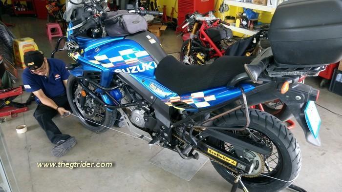

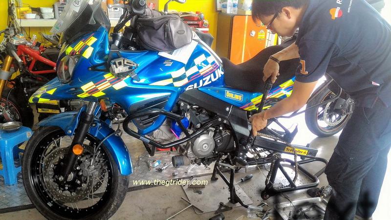

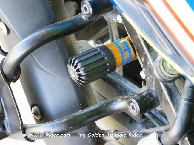

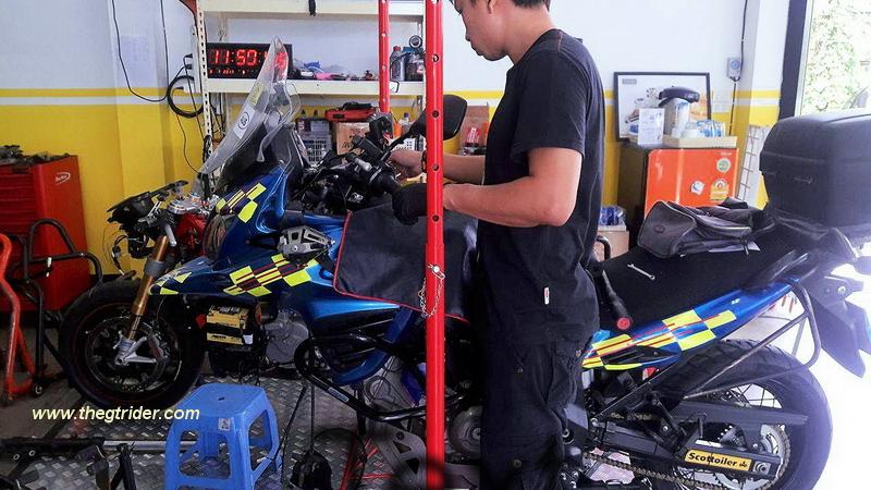

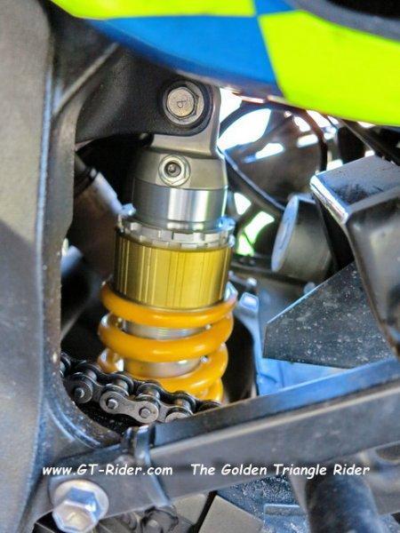

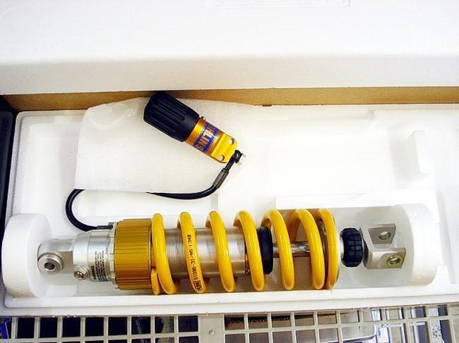

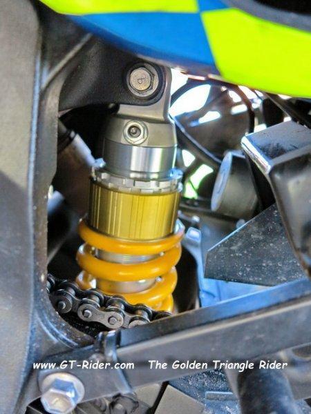

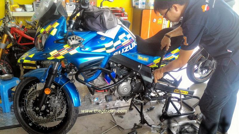

40,000 kms up & the suspension is not good enough.
The spring on the rear shock has lost its tension & The front is damn weak.
Time for a change.
With the riding I do & the need for regular shock rebuilds it is important to be able have your shock rebuilt locally.
On the Africa Twin I managed 340,000 kms & had shocks made by Wilbers & Technoflex, but they had to go to Europe for a rebuild = no verty satisfactory when it takes weeks of not months to come back. I had a Hyperpro on the Versys & it once took 3 months to come back from Europe after a rebuild. No good at all.
So the only options for me are Nitron (in KL Malaysia), or YSS & Ohlins in Bangkok.
I ran a Nitron on the Versys & had a YSS on the Africa Twin, so now its time for something new & supposedly the best =- Ohlins.

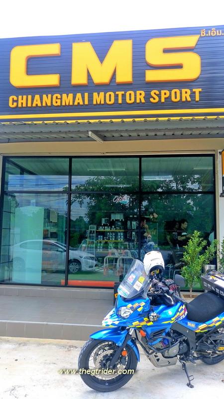

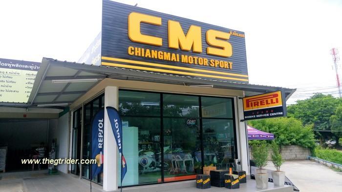

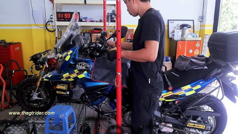

After a disappointing experience dealing with the Ohlins Sales & Marketing Department in Bangkok I ended up dealing with CMS in Chiang Mai.

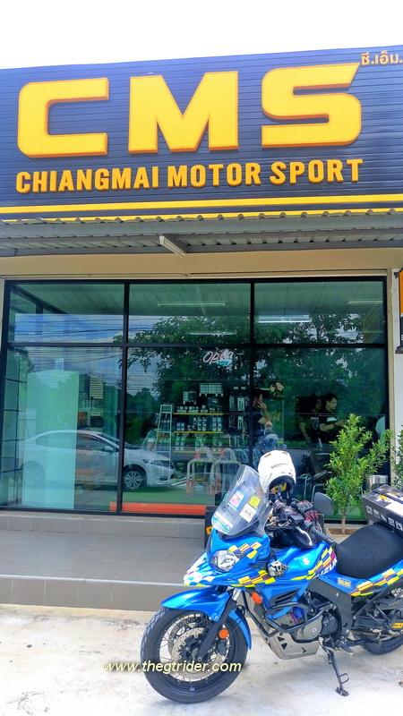

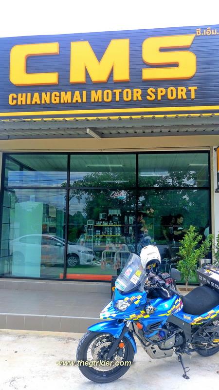

CMS are Ohlins dealers & are trained properly to set up your bike suspension correctly.

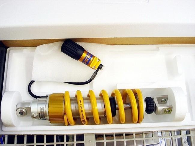

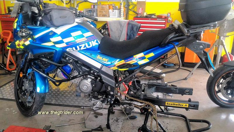

So 39,000 baht poorer the Vstrom is now a lot richer & providing me with a plush ride = the bike feels like new again.

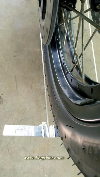

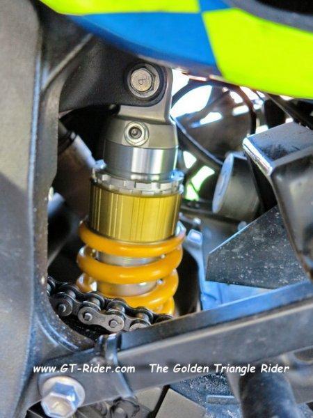

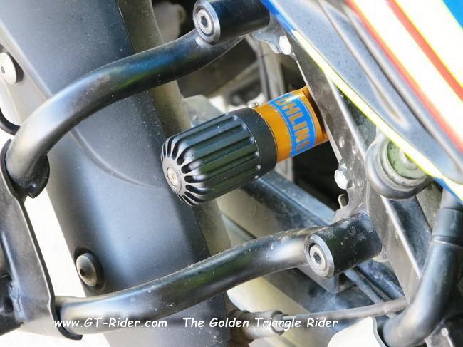

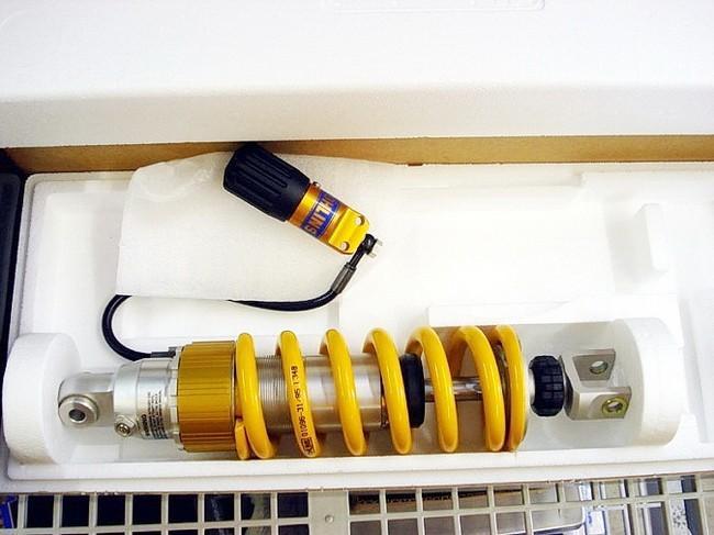

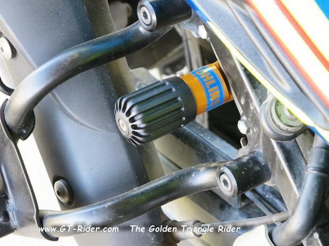

Adjustable pre load
a fully adjustable shock with a stiffer shock spring + new Ohlins front fork springs.
The recommended service is 30,000 kms, & I'm extremely keen to see how it holds up.
Rebuilds are done in Bangkok & the supposed turn around is a mere 10 days!

There's the perfect baby...simple pre load adjustment.
worked an absolute treat adjusting the set up on the MHS Loop trip to Rak Thai with the GF & her extra luggage.
A couple of small turns up & down to get it right, but once set up - as smooth as & as stable as - on rails.

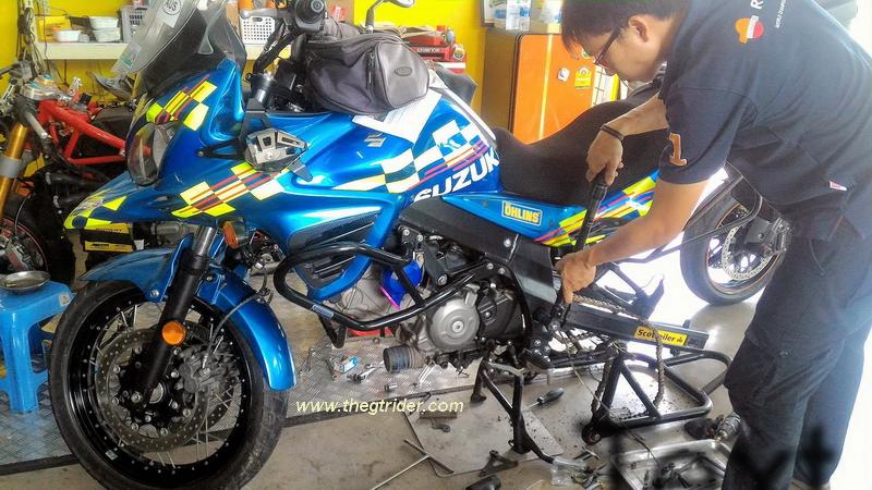

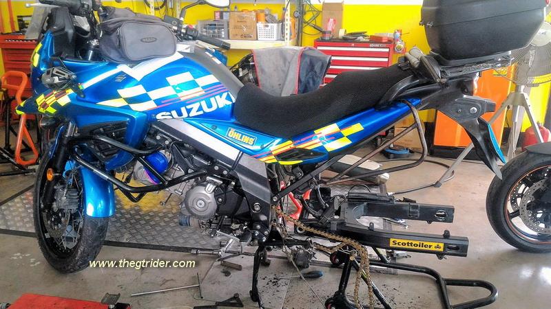

Late October 2016 = 45,000 kms & time to change the original chain & sprocket set! Unbelievable value.

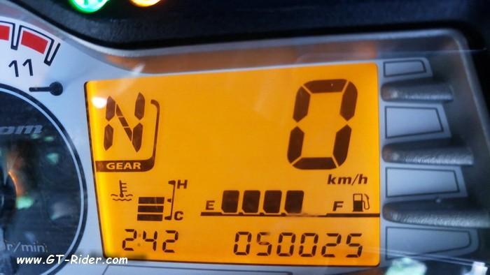

Early December = 50,000 kms & probably time for a TLC service at Suzuki.

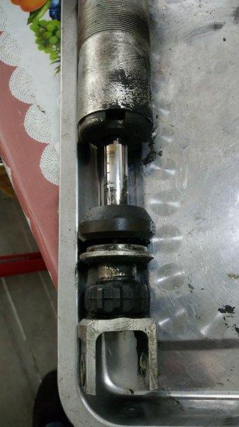

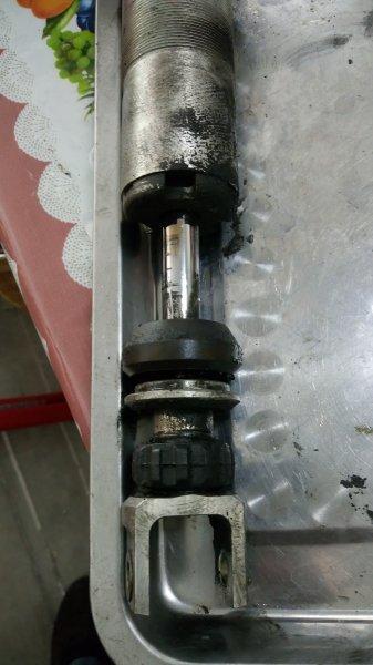

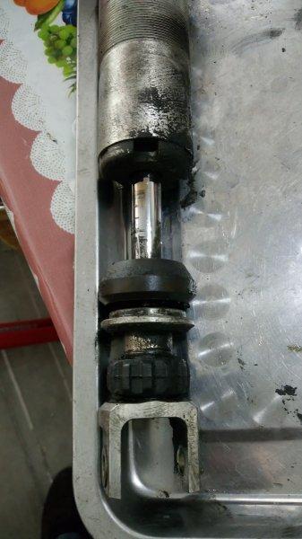

15,000 kms up on the new suspension & the front fork oil is knackered & needs replacing.
Cost 2,180 baht at CMS.
The springs front & back are still ok , but the oil on the rear shock is on the way out soon.
That will be time for a rebuild in Bkk at a cost of 3,000 baht with Ohlins.

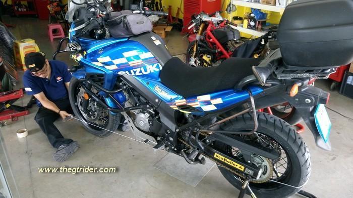

55,680 kms & a speed bump with the local Suzuki dealer Sahapanich.
1. The key ignition switch is total dodgy & difficult to turn on & off - acknowledged by the mechanic.
Searching the web it is a not uncommon problem .
There are details for cleaning & servicing on the web, but Id actually like a new replacement switch before the 2 year warranty expires in 2 more months. Sorry no warranty for this & no switch in stock in Thailand. It has to be ordered & the price is 6,000 baht!

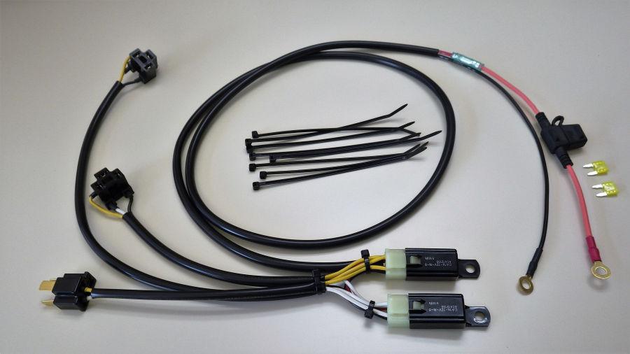

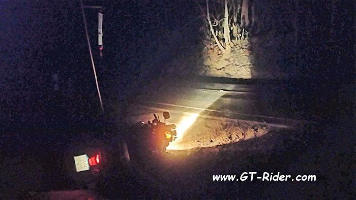

2. The headlight has been working intermittently.
The mechanic had the bike in July 2016 for several days to find the problem. He claimed to have disconnected, cleaned & reconnected everything & hey presto it was all working again. The exact cause - don't know?
Fast forward several months & the headlight no longer works.
Back to Suzuki Sahapanich again. The lights have stopped working altogether - please check again what is wrong.
One day later cannot find anything wrong, but yes the lights don't work.
A google search suggest 2 possible causes
A. a Connector behind the radiator
B. a faulty starter switch.
I leave the bike there for another day. The connector is checked & it is ok.
The starter switch is supposedly checked & it is ok. I reconfim that the starter switch is most likely the problem from forum searches & show images of an open switch & the possible causes. OK we will look at it again. The switch is open & it has burnt, shorted out. "Obviously" this is the problem, but was it even examined before as suggested???
VStrom

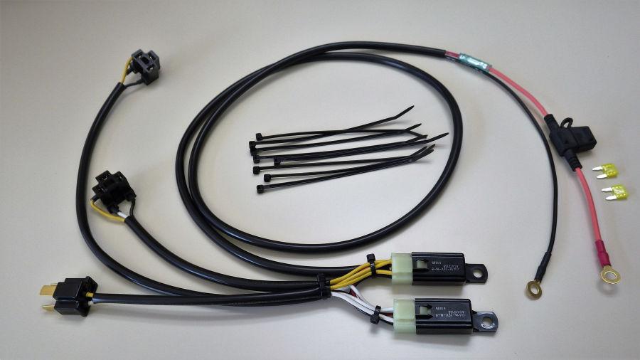

The VStrom does not come with factory headlight relays and so a lot of current flows through the switches and connectors. This causes early meltdown with loss of headlights. This Kit avoids that problem. Do not wait until your switch burns out or a connector melts, install this Kit even on a new VStrom.​
So I ask for a new switch under warranty - please get one. I will come back tomorrow to check.
I return the next day (today) to check on the progress - starter switch & key ignition switch.
No stock of the starter switch.
No stock in Chiang Mai or Bangkok?
In Chiang Mai.
Ok please ring Bangkok to check on stock for the switch.
Ring ring.
Yes Bangkok has, but if you want to claim it under warranty you have to wait for the claim to be processed first!
No I want a switch now. Order it please. I will pay for it & we can process the claim later & you can refund my money 1,500 baht.
Yes ok. Next week you can have a switch.
Phew. Progress..

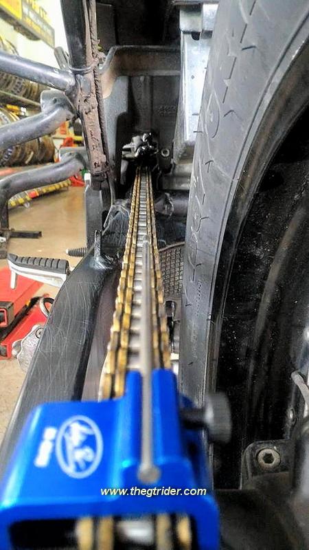

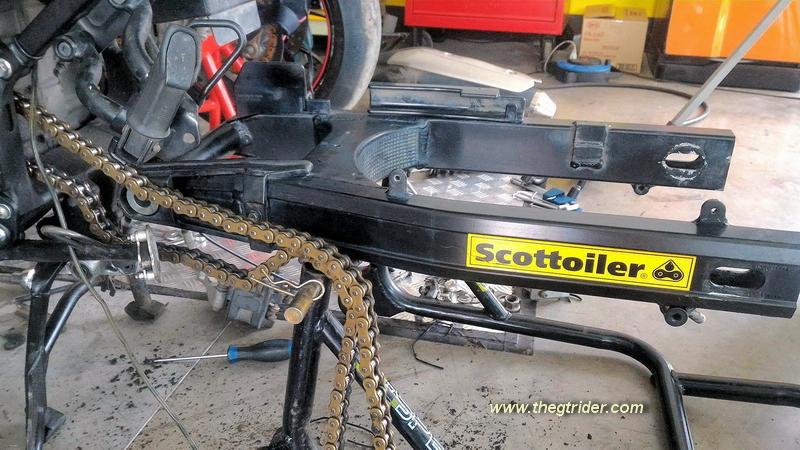

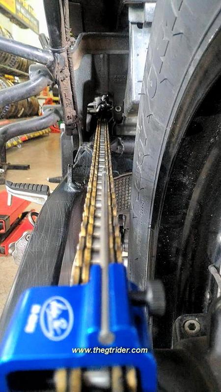

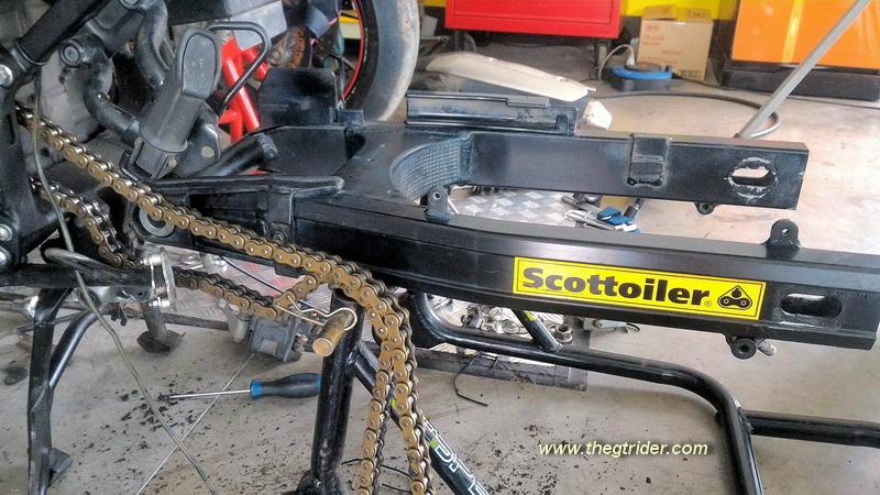

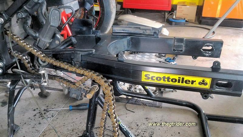

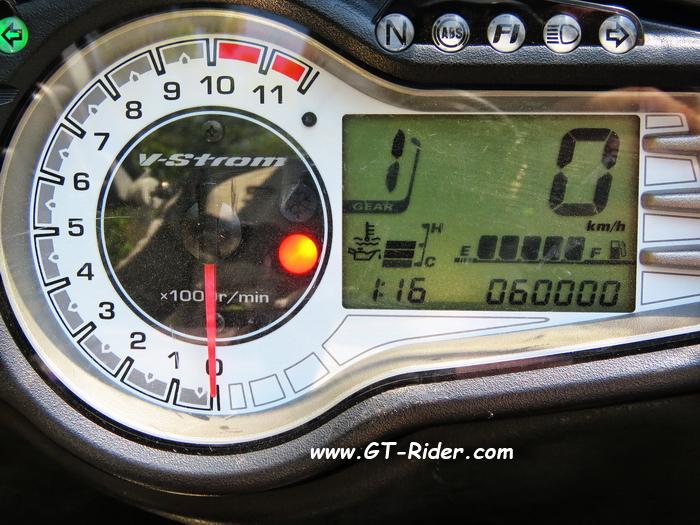

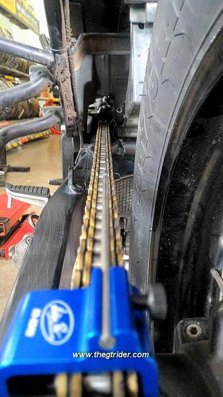

3. My other complaint is the official replacement Suzuki drive chain is knackered. It has only lasted 3 months & 12,000 kms!
A disgusting performance, running a Scott Oiler; & I specifically requested an official OEM Suzuki drive chain because the first one was so good - 45,000 kms.
So that's another complaint to be registered.
A new 525 RK Gold X-ring chain from Piston Shop is purchased for 3,990 baht.

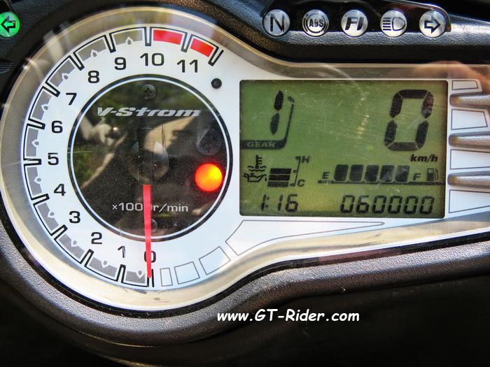

60,000 kms up in 23 months.
The faulty - burnt -starter switch was replaced under warranty.
I installed the Beaver Electric headliht relay kit to prevent any future headlight issues with the ignition switch.
VStrom
Only the worn key ignition switch now needs to be replaced before the warranty expires, but I believe we have a deal for a free replacement.

61,000 kms & the headlight kit has cured the mal functioning lights.

At 64,135 kms the Ohlins rear shock has done 24,000 kms but it has blown a seal & there's no oil in the shock.
The bike has been handling like a pig for awhile.
No problem. Its under warranty so a free rebuild from Ohlins Thailand.
Thank you Ohlins Thailand. Let the next 10 days pass as quickly as possible.
At 64,135 kms the Ohlins rear shock has done 24,000 kms but it has blown a seal & there's no oil in the shock. The bike has been handling like a pig for awhile. View attachment 4341 No problem. Its under warranty so a free rebuild from Ohlins Thailand. Thank you Ohlins Thailand. Let the next 10 days pass as quickly as possible.
An interesting development
55 the Ohlins shock is totally knackered.
64,135 kms on the Vstrom & 24,000 kms up with the Ohlins rear shock.
I got a polite informative phone call from Paul at Ohlins in Bangkok this morning.
He said the shock is all worn on one side.
The bike must be out of alignment – bent, the linkage, or wheel alignment; perhaps just a washer or spacer wrong or missing.
In Thailand they have only ever seen 3 shocks like this.
Two from RTW BMW 1200GS riders on over loaded bikes & me, the first local rider.
The shock will be rebuilt under warranty, but if we don’t check the bikes alignment the same thing will happen in a relatively short time.
So now to find out exactly what the problem is with the bike.
Originally it was perfect, but somewhere along the way it was not handling like it should.
In April @ 60,000 kms I dropped the bike in the mud in first gear at 10kph coming out of the long necks in MHS. This was a gentle slide & I don’t think there was anything wrong or bent on the bike then; but it needs to be checked.
BTW the bike did not handle well in Laos in January – it was a pig to ride & has been ever since. I have complained to CMs twice since then. The last time was when the shock was obviously blown.
Something has changed on the bike.
I need to look at
1. A new rear tyre put on at Piston Shop in September 2016. Was the wheel put back in & aligned properly?
2. The new chain & sprocket set up put on my Suzuki Chiang Mai in October 2016. Supposedly an OEM chain only lasted 3 months & 12,000 kms. Was the wheel put back in & aligned properly?
The suspension was checked at CMS in January 2017 @ 55,600 kms
The wheel & steering bearings were checked at Suzuki Sahapanich in January 2017 @ 55,600 kms
A new rear chain was put on at Piston Shop in January 2017 @ 55,680 kms after the Suzuki OEM chain only lasted 3 months & 12,000 kms. Was the wheel put back in & aligned properly both times?
So, back to CMS now to try & see what is wrong & maybe who didn't put something back on right.
Stay tuned.
But thank you very much Ohlins Bangkok for the phone call & information. Excellent service.

Some progress today
Friday 30th June 2017.

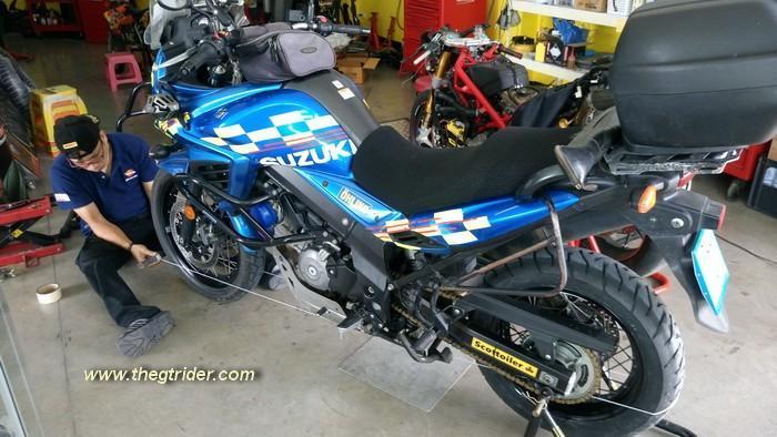

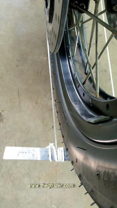

On the kind advice of Ohlins Bangkok I had the VStrom back to CMS today for a check up
Paul at Ohlins Bkk suggested that the wheel alignment be checked first.
I wasn'e expecting anything wrong there, but loh & behold
we are out of alighnment.
The bike has never been in a crash & I've never dropped it........well accept for that 1st gear 10kph slide on the snot coming out of the long necks new year in Mae Hong Son in April.
Mae Hong Son - Kayan - Long Neck Year
Unbelievable. The bike slid out, I could not hold it, so stepped off & let it drop down gently.
The paint wasnt even scratched it was so gentle.
But now I recall when I rode it back to Chiang Mai it didnt handle as well in the corners & you had to work at it a bit more. I was only in Chiang Mai for a couple of days, then went to Australia for a couple of weeks. Forgot about it, came back & just carried on, but yes I thought the suspension had gone off a bit. Two check ups later at CMS the shock was gone & sent off to Ohlins Bangkok for a rebuild.
The wise guys at Ohlins immediately picked up that something must be wrong & gave me the tip off with a private phone call = top service. Thanks guys.
So now for a little gentle straightening. Tuesday we should all be back to normal - stay tuned.

Some progress today

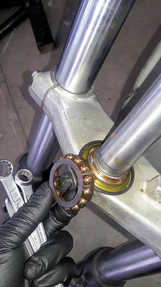

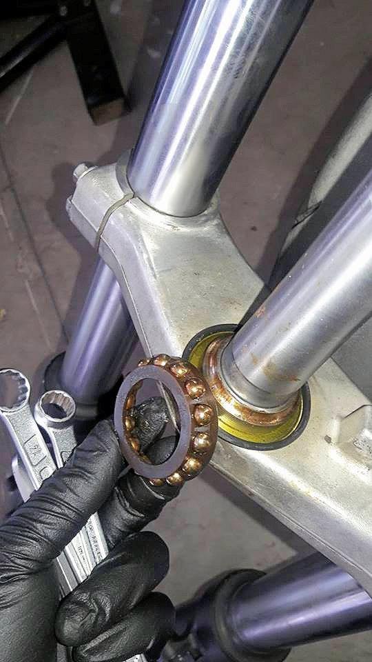

Back on the road.
Extremely happy with the professional service from Ohlins & CMS Motorsport.
A free shock rebuild under warranty - you get a 2 year warranty buying an Ohlins shock, so Ive got another year to go.
The bent fork & lower triple clamp have been straightened.
The bearings, linkage, & swinging arm were all checked, & greased.
We are all nice & straight & good to go
After my poor experience with Sahapanich Suzuki Chiang Mai, & Suzuki Bangkok it was an absolute pleasure & joy to resolve a warranty issue with Ohlins Bangkok via CMS.
The service was absolutely top notch
1. A polite phone call from Bangkok to explain what the issue was - they cared about their customer & their product
2. Followup messages to keep me informed
3. Finally an email confirming completion of the job & the delivery date.
And the fee from Ohlins zero baht - a warranty claim. We will fix it sir!
The cost from CMS for the bike straightening was negligble too
2,500 baht for the fork & lower triple clamp
1,000 baht for the in-shop checking of the linkage, swinging arm & bearings.
Total bill 3,500 baht = an absolute bargain & good happy service.
CMS are an absolute pleasure to give your business to - you get genuine honest TLC for your bike!
Now a comment on suspension & buying an after market shock.
As I've said before I've had many shocks - Wilbers, Technoflex, YSS, Nitron, Hyperpro between my Africa Twin (340,000 kms) & Versys (100,000 kms)
They were all good, but needed rebuilds frequently because of my riding.
It wasn't a problem, some of them were warranty claims - free, BUT they had to be sent overseas to be serviced. Grrh.
In Europe for the Wilbers & Technoflex. In Malaysia for the Nitron.
YSS i had a bad experience with a rebuild, but I understand now that their products are back up to scratch again, however their customer care & communication skills are disappointing.
So that leaves Ohlins Asia = Ohlins Bangkok & boy do they deliver on service & customer care. You can't go wrong!. So guys buy local & get top notch support & service from your local dealer.
I reckon that most of the big bikes sold here are set up for 60-70 kg Asian riders & the springs don't last long if you do a lot of demanding riding. You're going to need a new rear shock after 25 -30,000 kms.
CMS & Ohlins are the way to go.
Back on the road.
After my poor experience with Sahapanich Suzuki Chiang Mai, & Suzuki Bangkok it was an absolute pleasure & join to resolve a warranty issue with Ohlins Bangkok via CMS.
