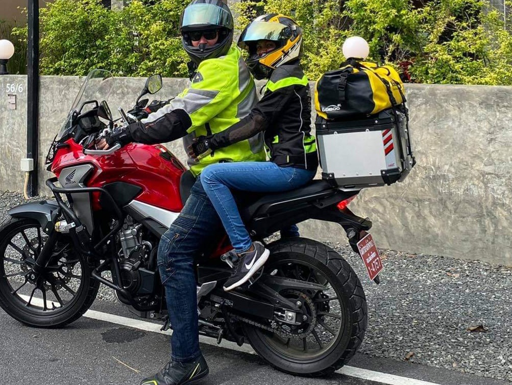

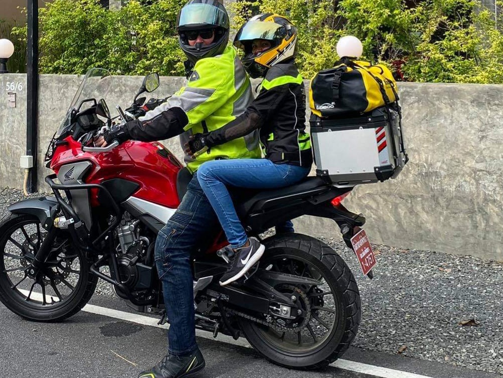

Hello everybody, I have a cb500x 2020 model. We mainly tour on road and with very little off road action. My question concerns the need to upgrade my stock suspension to something more accommodating to our weight. Currently with two passenger, and top box empty we are at 143 kg. Looking to add two side boxes, with rack will bring us to 158 kg empty. With luggage total weight 175 kg. According to Honda manual this is max carry weight. Some shops say I should upgrade suspension, but I can't get a clear answer to which model. YSS or Ohlin? Any input or experience with 3 boxes and passenger and suspension would be appreciated.
